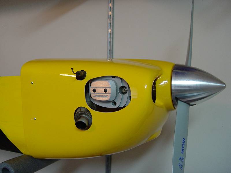

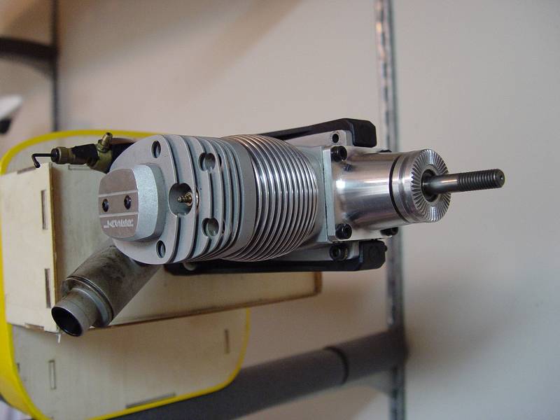

Getting the engine mount set up was relatively painless. But instead of locking the cowl down, I just taped it securely. The fit was good; I'll fine tune it after I get the necessary holes cut in the cowl.

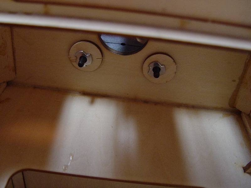

I'll be putting a bit of additional wood where the blind nuts go...

What engine are you showing there Steve?.

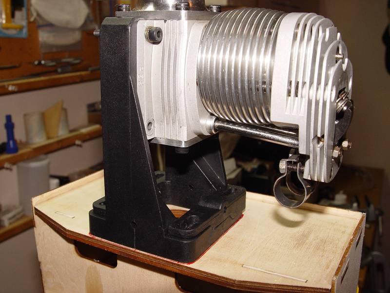

Laser 150.
I had to "strip" it (remove carburetor, muffler, rocker arm cover) so it would fit under the cowl.

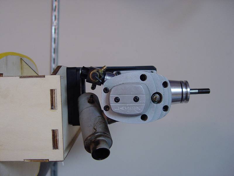

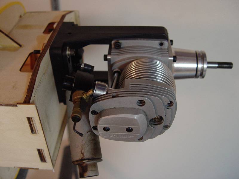

Some more progress today. Getting the engine/cowl right is probably one of the most time-consuming assembly steps...
Here's the Laser 150 in place, with all pieces/parts accounted for. This engine presents a few challenges, due to the weird location of the carburetor and the 'unconventional' muffler lay-out.

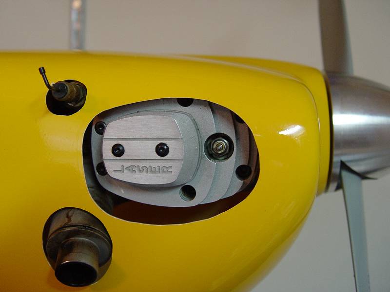

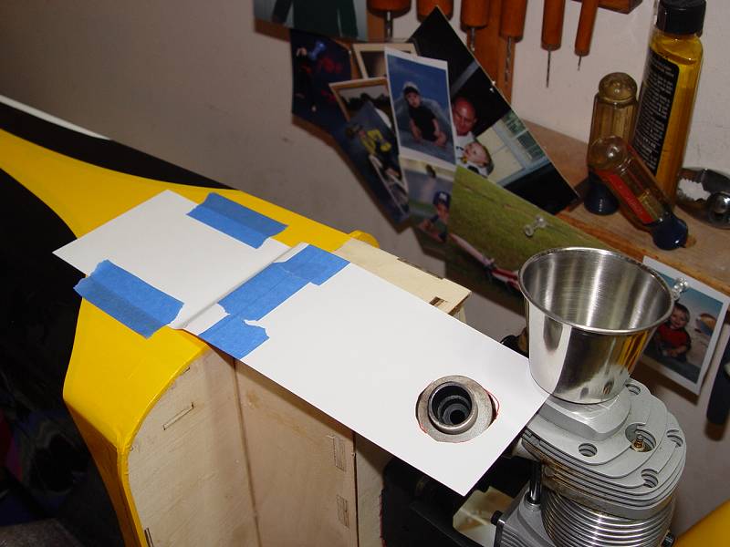

Laying out the templates for the muffle and needle valve access holes; notice in the last photo how the cardboard templtes are "raised" a bit, via folds; otherwise, they will not lay flat on the cowl and give an incorrect indication of where to cut.

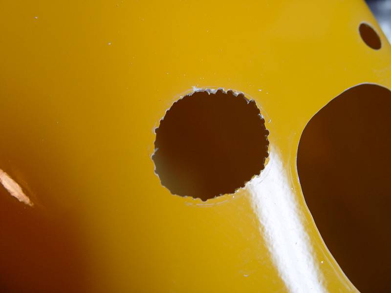

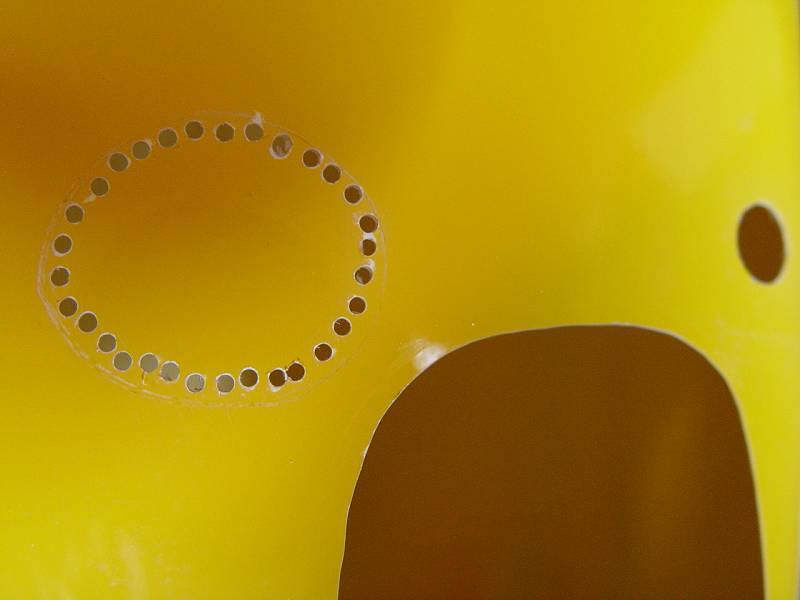

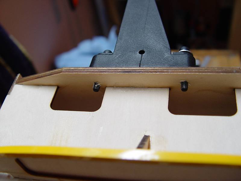

An easy way to produce a hole; drill 1/61th holes all around the inner side of the markings; use a sharp #11 blade to 'connect the dots'; and finish up with a sanding drum on the Dremel.
Don't forget the CA hinges, heavily CA-ed in place backing up the screw holes. This will keep the fiber glass from getting weak and cracking around the screw holes.

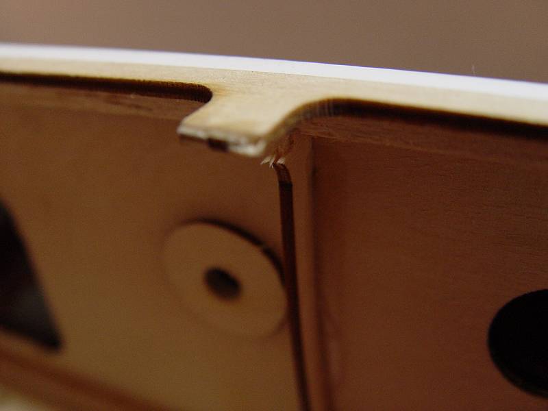

Be very careful when handling; the first picture shows what happens when you make a reflexive grab with weight (the engine) on the airframe... the cross former broke clean. No complaints; the fuse was slipping off the cradle due to my putzing around, and I grabbed what was handy
I spliced the repair job, so it should hold. But be careful; this model is built quite lightly.

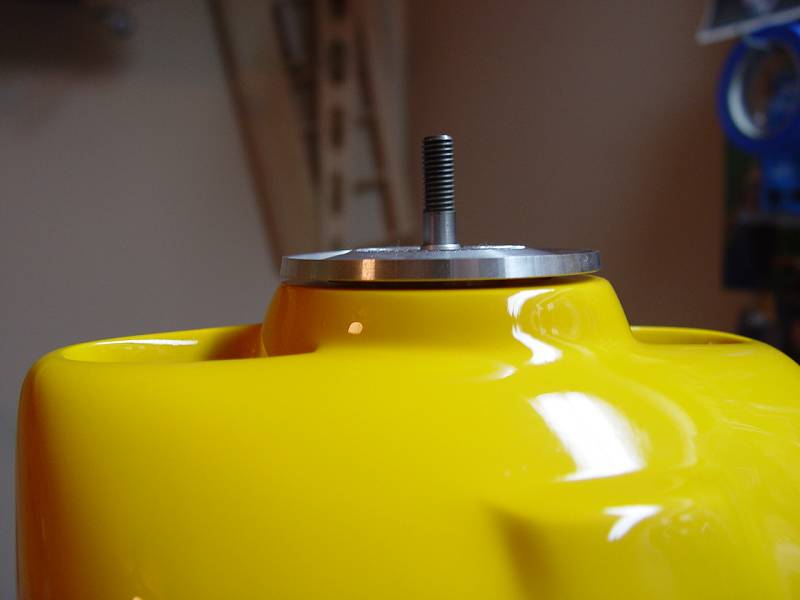

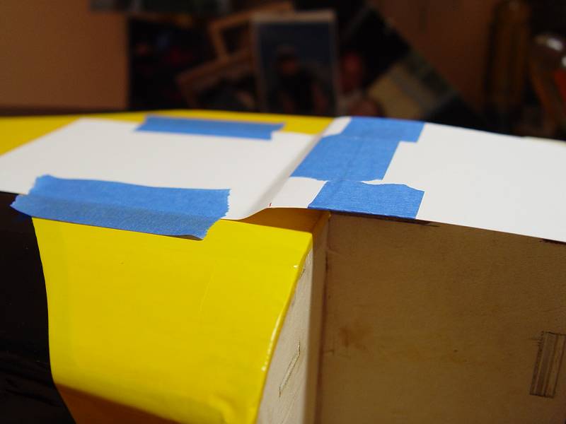

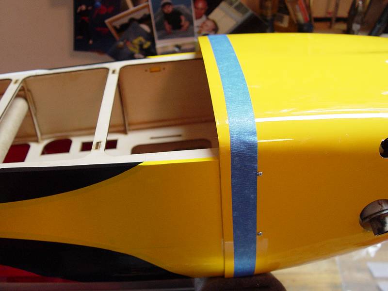

Tom mentions that there should be about a quarter-inch overlap of the cowl over the first former. I have 20mm (almost an inch) at the widest poit; the tape shows the "cut line" where I'll have to grind down the back edge of the cowl.
Pay attention to this; it affects how the canopy deck fits.

ORIGINAL: Steve Campbell
I would have thought that putting the canopy deck on and then fitting the cowl and then the engine would work out better and that would eliminate the need to cut the cowl. Maybe I'm wrong, I haven't got mine yet but it should be about the same as the bigger bunnies. The engine box looks a little short. Can you post a dimension of the height of the engine box?

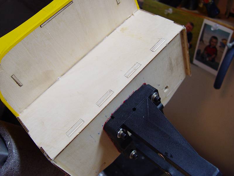

Here ya go, Zippi.
As you can see, lots of interlocking pieces/parts here. Two good chunks of tri-stock on the inside. I added the extra ply "backers" for the blind nuts, and one small piece of tri-stock up top, but everything else is as it comes out of the box The motor box is actually the fuselage front itself; it is NOT a separate piece/part like on some of the larger planes.
No worries here, I think...

Thanks for the pics. From your pics the engine box looks really short so now I'm a little worried about the width and height of the stand-offs for the Brillelli 26cc fitting and having room for the washers and nuts on the back side.

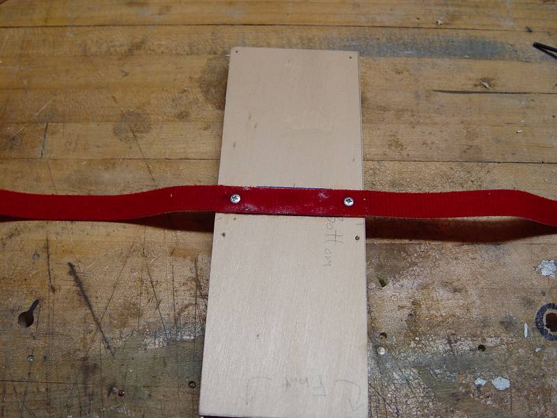

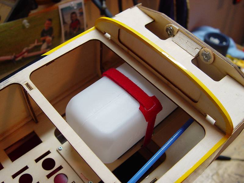

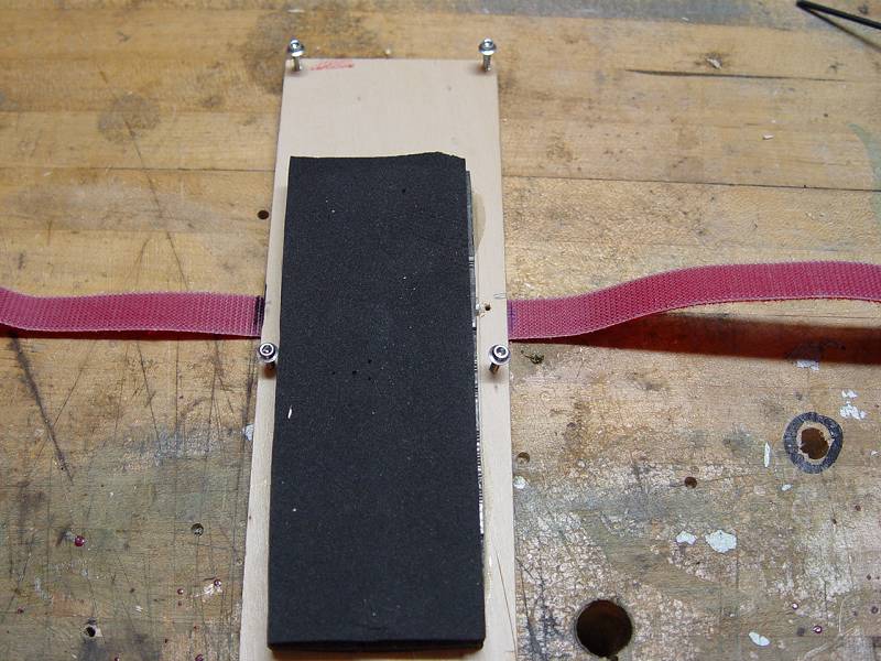

Had a few spare minutes this evening while everyone else went out for some last-minute shopping.
You have to make your own arrangements to mount the internal stuff; another indicator that these models are not for the rank beginner.
Due to the Laser's carb location, I need to get the tank as high up in the fuselage as I can. Here's the solution; a simple ply tank floor, to bridge the space in the existing ply sub-structure, with sufficient hard foam padding epoxied in place to give the required height.
The floor is screwed into place with servo screws for easy removal. A velcro tie-down strap is screwed and epoxied in place on the bottom.

Here it is installed in the airframe; and with the not-yet-plumbed tank in place.
Next: the throttle servo/throttle linkage. You can see the blue Sullivan outer flexible pushrod housing already installed alongside the tank. The location was determined back when the engine was mounted.
It is MUCH easier to get all of this front end work out of the way before doing anything else.
