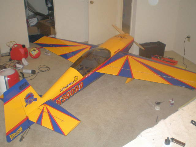

Old 02-18-2008 | 10:14 PM
  #55
Grotesquebass's Avatar
My Feedback: (16)
Joined: Sep 2004
Posts: 653
From: Suffolk, VA
Default RE: 35% Extra Build
Last one for tonite

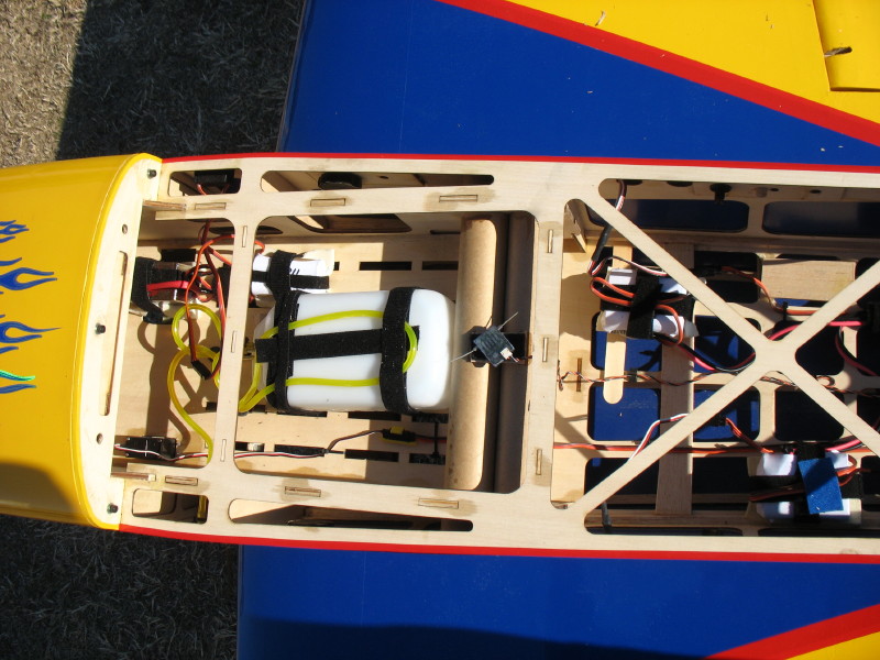

Old 02-19-2008 | 08:37 PM
  #61
Panzlflyer's Avatar
My Feedback: (15)
Posts: 1,960
From: Goldsboro, NC
Mine balances with the 2 A123 flight packs about 2 cutouts aft of the tube in the 1st "bay" behind that is the reciever and behind that the 2 rudder servos.
Ignition was mounted behind motor box and 1 A123 next to the tank.
I have a CF spinner so you would need to allow for that.
The flight packs are easily moved forward or back, Ist flight I put them a little forward and then after that moved them back 3" once I knew how it flew/landed so Im on the aft of the tube now.
Ignition pack is now back against the tube since I took these
You can see 1st flight reciever pack site in one photo, and the one with them even is the current place.

yeah from the amount of space in the bird and wire length even with an extra few ounces with an aluminum spinner i dont think balance is going to be hard to achieve at all specially with that lightened back plate(went with a tru turn)MPI was not cutting it for me . Not much done here tonite just mounted my rudder servos.
