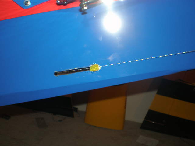

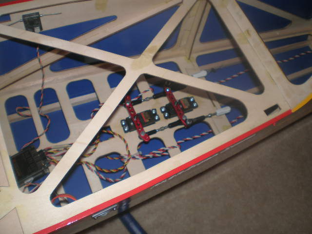

Panzl or anyone else,
Can you post a pic of your rudder control horn setup i cant get the wires to clear the rear of the holes without rubbing did u angle the horns outward for them to clear? if anyone can help me here i am stumped...
Old 02-20-2008 | 08:38 PM
  #85
Panzlflyer's Avatar
My Feedback: (15)
Posts: 1,960
From: Goldsboro, NC
Default RE: 35% Extra Build
I lengthened the cutout a bit more, still touches at full throw but so far its okay, I used coated fishing wire so no cutting.

yes after about an hour of scratching my head with a few cigarettes in between and cursing the plane for a coward lol j/k the light bulb came on i lengthened the hole and used some tygon and silicone as a buffer lemme know what u think.At first i didnt think 3" arms were cutting it but after a little engineering they work great.Please excuse the mess but i am sure u guys can relate on another note i gotta say i am not used to this big of a plane having only one tiny switch for the reciever this ar9100 sure is something also got my data logger in the mail today nifty little gadget if u ask me

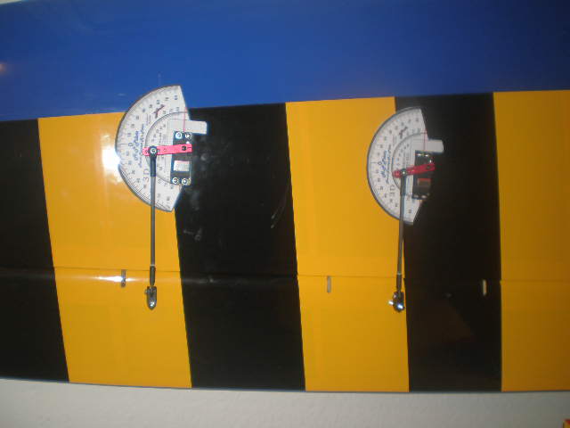

got done setting up the geometry on the wings tonite and also got em programmed its nice not having the buzz hehe got these protractors from hp pilots and they proved to be very handy in getting everything set up

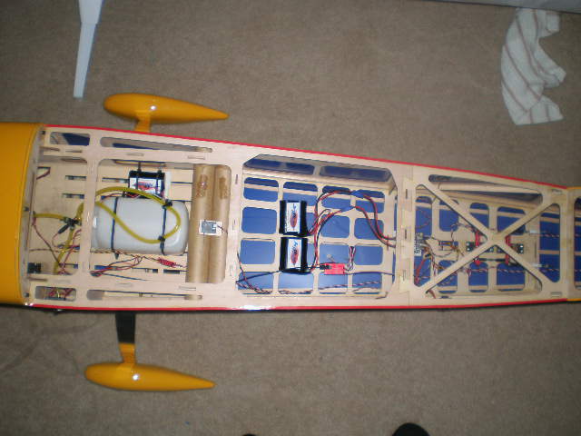

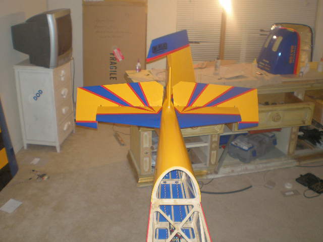

Got around to getting a pic of the inside still waiting on spinner so i havent final balanced it but was darn close to the middle of the wing tube i think the batteries are going just a little further back got a shot of my crew chief to

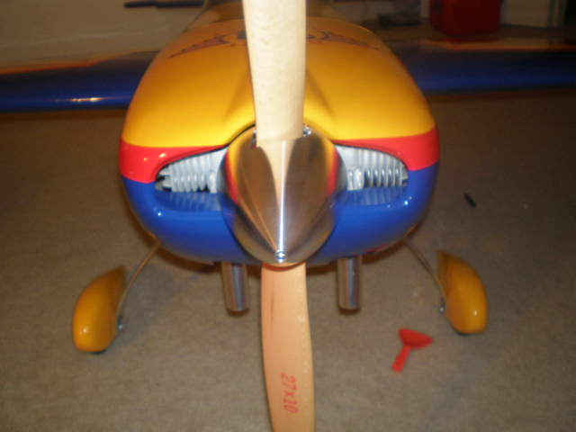

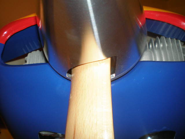

Shes done !!!!!!!!!!!!!!balanced programmed shined up for the maiden got a few pics of some various things just the spinner and baffles since the plane still looks the same hehe also Train your kids right they are happy to do the stuff you dont wanna do after a long day talked to a local imac/3d giant scale flyer in the area and we should have a maiden saturday or sunday
