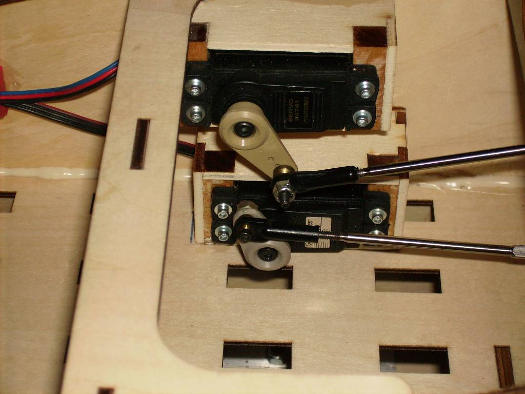

Tom,
Could you throw some pics on how you installed your servos in the fuse? I'm going with basically the same setup as you, and I would love to see how you did it.
Thanks!
edit: particularly the throttle/choke
Thanks!

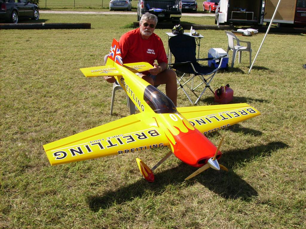

Wildhare MX2
Nigel Lamb Scheme #10 Breitling Red Bull Air Racer
Power 3W-50I on Supersonic wrap around muffler
23-8 Bunny to 22-10 Mejzlick to 22x10 Menz three blades
Servos - 94780M Digital Aritronics on ail and ele
8711 on rudder
Smart Fly Pwr Expander Pro
Dual A123 2500 Mah Batts
Guidance Aitronics SD-10G and FHSS3 10channel Rec 2.4 Ghz
1600 Mah ign batt
THANK YOU TOM AND PATTY FOR SUCH A GREAT FLYING PLANE !
all up weight 18lbs
jds

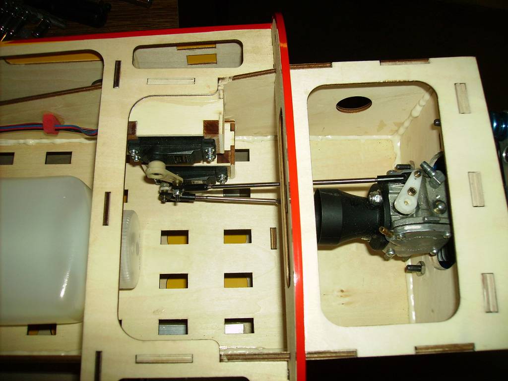

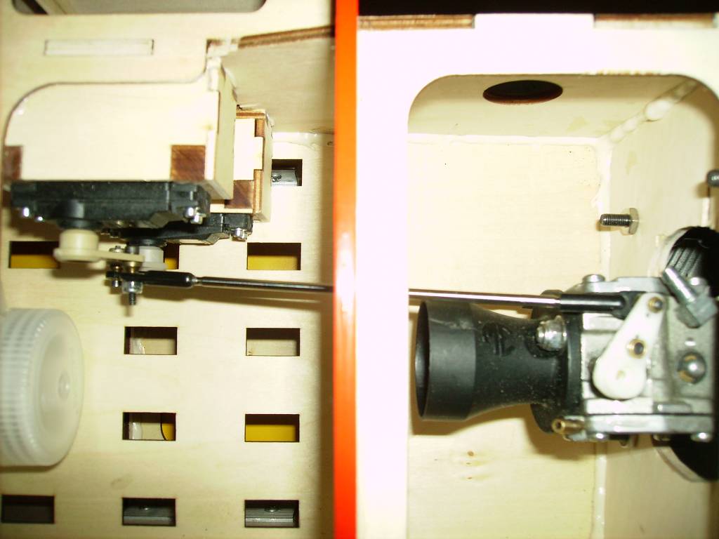

Join Date: Jun 2002
Location: Carrollton,
TX
Posts: 819
RE: MX2
Pwrdrill
I know Tom does this different with the DLE 55, he uses the CNC plywood throttle/choke tray he includes as an add on accessory.
Here is how I did mine on the 3W 50I with servo boxes.
JDS
