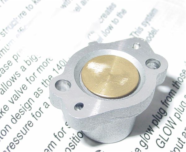

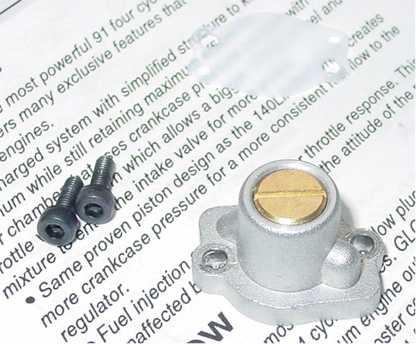

Dave, the engine is new. Opened it and found nothing that should not be there, as expected.
Can you tell me how the sealing works?
Noticed that turning the screw in increases the spring tension.

As we have discussed here many times before, the regulator controls the transition between idle and full throttle. The starting point for the regulator screw is with the top of the screw flush with the top of the regulator body.
From that point you will either lean or richen the transition by rotating the screw either clockwise to lean and vice versa.
If you are losing a large amount of fuel into the carb with the tank pressured up, the plunger is not sealing, either due to debris, damage or improper assembly.
Did you completely dis-assemble the regulator and did you re-install it on the engine correctly? the bump on the casting faces to the front of the engine.

The engine is new, and I could not find debris of the manufacturing process.
Later I found out that the screw can be turned out totally and that it can be removed.
A spring and a plunger and a silicon small thing was in. There was no debris there too.
I did find a comment in this group that with the given symptoms the regulator is turned a 180 degrees, so I tried with the bump backwards.
Now the leaking stops, but engine only fires a few revolutins each time. I assume no fuel enters the engine at all. This was obviously not the solution.
