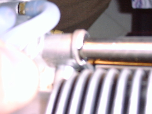

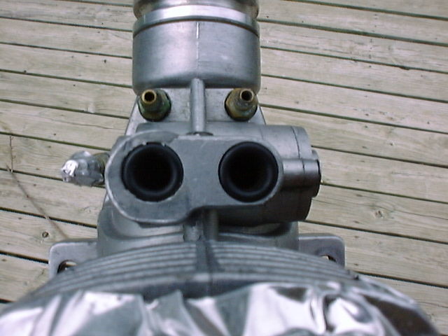

I know im not the only person in the world that has found this problem. I recieved a YS 140FZ motor and one of the pushtube sockets on the crankcase where the tushtube o-ring goes has a small chunk chiped out of the casting, so the o-ring wont stay in place or hold tube correctly. My question short of a new case I would like any advise as to how t fix it .

Hi Big Mo,
The simplest and easiest thing to do is to replace the housing, I dare say some one in the U.S would have a good s/hand unit they could sell you, I think I may even have one but the shipping from Australia would kill it.
You could try building it up with JB Weld (epoxy) don't know how long it will last for, or even alum welding, but unless you know someone who can do it, don't waste your time, replace it.
Unless some other viewer has a better way to fix it.
It's crucial for the running of the engine that the O ring seals, if it's not sealing it's a waste of time trying to run the engine.

Hi will and thanks for the reply. I'm trying the jb weld idea. and even fabricated a aluminum band to go around the o-ring area on that side, built it up a little bit bigger and then glued the aluminum strap around the first jb patch, going to dress it down this afternoon and see how it looks. IF it doesn't crack out I actually think a very thin layer of black silicone or urethane sealant on that o-ring and i just might have it whipped. ill post pics later.

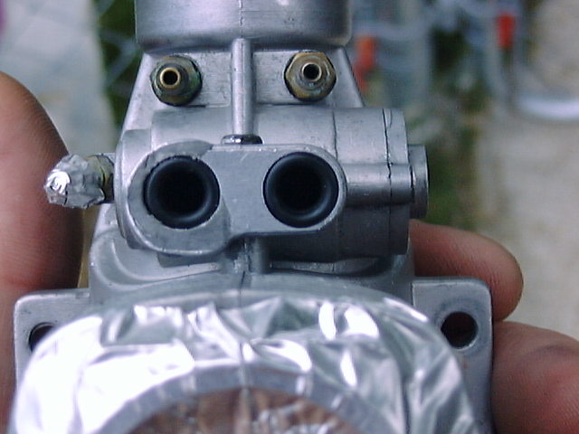

Ok Guys here is my repair , I haven't painted the jb yet and its not totally Cured to do the finish work but ii think it is going to work.
After getting the correct size filler 0.350t tubing I coated it with silicone mold release spray. let it dry got the tube plumb and square with the other pushtube locked it in place with the head. took some aluminum duct tape to make a cup for a larger fillet to have extra strength,.
let is setup over night. 6 hours.
removed the tape and tubing, filled to little imperfection i had inside the cavity where the original chip was missing from, added a .90t aluminum strap half way around the pushtube standoff, glued it on with more jb weld let it setup for 6 hours. did a Little rough trimming to get what you see here, after it cures tonight and tomorrow i will final finish t Had drop a little aluminum paint on it just to camouflage it.
The O-ring fit nice and tight and are as perfectly round as i could get it with my end mills.

Looks good, may just work, depends on heat and expansion as to how long it will last, who knows, nothing ventured nothing gained.
