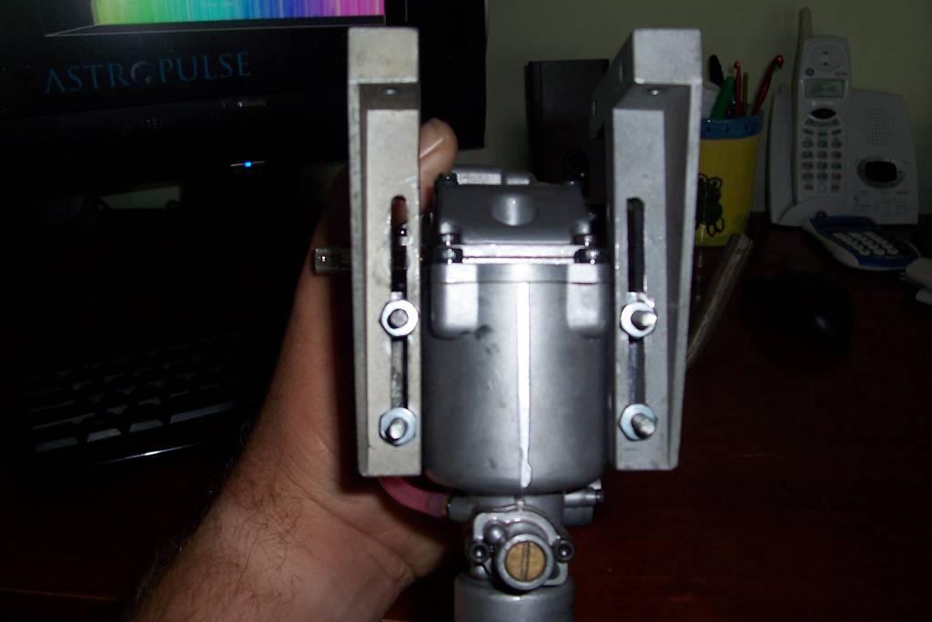

Old 08-10-2009 | 01:36 PM
Joined: Aug 2003
Posts: 831
From: Seymour, IN,
Default RE: YS 1.20AC Tuning Help Needed
Here is my Hanger 9 mounts. After looking over Horizon's website I've found them.....http://www.horizonhobby.com/Products...ProdID=HAN2033
ID:	1253821   Click image for larger version
