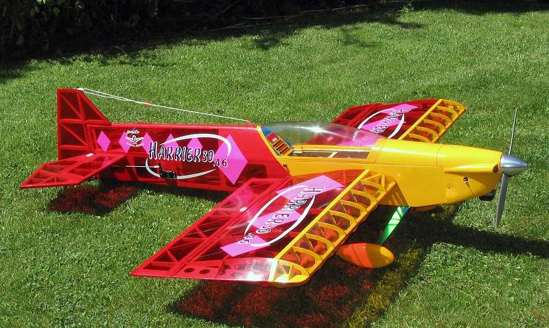

#28
Join Date: Oct 2004
Location: Boring Essex, UNITED KINGDOM
Posts: 37
RE: Harrier 46 all right!
Having problems with orientation i've put some pink diamonds on top surfaces and may smoke canopy as well. Am i the only one that can't see the thing ?
[img][/img]
[img][/img]
#29
Join Date: Dec 2002
Location: Gloucester,
VA
Posts: 999
If you can't see it, you are flying way too far away, and probably too high. But seriously, I put big wide stripes on the bottoms of the wings just for orientation purposes at a distance. I generally keep the plane right in front of me, less than 200 feet away, so seeing it is not a problem. Everyone I know with a Harrier has done something to the bottom to help make it more visible.
