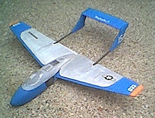

Default RE: Air Hogs Aero Ace!
ORIGINAL: googledperson
i finally finished my P-38 looks sweet still needs some tweaking on the center of gravity tho... Also any tips a=on the best place to put the motors i forgot they were pushers when i was making it So right now i have them imbetween the to fusalages and on either side of the "cockpit"
You can switch props and pull it. Two tail booms and two rudders, especially
if the boom's are elongated, are going to add tail weight. The 3 grams from
the motors should be used as balance weight.
`twin boom`

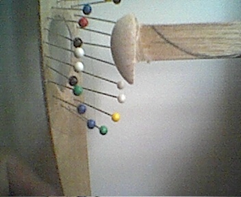

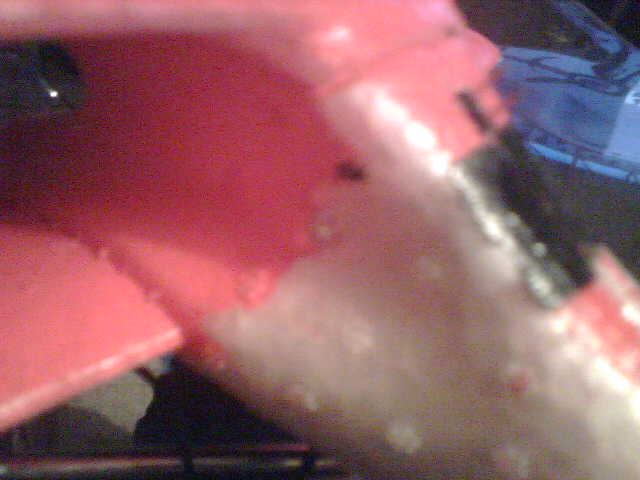

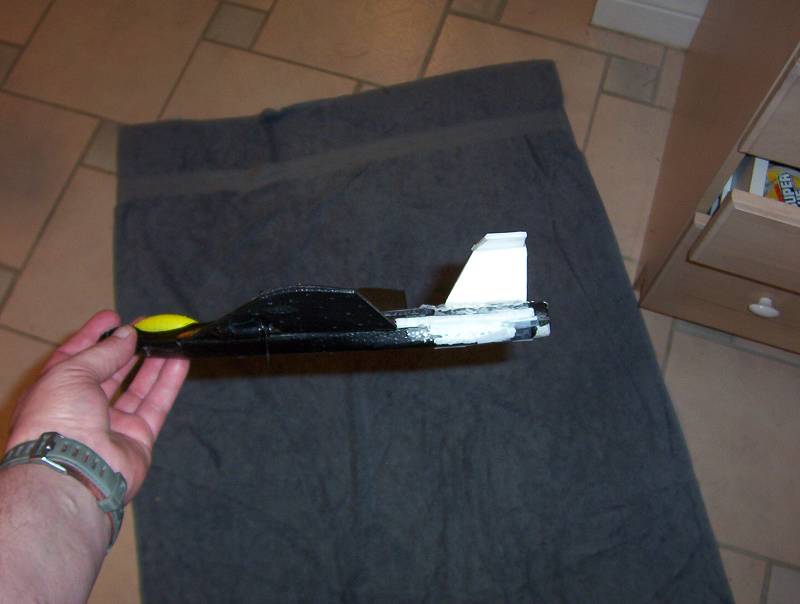

Old 11-03-2006, 11:31 PM
  #3682
FERNDALE AIR FORCE
FERNDALE AIR FORCE's Avatar
Join Date: May 2006
Location: lost coast, CA
Posts: 7,007
here are the pic's of the high stab jet. I laid a serious bead of hot glue, and had to rebalance the plane. I think I should just build a plane from stainless, then I remember the noise of my big plane impacting on the wall of the high school. And I'm terrrified, a stainless plane could cause serious injury. So I'll stuck to styro planes. I have not flown this plane under power yet. Every toss ends differently, but that could be wind. I did have to put a .5g weight under the battery to balance the plane. because it was landing tail first on the first tosses Tim

Old 11-04-2006, 12:15 AM
  #3683
FERNDALE AIR FORCE
Join Date: May 2006
Posts: 7,007
TRU online, shows many AA's. Be careful about what you try to order, they have pic's of bipes when they are selling jets. I tried to contact the persons runnining the site and got a phone number to call. I have called it before and the operators don't have a clue. Tim

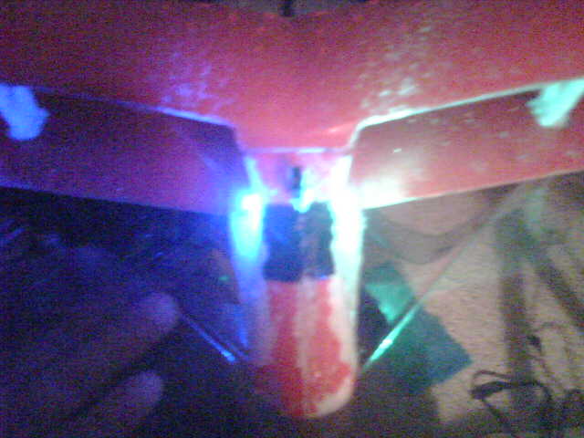

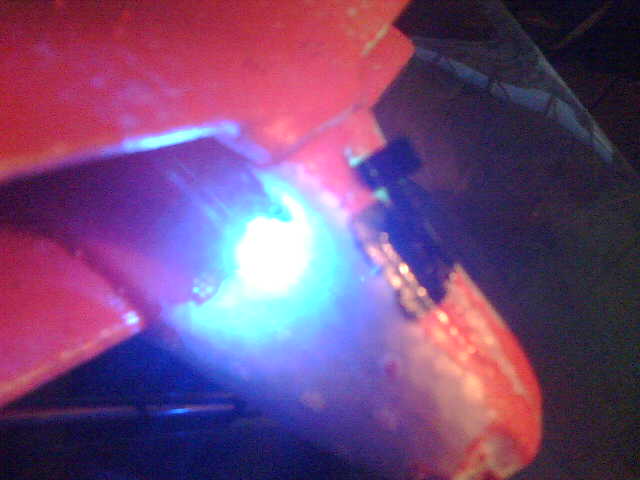

I just got my light mods from djstinger. Wow does it work great. I soldered them directly to the battery as instructed. It comes with a very tiny plastic part that completes the circuit otherwise the lights would always be on. Without the plastic part, the lights are off. With the plastic part on, the lights are on. Here are some pics. I know I never really found any close up pics of this mod. I only saw videos of people flying with the mod. I used my cell phone so the pics aren't the best quality. I installed them so the leds stick out of the fuse rather than them being on the inside of the fuse. I'm not sure how everyone else is doing it. The mod really doesn't noticeably effect flight times.
Djstinger, I sent you an email. I'm waiting for a response. Hope to hear from you soon.
ID:	554016   Click image for larger version
ID:	554017   Click image for larger version

Flying inverted!?! You've got me there. You didn't add main wing flaps did you?
The lower tail looks better, should be flying pretty good....?
That light mod from dystinger looks great!

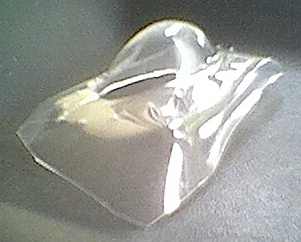

I got a chance to try out this method for making canopies. It works really
well and works best with thicker plastics like bottles. Now I have to figure
a way to glue it to foam without making a mess of it.
ID:	554104   Click image for larger version

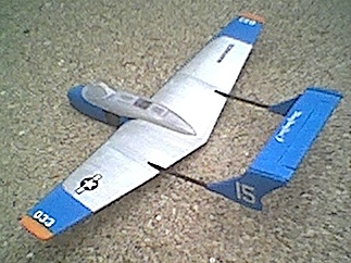

The plastic I used was from the SingleWing box, heating it over
the coil burner on my electric stove. About 2 or 3 inches from
the burner works well but too much pushing can crack the very
top of the canopy, so take it slow & easy.
The picture shows the canopy in place, but it's just sitting there
until I glue it. Installing it through the bottom is a good idea. Right
now I'm test gliding it with pretty good results but I already cracked
the nose- what did I tell you.
ID:	554269   Click image for larger version

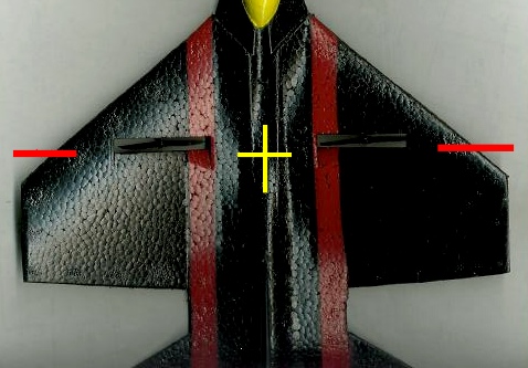

That is strange. Check the CG.
The jet in the pic flys about as good as I can get it to.
The center of gravity is shown by the yellow cross. The red bars
are where I stuck pins to find it's best balance point- the nose
should just start to drop at about a 1/2 inch at these points.

Old 11-04-2006, 11:21 PM
  #3692
FERNDALE AIR FORCE
Join Date: May 2006
Posts: 7,007
I think the issue is ballast. Either the stab is to big and is acting as a conflicting wing, which would put the plane nose down. Appearing to be nose heavy, and causing more weight to be added. I got cartwheels out of the plane today. The other option is that the plane is top heavy. Under power the stab could cause a top heavy condition, maybe pitch the stab at 5 degrees down? Tim
Old 11-05-2006, 12:48 AM
  #3693
FERNDALE AIR FORCE
Join Date: May 2006
Posts: 7,007
neuro, I think i'm top heavy. the plane wants to fly, but is getting mixed directions. It flies out and then comes back at me inverted. I'm thinking of cutting the stab shorter. Maybe oe of you lurkers has the answer.
Tim
