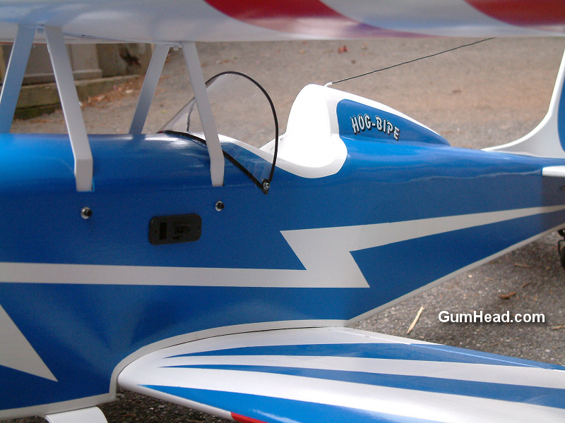

RE: Sig Hog Bipe Build
ORIGINAL: Joe Ortiz
Gumhead, nice Hog, is that a fuel filter in the last picture?, if so, where did you get it from?
Joe
Joe
http://www.horizonhobby.com/Products...rodID=SAI50109

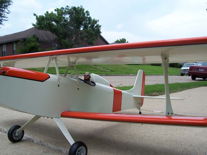

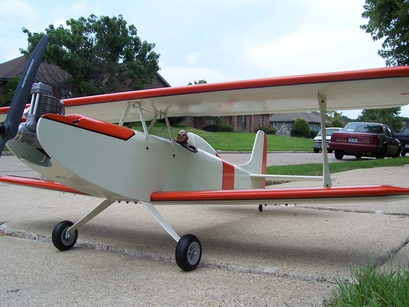

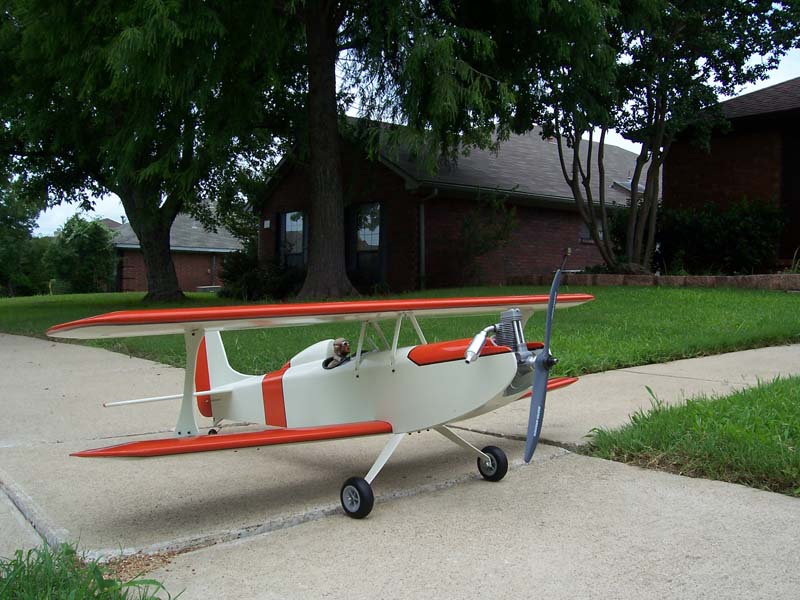

Well my Hog Bipe is getting closer to completion.
I decided to keep the color scheme pretty simple on this one.
I still need to add the pin stripe on the leading edge of the wings.
The landing gear and the cabanes still need to be painted too.
Maybe someday it will actually be finished :-)
#537
Join Date: Dec 2001
Location: Rowlett,
TX
Posts: 1,309
ORIGINAL: Dauntae
That looks so cool, You should put it on floats and call it a coast guard bipe. Simple yet looks great.
Dauntae
Dauntae
I did not realize why this scheme looked somewhat familar to me, but you are right is does sorta look like a Coast Guard color scheme.
As far as the floats go, it sounds like a good idea on paper, but introducing another moving element into my landings would not be the the best interest of the airplane :-)

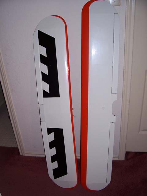

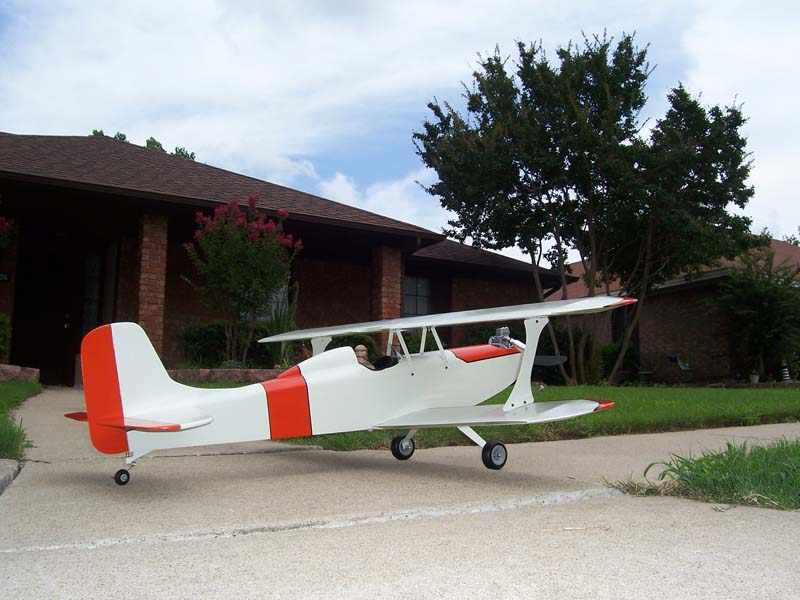

#543
Join Date: Dec 2001
Location: Rowlett,
TX
Posts: 1,309

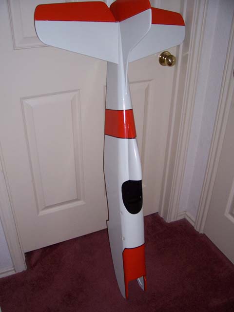

Finally bolted mine together for the first time with the paint applied.
There are a couple of finishing touches to be added like painting the wheels and putting a frame around the windshield but you can see how it is going to look.
I still have to install the control horns but everything else is ready to go.

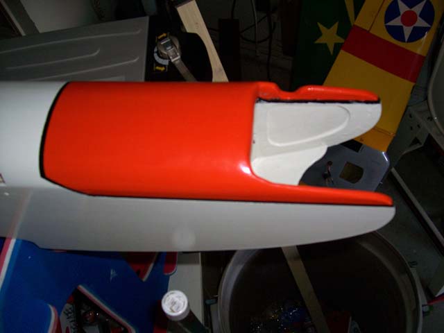

#545
Join Date: May 2005
Location: burbs of Boston,
MA
Posts: 397
ORIGINAL: rkliemann
Looking at your pics of the engine area, it looks like you just painted that area?
