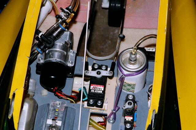

I have a problem that is starting to consistantly rear it's ugly head, and one of the guys I fly with suggested I describe what's happening and see if anyone comes up with any ideas we haven't thought of yet.
I have a Bandit ARF with an Artes Falcon. The turbine has around 2 1/2 hours run time and starts and runs great - except for when I do the following:
Roll inverted downwind - push round the turn to the upwind leg - on the upwind leg it will flameout.
This happened 3 times in a row - first time was a surprise, but all was fine.
Second time I was testing the previous scenario to see if it would happen again - and it did.
Third time I had moved the filter so it sat vertically, replaced sections of the fuel line and made sure all was as it should be. All connections had been checked. The Data Terminal just says flameout after it's happened.
The UAT is totally free from air and there are no bubbles in the lines after landing. All batteries are as they should be. The problem has not happened at a constant duration or fuel level in flight. The three flameouts have occurred over two sessions of flying. Today I flew the first flight - replicated the pattern, all was fine, then replicated again and the turbine cut.
I then flew a second flight and did not do any prolonged inverted although I pushed a bit of -G and some slow and 4 point rolls. This time everything ran great.
I'm relatively new to turbines and not the worlds biggest boffin on troubleshooting these problems yet, so any help would be appreciated.

Are you seeing any smoke when it flames out.
A very large white cloud could point to a internal fuel system problem, fuel pooling up and under the right conditions gets into the combuster, I have had that one.
A bit of smoke could be an air bubble getting in some how, most of us have seen that one.
No smoke at all normally points to the fuel stopping all together, a bad solenoid or a piece of trash that moves into the right spot under the right conditions.

I think I have your answer. I've had the same problem on both my Artes Falcon and Artes Bee. Both came with a gold colored in line filter. It's the same one that Hangar 9 sells. Anyway that filter will trap a lot of air, when you do a manuever that shakes a bubble loose it will flame out the engine. I'm very sensitive to this issue after my Maverick flamed out and crashed.
The best advice is to use a different filter. I switched to a Dubro filter on my Bee. I still have that filter on my Falcon. Mount it vertically where it can move freely. After priming the line with fuel take a screwdriver or your finger and keep tapping the filter until all of the air is out. Then when you are sure all of the air is out tap it about 10 more times to confirm it. You will be amazed at how many bubbles keep coming out. After all of the air is out it will work fine. Every time you open up your fuel sysyem, run out of fuel, or otherwise get any air into your system you need to go through the tapping exercise to make sure all of the air is out of the filter. The reason my Maverick crashed is because I forgot to do that.
My suggestion is to remove the in line filter for a few flights to confirm that is the problem. Then you can decide to keep tapping, switch to another brand, or run without a filter. A friend who has an Artes Eagle flies without a filter because he does not want to risk a flameout.
The other possibility is that you have air trapped in your UAT. I believe it comes with instructions on how to purge all of the air out. I took mine out of the plane and shook the crap out of it while pumping fuel through it with my fueler to purge it.

All respondents have offered up their respective solutions. The filter issue is not one I have experienced or heard of. Some key questions and perhaps we can sort this out.
1. Flame out with -0- smoke is simply, fuel starvation. . .air bubble(S) or running out of fuel.
2. Flame out with smoke trail indicates the ECU commanded the system to shut down. The "why" is what we need to know.
With every abnormal ECU action, there is an "Error" message available until you shut the system down (off) so with Data terminal plugged in, use the menu down button which is first on the left. It flashes the Error message. The path to follow to correct the error message may be found in the last few pages of the turbine manual received with your turbine. Trouble shooting. . .
It is important to know the fuel system is without fault. I diagnosed one case similar to yours where the culprit was an undersized vent line which of course restricted the balance of pressure in the system. When this happens, the fuel pump gets orders from the ECU to pump more. This increases amp draw which inturn can effect voltage. Yes, the ECU battery condition of charge is important. Back to the pump. When the PW of the pump rises, it does so as demand increases. If it gets close to its limits, ECU makes the decision to abort the run.

I will never understand why my fellow jet guys install filters in their airplanes. My fuel gets filtered going into my five gallon fueler. There is a filtered clunk in my fueler, and there is an automotive filter going from my fueler to my airplane. Once on board, there is another automotive filter inside my UAT.
From there, the only thing that can go down my lines into my turbine is pump parts, rotted fuel line parts (assuming my fuel lines will someday not last forever), or solenoid parts.
Considering how unlikely it is that one of those sources could end up in my turbine, I have never installed an onboard filter. Figuring anything remaining was small enough that ingestion in the turbine was no big deal.

try another UAT, go out and re-test. We have had a bad UAT that actually got transferred from one plane to another and brought along all the same problems. When the UAT was replaced, everything went back to normal.

Thanks for the responses guys - I'm off to the field now.
I think the best strategy is to try one thing at a time. I will take the filter out and see how that effects things and have taken the filter from my Jetcat with me to try.
I will also change the turbine battery if that doesn't work and will eventually change the UAT if all else fails. I was assuming any fault was happening downstream of the UAT but will start looking further up if the problem persists.
There has been no smoke with these flameouts - I've always had guys with me when these have happened and no one has noticed anything.

Actually, my experience is the exact opposite of what Eric says, I'm not sure why.
If you get an air bubble, it usually puts the fire out, but the ECU takes a couple of seconds to sense it via the thermocouple and so more fuel goes into the engine on the back side of the bubble - making a smoke trail...
If the ECU commands a shutdown, the fuel solenoid goes shut right away - no smoke trail...

Bob is right if it's an air bubble causing the flame out you will get a brief smoke trail. No smoke means that your pump shut off. Check all of your electrical connections and solder joints. Run it on the ground and wiggle or tug on the wires. Concentrate on the ECU battery, power wires to the ECU, pump wires, and fuel solenoid wires.

I had exactly the same symptons with my Wren 44, when I rolled inverted the motor would cut after a few seconds. Believe it or not the cause was the rpm sensor magnet had become demagnetised and in the inverted position the difference in the earths magnetic field was enough to cause a spurious rpm reading and shutdown. The fix was to remagnetise the sensor by taking a strong magnet and moving it in a certain pattern at the front of the turbine. I felt like a bit like Merlin the magician doing this but it worked and I have not had the problem since!
Of course if the Falcon does not have a magnetic sensor this is not the problem and I aplologise for wasting your time!
