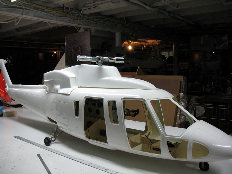

I have been posting pictures of my Scale Jet S-76 build on some of the other sites. I thought o myself, Why not post on another site for you folks who do not know or visit these other places so here goes.
Give me a little time and I will get some past pictures posted and post some current in progress photos as well.

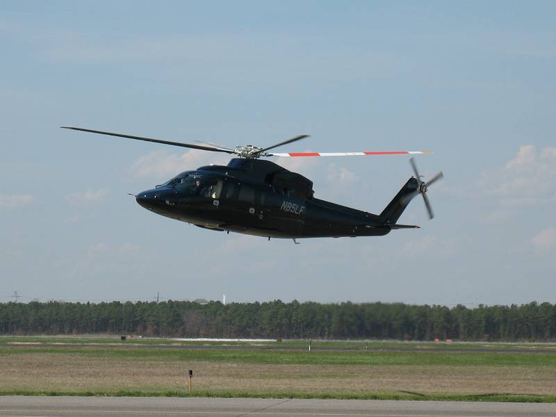

This Build will be a flying replica of the full scale helicopter I work on. I have chosen this one, well because it is my baby, plus I now where to get all the documentation I will ever need.
here are a few "tease" shots of the full scale.

Thanks Butch! I'll post some shots of mine when it gets here. Can't wait to see that cockpit.
Guys, his model (like mine) will be a 7-foot long ELECTRIC with an 8hp motor that runs on 12S 6P 10,000 mAh lipos!!

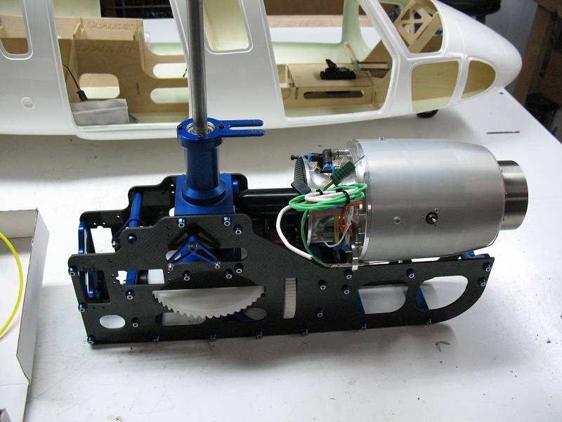

This build started" out as a Turbine. A Jaka with SD top mount mechanics. Rumor has it an e-power system was in the works. "OH SNAP" I was all over that. Sold the "T" bought the "E". "YOUR A GUINESS GUMP". This simplified the build 4 fold. No heat or exhaust to deal with, more power, less weight even with the nuke power supply, no JP5 and propane, and all those fuel tubes and fittings, "Fittings and Tubes and Fuel" OH MY. That was...
Anyways, Thats how they say it in the midwest, here we are, sitting on the Group W bench, chugging along with the build. I have attached some photos from kind of day one to present. There may be some gaps here and there after my neighbors parties. I have the coolest neighbor. His entire back yard is a frig-gin Bar. Dude, I am telling you, some establishments wish their place was as nice as his.
Happy 4th Gents,
more to follow,
Butch

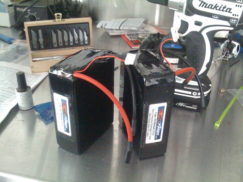

I just got the batteries yesterday and attached a crummy iPhone picture of them. Big as all getout!! I also invested $462.00 on a Class D fire extinguisher!! Some places had the same one for $700 so if you want one, I'll send you the link.
No fireworks at my house on the 4th or any other day! I also bought the hyperion dual charger that does 15amps. That sucker will charge both batts simultaneously in under an hour.

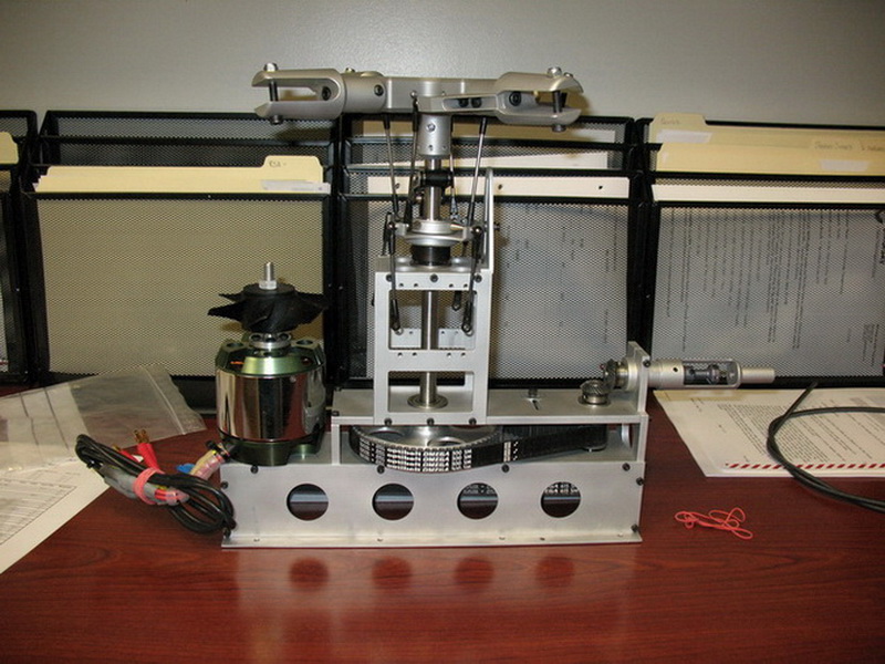

I did not have day one photos on this computer so I short changed you guys. Here are some pics of the beginning of the IP and the internal support for the stab.
Butch

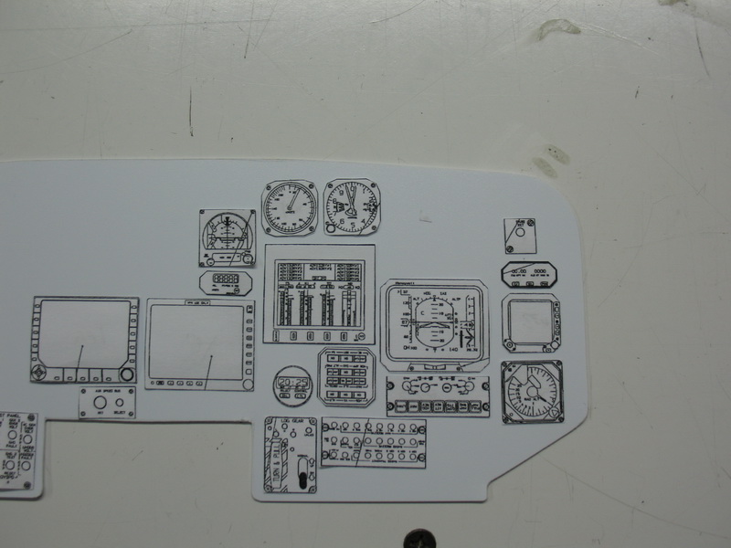

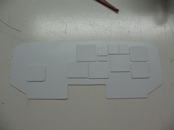

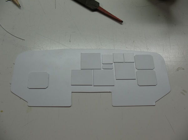

Some work on the IP.
I will chip away at this over time. I can only sit still making little parts for so long. The panel itself is about 225mm so its really not that small. This part of building the panel is the easy part. Installing all the little lights, knobs, and switches is when I worry about the men in their clean white suits.
Butch

I will make a mold of the IP, center console, and CB panel. I have yet to work out all the details for the displays, but I have a pretty tried and true method to use on this panel as well. The end user could finish the raw panel, do the final detail, purchase the light sheets and have a complete panel in a few evenings. You may need a little more than a fork and knife from the kitchen but doesn't everyone have a 10,000sq-ft machine shop like I have. It would be no problem for the modeler to complete the panel. Just kidding, the shop is only 9600 sq ft.

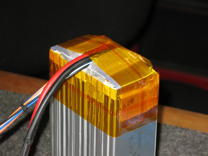

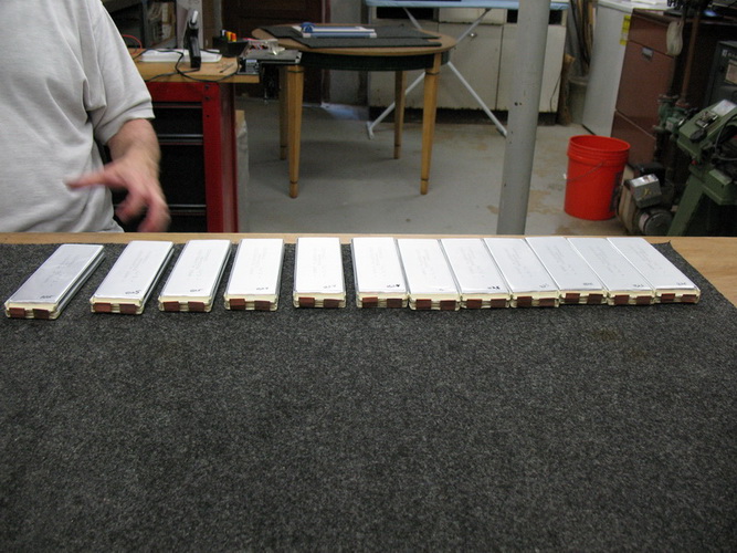

We built some bricks the other day and here are a few photos
2 each 6s 10,000mah packs
Butch

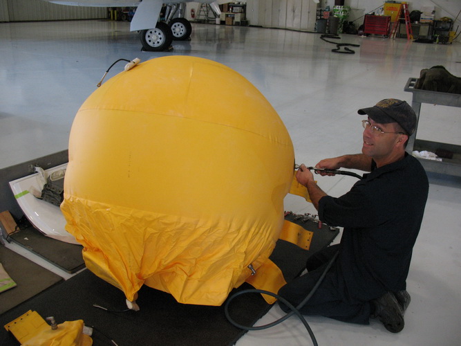

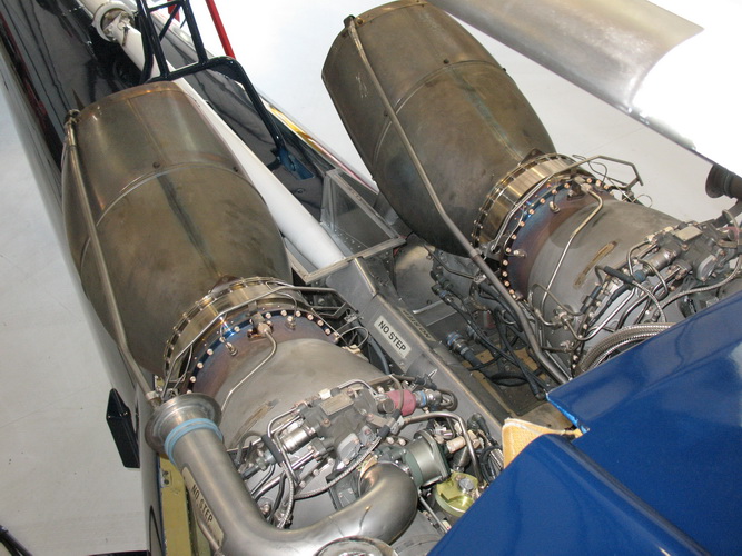

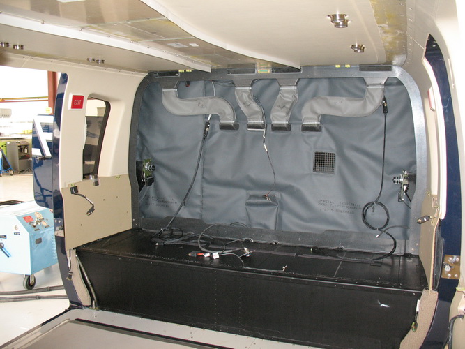

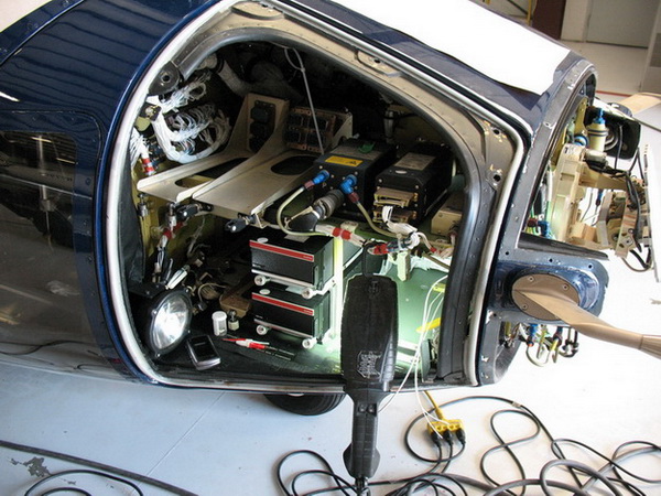

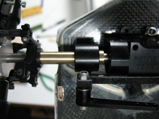

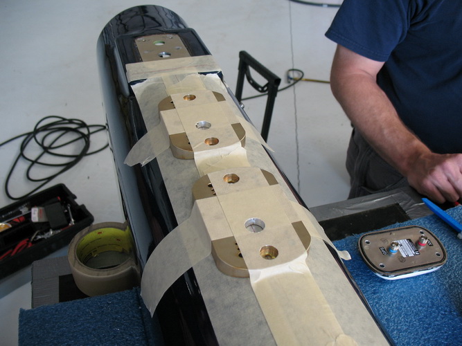

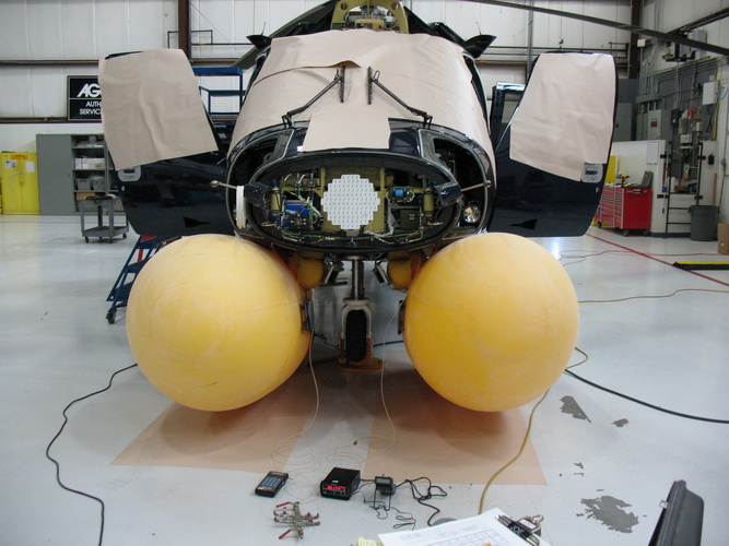

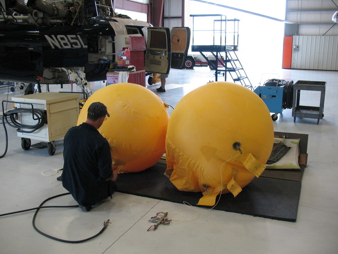

Been a slow past few weeks on my Scale jet e-76. The helicopter I am the Crew Chief of, was down for it's 12 month inspection checks. This requires me to stay with the helicopter while the maintenance is being performed. I was able to get home on the weekends but did not have time to work on the model.
Thought you guys might like to see. Here are some photos of the full scale in maintenance.
Butch
Butch

aahhhh the joys of packin floats. Worst job ever.
very clean machine you have there. you should see our crap. road hard and put away wet.

I could be missing something but I really do not recall the "joy" of packing floats. HeHe.
sounds as though you are experienced.

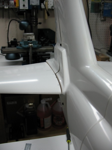

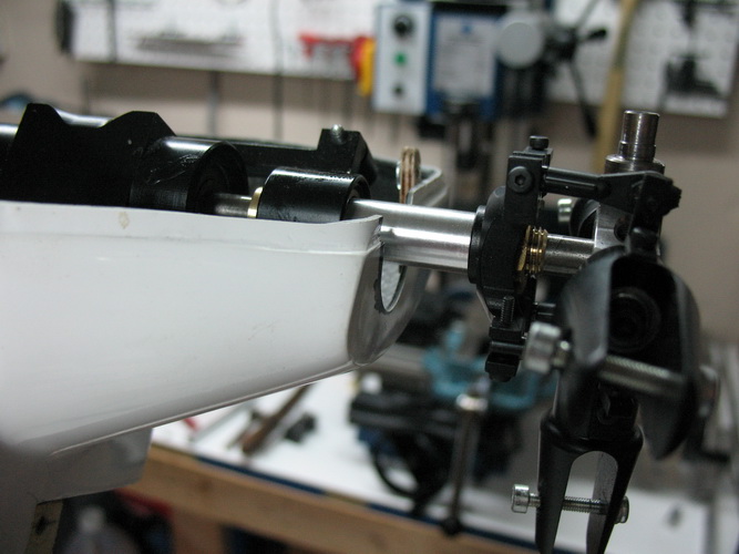

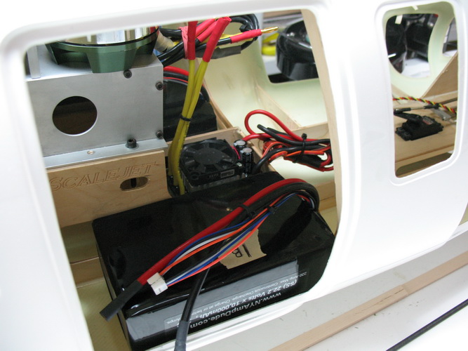

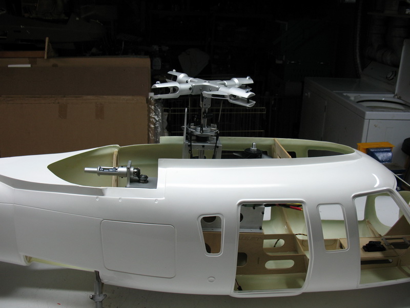

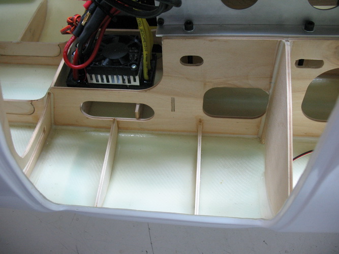

Thanks for the comments on my bird. She is still a baby. 255TT when these pics were taken. We run about 50 a month which is a good pace for corporate and only one mechanic.

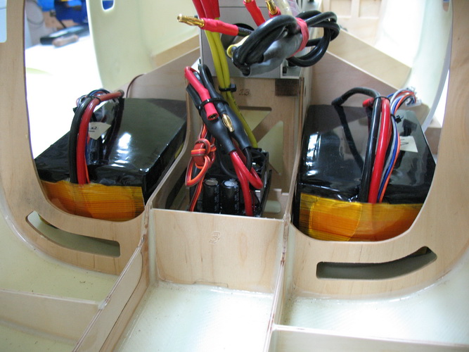

I have ESC and battery support structure installed. I still have to install the decks for the batts which I plan to use Velcro straps to hold them in place. I also ordered up the JR 1222 and a couple of 6010 regulators for that bad boy.
A couple of shots.
Butch

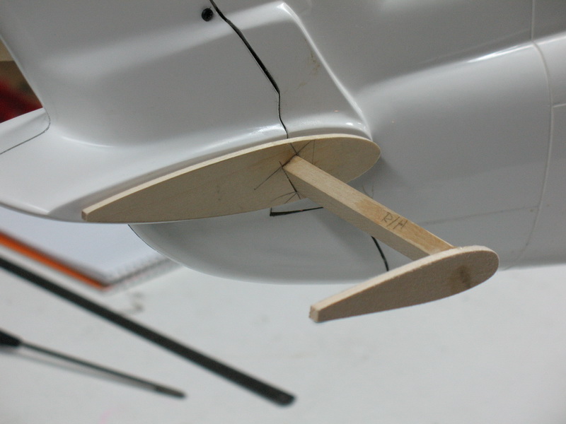

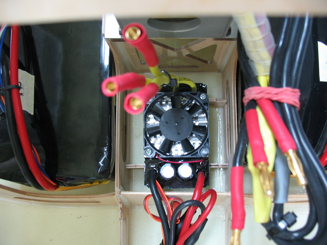

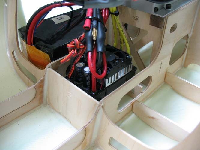

I have been home for the past week or so. Girlfriend had some surgery last Tuesday, came home Wednesday evening and I have been keeping an eye on her. She has been sleeping a lot which has given me time to, well do what heliguys do.
I have been able to tie up many loose ends as seen in the previous post with the battery and ESC installation. I made a mock-up slider and spacer for the tail. The control bell crank and slider I have is a prototype from way back. The new version is more of what you see here.

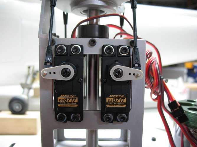

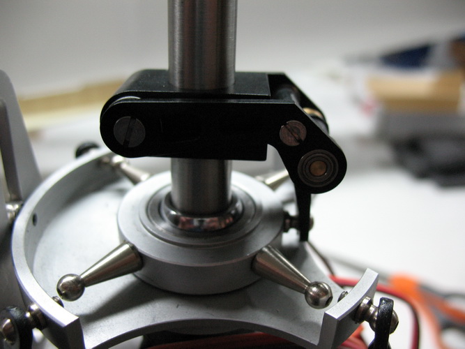

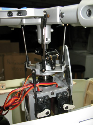

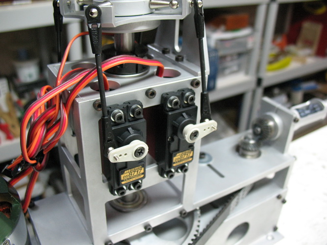

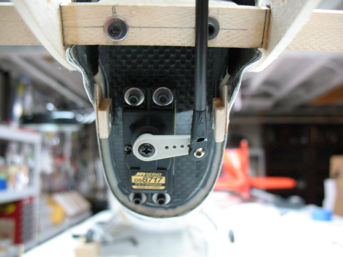

I installed some "Jewl-ery" in the form of 5, 8717. One for the tail, and 4 for the swash. I also installed the carbon tail control rod. I am not sure I like the angle of the input rods from the servos to the swash. This could be corrected buy installing a longer ball on the swash. Once everything is powered up and I get a chance to overview the geometry, we will see where we go from there.
I have a JR 1222 RX and 2, 6010 regulators on the way. I will be running 2, 7.4, not sure what mah, lipos battery's into this RX and regs. I have not purchased a gyro for the tail. I like the 401 for its simplicity. Its a good gyro for scale stuff for sure, but when I flip this upside down, doing rearward flight at mach .63 with 720 degree per second piros I am thinking it could blow out.
Here are some photos of where it is today. It is starting to look like something.
Is that a nice follower or what? Notice who make it...
Butch

Great progress, Butch. How come you are using separate receiver batteries vs. the power from the packs? Is the answer obvious? (like you don't like doing autos without surface control)?
Joined: Jul 2003
Posts: 76
From: Deer Park, NY
Michael,
That's one really good reason. I would always want to have surface control, no mater what.
I am no e-gooroo, but I kind of feel with a project of this magnitude, (nice word there, kind of reminds me of "Liquid Hot Magma") they should be separate. With 10,000mah of battery side saddled to this thing, I doubt there would ever be an issue. Not that the avionics will draw that much, but I believe it will give cleaner power to each sub system. I could be smoking crack, but its my story I can tell it my way.
These guys listen to what I say, but then again I feed them. Meet Cyrano and Roxanne. Guess which is who. I wonder if the nose gives it away.
Oh, and I cant forget Goliath. She, that's right "she" is an African Leopard Tortoise and weighs almost as much as my 76. I feed her too but she never listens.
The 1222 uses 2 each 7.6 but are completely separate internal to the micro processor. If one cell, in one battery fails, the battery becomes discharged, shorts etc, there is still redundancy with another battery. I will still have a full regulated 6v powering the control surfaces.

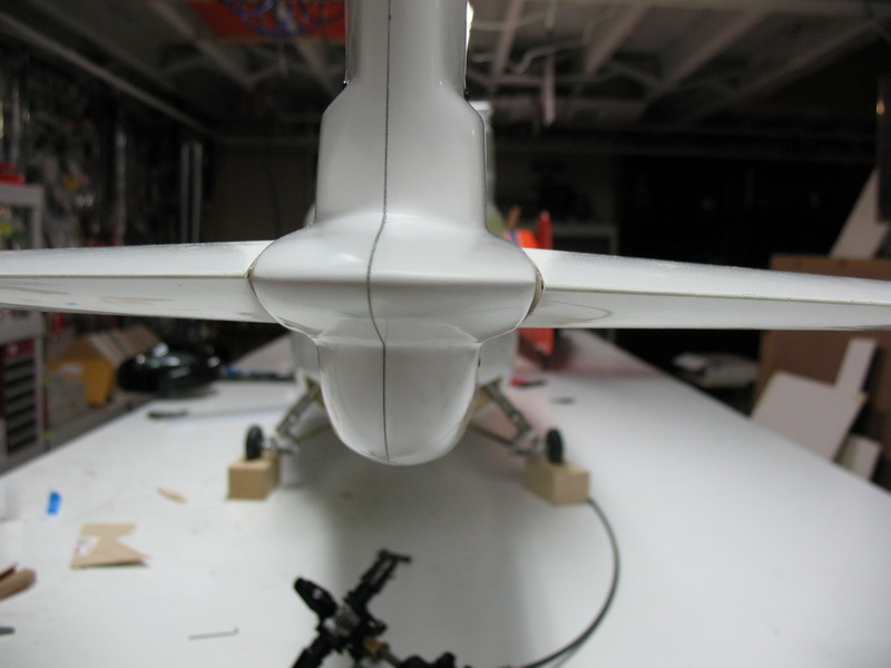

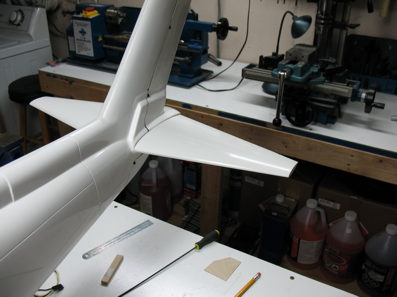

I put this thing on a scale last night. The doors, engine cowl, and race car were not installed and it weighed 29.2 lbs.
Butch

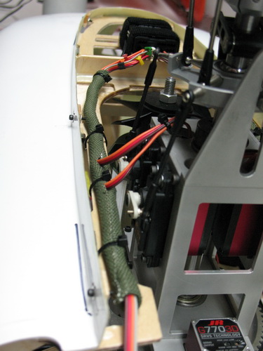

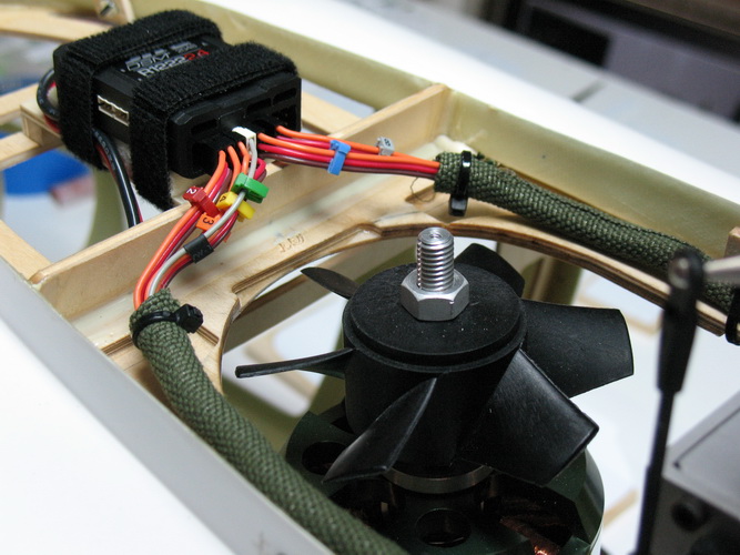

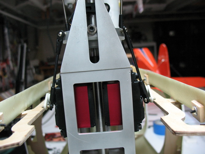

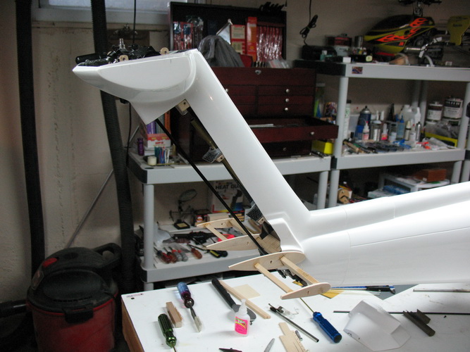

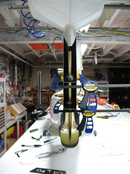

I did a little tidying up for the harness. A before and after pics. The green wrap is a Nomex cloth with a fishing line type skeleton to retain its shape. Its much nicer than spiral wrap and it looks better too. installed a RX tray as well.
I drilled all the holes and installed the Dzus fasteners in the console plug. I biffed the second to last hole. No worries. It all better now.
some pics,
Butch

Hawk079,
I am not sure which fan you are asking about, there are 4 on this heli, 1 mechanical, 3 e-Powered.
All of the fans came with each component. The small fans on the regulators come from JR. They are built into the regulator. I did not measure the power draw. They are brushless and regulate the 7.4v down to 6v for the flight controls so I would guess it is not much. The same for the ESC. It came attached to the ESC. The ESC is a Kontronik Jazz 63V
The motor fan also came with the motor. I am running the motor on 44V.. The motor fan is attached to an extentionon the motor shaft.
Butch
