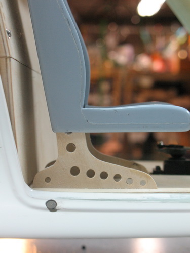

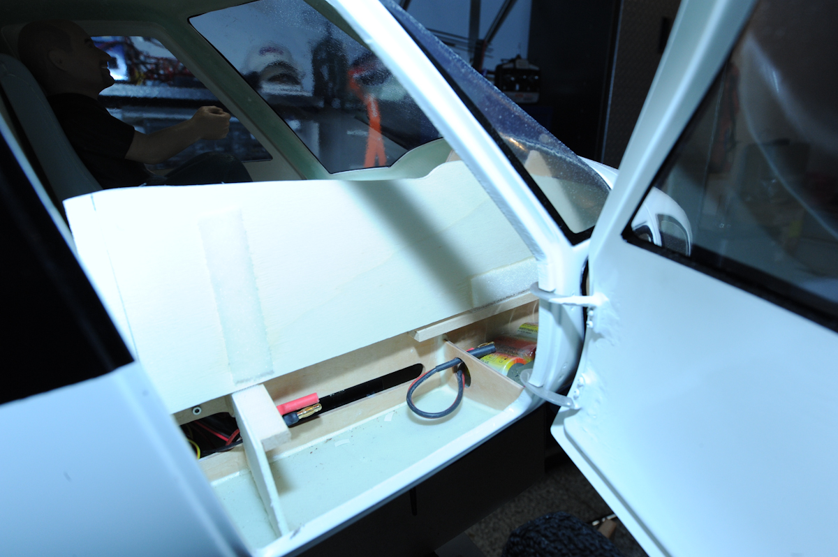

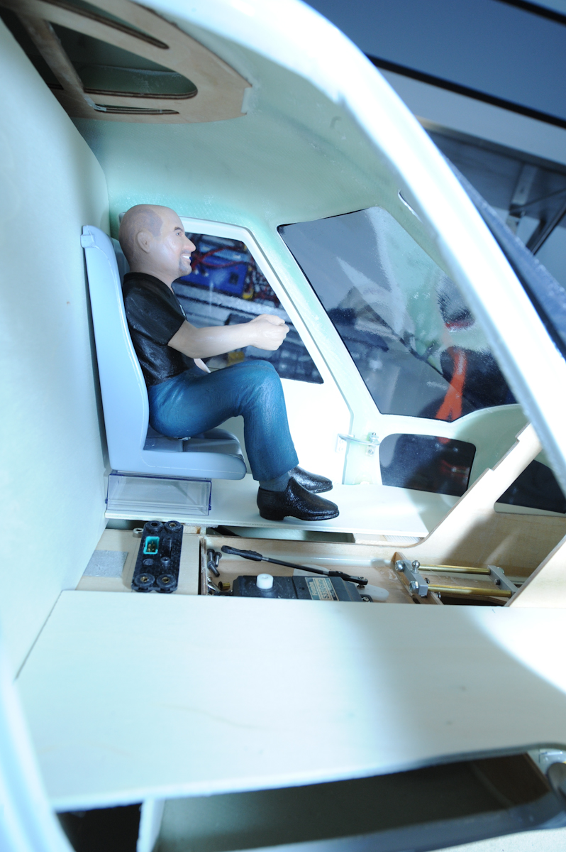

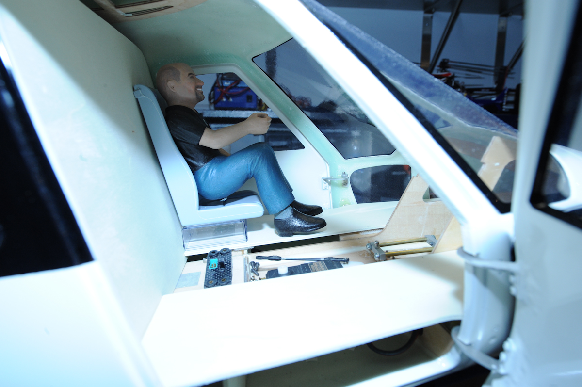

Hello,
I thought I had better post something before the "Shot Clock "ran out again. LOL
I have been putting some time into rough detail. The cockpit mainly, with the seats, the cockpit bulk head and over head panels. East Coast Scale (Vario) has some of the best scale stuff around. It may not be exactally what you need but it will give a very good starting point as I have done with his seats.
I received the rest of the hinges for the cabin doors and remaining gear door. I can move forward to finish all the doors and get the gear 100% functional.
Here are a few photos.
Butch

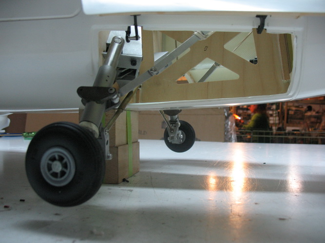

"SCHWING"
UIH
It happened, Yes, the gear on my SCALE JET 76 is functional with gear doors.
Being it was another stellar day on LI, Not for human, but for duck, (I even think that would be questionable) with some help from sgfromny and ambravo, the gear looks great.
The gear sequencing for door, and gear movement is all done internal to the TX with on sequencing devices. To do so, we are taking up 4 channels, however this allows us to not have any unnecessary devices installed to operate the gear.
The 12x being as versatile as it is, really made this pretty simple. Once the curves were made and servo timing for the doors adjusted, it was pretty much done.
Here is a vid of the gear.
Butch

Nice. I think you should send your gear here, after powder coating, for me to look over and make sure its OK.
I am not sure of the hinges you have installed on your gear doors, but lets talk about that before you move forward. Depending on the hinge, just a longer arm may not be enough. With the hinges I used from BVM, the top of the door needed to be trimmed, and a filler will be added to the fuse so the door would open enough to be a work platform as the full scale.
With my install and hinges, the filler will only be about .195 or less. Its one of those trim to fit thingy
Here is a couple of pics
Butch

fI kinda figured that.
LOL
So, do you like chop a hole in the snow and do the Air Wolf thing from the snow cave?
What happens when you get a "White Out" when landing?
I made a set of ski's for my R-50 some time ago. I had a blast doing 20MPH run on landings.
I installed the drag braces on the gear this evening. I am using an elastic band for now but will take some measurements and install springs for the final install.
This is looking pretty good.
Butch
