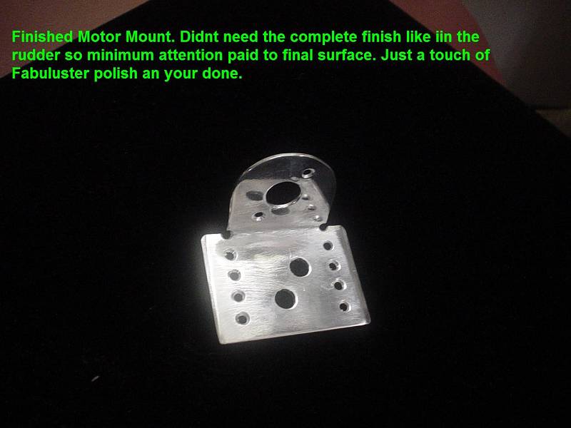

Thought I would update this with some picks of the lil boat I have courtesy of DoubleDog. The boat in in transit an should recieve intime for some weekend running next weekend. Ordered (2, for this an the Skunk cat) ETTI 125A Brushless ESCan water jackets going to ditch that coil cooler you see on it, an am waiting for some dimensions to order the batteries but will probably end up with the EVO25-3700mah 2S 7.4V 25C 92.5A lipos (bought 4) an am going to order some props to fit her up with like a x427 an a few up from that. Will get them raw an balance an sharpen myself, its pretty easy to do since I have a high speed bur balancer for my jewelry making, it can help me make those blades PERFECTLY balanced up to 60K [X(] that way Im sure its true an straight an running hard. will have video an pics by next week!
-Wayne
-Wayne

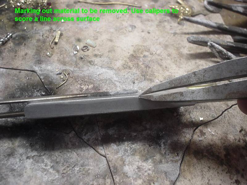

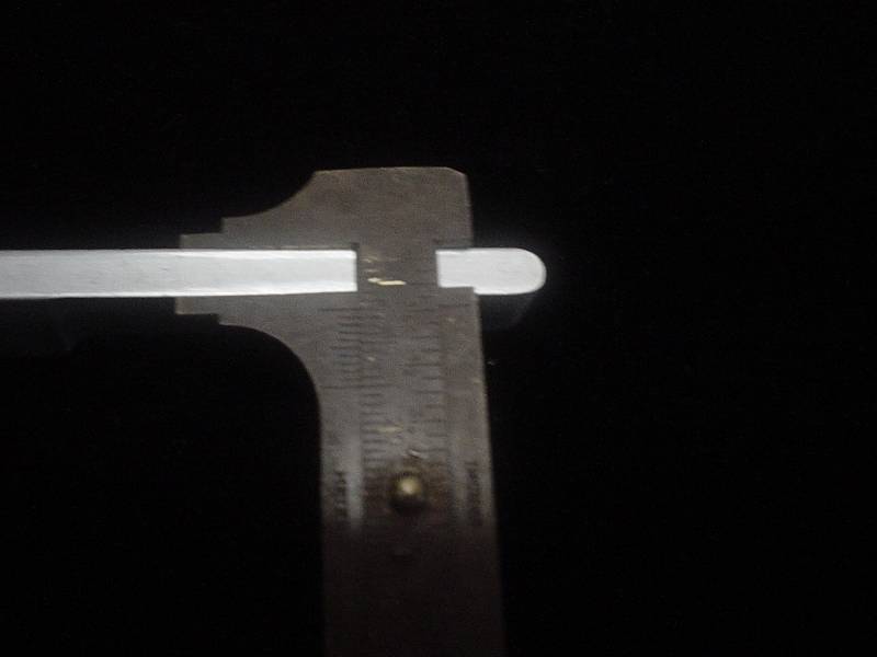

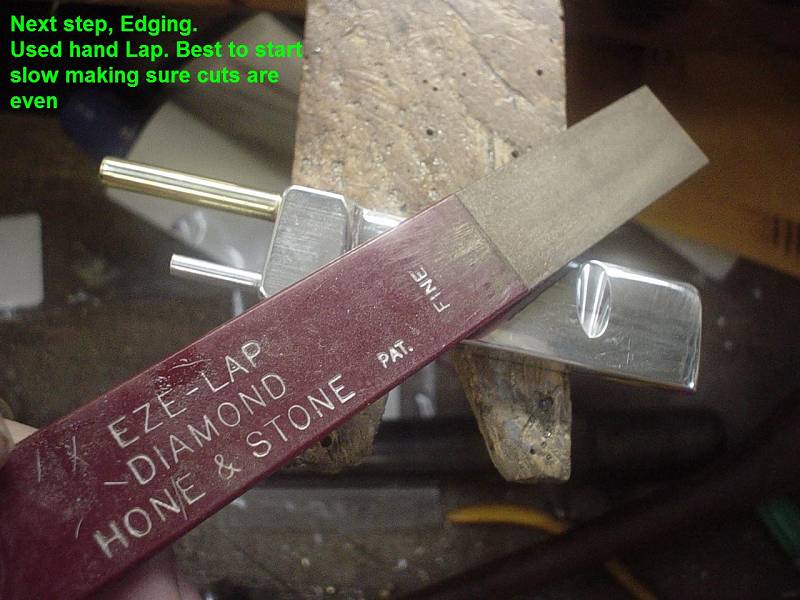

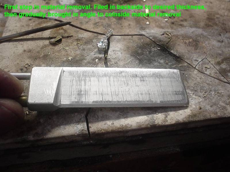

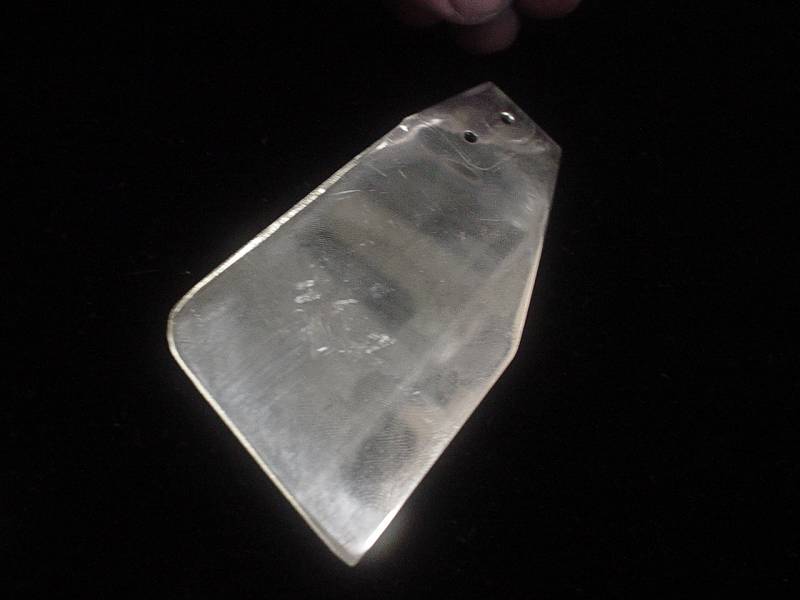

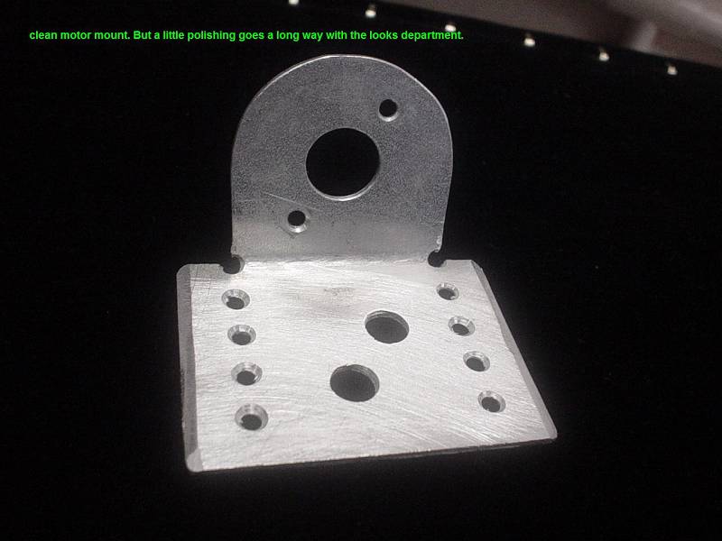

Turn fin gets the same treatment. Ive decided to keep the rudder mtg an strut in place for now an remove tonight before it goes to paint guy.
I'd like some input on the turn fin, it seems excessively large for this application. But I have heard that a deeper on is needed on riggers? Yes no?
Would it be a good idea to shape it a little more streamlined?
like the example on the third pic.
Thanks for your input guys an by next week should have video, just waiting for the final bits to come in. ESC/waterjacet/battery then Ill be ready to rip [8D]
-Wayne
-Wayne
Join Date: Oct 2005
Location: Tottenham/Orillia, ON, CANADA
Posts: 6,449
RE: New Rigger setup
thats a great hull thats for sure!!.
but you just ruined everything with your polishing and rounding it dude!!
round curves and soft lines are like the WORST thing you can do that a boat, causes major drag
i'd get that file out and sharpen everything or you will have a sad running boat.
as for being "too steep" i don't know what thats about. the best rudders are wedge rudders. a knife blade rudder isnt even as good. and i have run a knife blade rudder, I made it out of a Hankel's fillet knife, i used that and then replaced it with the exact Fullers mini rudder you have and its made a WORLD of difference
and leave the turn fin like that dude, you only round it, if its on a mono becuse when the water hits it the boat is on a angle so it doesn't give so much suction.
that grapuner hull ( got it drom DR jet ?) is a great boat.
ORIGINAL: Taylor Shaw
thats a great hull thats for sure!!. Thanks
but you just ruined everything with your polishing and rounding it dude!! beg to differ, I did no such rounding was especially carefull to leave all edges sharp
round curves and soft lines are like the WORST thing you can do that a boat, causes major drag Thats why everything was sharpened
i'd get that file out and sharpen everything or you will have a sad running boat. see the pic with the hone????
as for being "too steep" i don't know what thats about. the best rudders are wedge rudders. a knife blade rudder isnt even as good. and i have run a knife blade rudder, I made it out of a Hankel's fillet knife, i used that and then replaced it with the exact Fullers mini rudder you have and its made a WORLD of differenceJust thinned the piece overall since it had some dings in the back side still is quite wedged but wanted a cleaner transition an no nicks or chips
and leave the turn fin like that dude, you only round it, if its on a mono becuse when the water hits it the boat is on a angle so it doesn't give so much suction. Thats what I wanted to know! Will leave as is
that grapuner hull ( got it drom DR jet ?) is a great boat. Yup by way of double dog he had it first basically collecting dust so bought from him

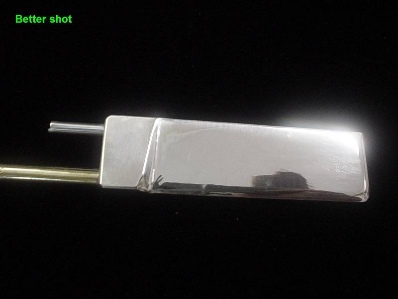

here is maybe a better shot. If you have a reason for not polishing,maybe a satin finish, do chime in. But in regards to making things rounded, it can happen to someone unsure of polishing but Ive been doing it for years, an I know my metals! Put a shine on and an edge that will cut you if your not careful.
-Wayne
-Wayne
Join Date: Oct 2005
Posts: 6,449
i'm not talking about the front of the rudder. i should hope you know to sharpen that part.
Look at the back where it is the flat spot the back, you have the leading edge, then you have two more at the back, I see from the picture that that is soft and round. from what i can tell, but that should be sharp.
I was fairly certain that all edges were square an sharp but since you pointed them out, I went back over them an checked. Nicely square an sharp on all edges. a few passes with the hone stick confirmed it everything is as it should be; square, sharp an highly polished. Thanks though for your concern! An appreciate everyones advice an knowledge so far.
-Wayne

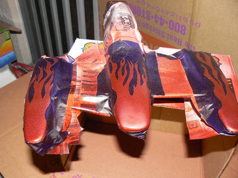

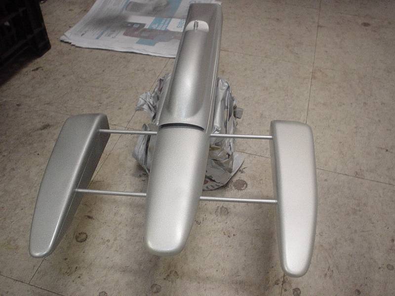

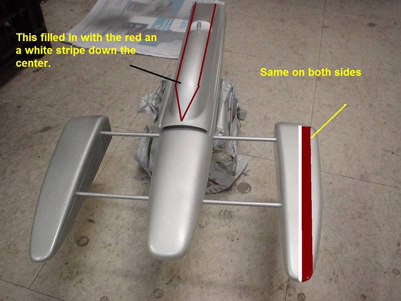

update: Paint
With my paint guy doing two large landscape paintings for me (more likely HUGE is the correct term 6' by 3.5') An I just gave him my skunk works cat to do a wicked airbrush set up. That leaves him with very little time to paint this little rigger, an I so want to run this sooner than later . I decided to do the paint myself with a little airbrush kit I had laying around. Going to be pretty simple; dupont paints, a silver mettalic flake base, red mettalic an artic white flake. All an all its turning out good. Have base coat on it now an when I get home I'll start with the lines an graphics. Hope the steady hand holds out!
Graupner silver bullet, well its silver now
-Wayne
-Wayne

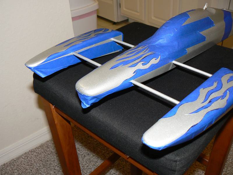

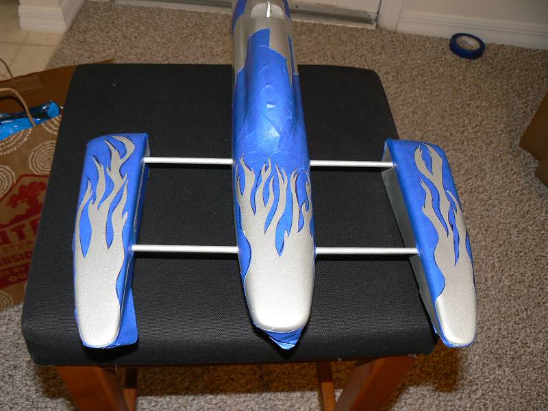

heres the mock up I was thinking of doing, turns out I can paint pretty well but using paintshop on the computer with a touchpad laptop, I SUCK!
But heres the general idea of what Im going to do. Might change a little as I start to tape things off tonight. who knows. Let me know what you think. The dark red on paint sho doesnt do the actual color justice.

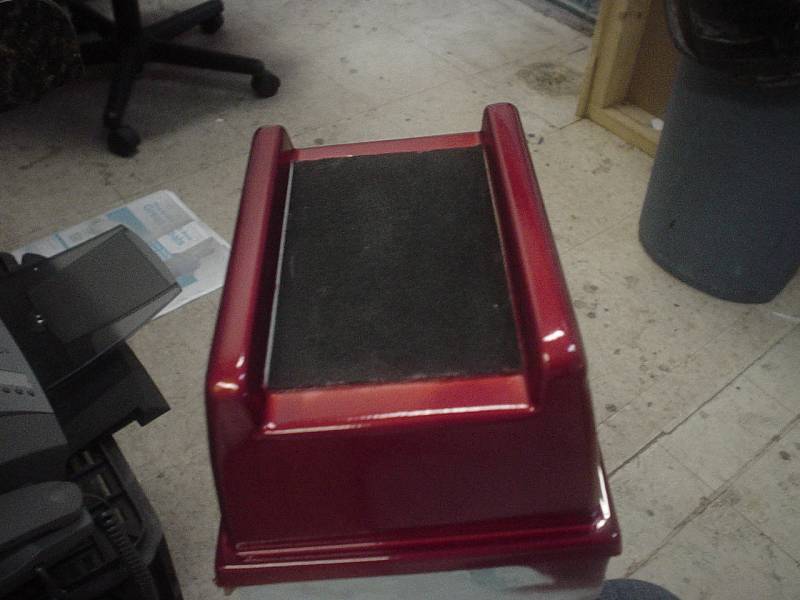

Wanted to paint the stand also so I shot it with the red so you all can see the true color. Im really liking how the red turned out. Thats only one coat over the plain creme plastic! Its a candy red so the base color will play with the color tones an give a bit more sparkle once I have a few coats an clear on the hull.
So far Im happy an cant wait for the finishing touches![8D][8D]
-Wayne

UPDATE 2.0
Well its taken me a little longer to finish the paint job because I ended up going overboard [X(]
I decided to do a paint job barely in my level of skill but figured hey, itll go so fast no one will see any blemishes it actually turned out really good excapt when I got to the end (Im copyrighting my last statement seems how that always is with me)
Ill post the layup procedure I used then Ill post the finished picks tomorrow after I buff it out, dont worry I plan on blueprinting the hull to take out any rounding done by painting an not going to wax the running surface, only wet sand that.
Anywho heres the tape up
