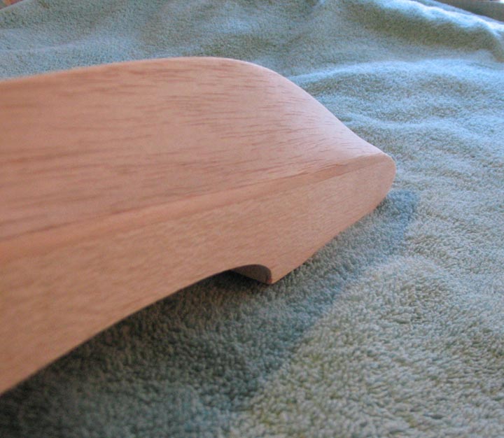

Default RE: new model started
Thanks, Alex! Me either.

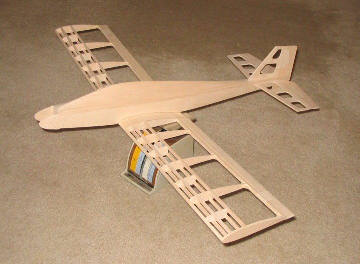

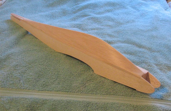

Well, it definitely looks different than the cad drawing.[X(] I wasn't really aiming for the Mako Shark look, but, hey, why not?

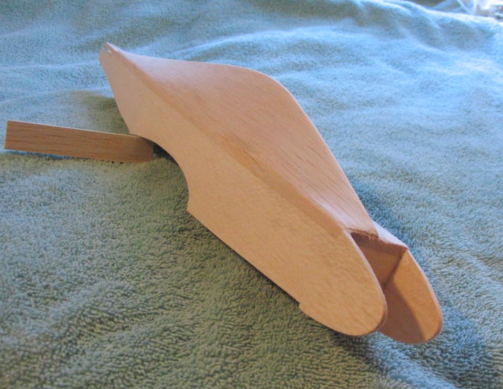

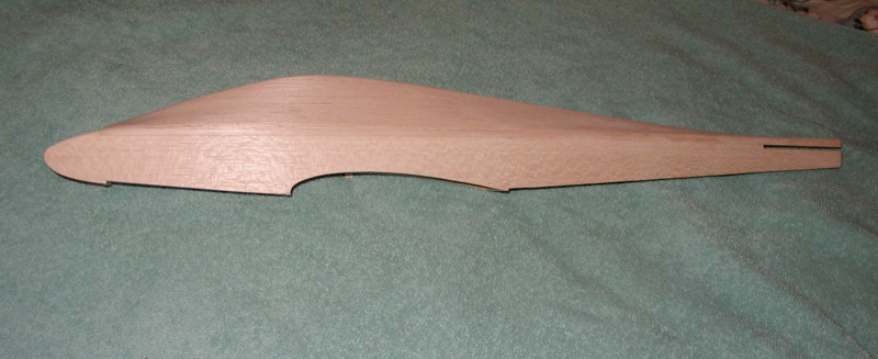

Yes, I definitely think it's time I started trying to teach myself to use 3D software. It's dangerous what a little amonia (Windex) can lead to. I dampened the sides with amonia so they would bend and ended up with something that looks like a fish. Maybe I should glue a dorsal fin on it!
Actually, I like the profile a lot. Maybe I should add some biomorphic tips to the wings.

Toss on some ornamental Pect Fin cannards
With the ammonia trick, do you lash it down to take shape & let it dry... or can you glue it "wet"?
Going to need to do some compound curving on my b24 Nacelles, and was planning on trying the windex to do it rather than planking it.

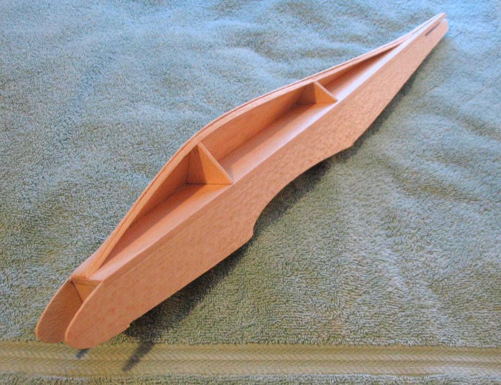

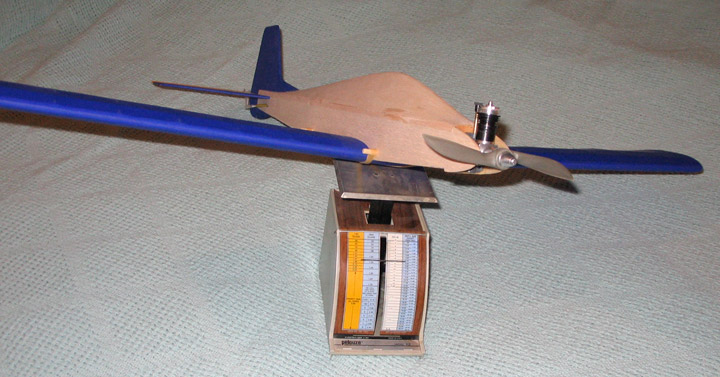

ke, you can do it either way. One issue with glueing while it's wet is that the amonia kicks CA and turns it white. I think the ideal method is to wet it, use carpenter's glue and wrap it with tape until dry (like you were making laminations). If you have one of those little X-acto table saws you can rip a bunch of strips with beveled edges and plank. Otherwise, the Windex method is faster.
Here's a masking tape mock-up. Weighs 4ozs in the photo. I think I'll get in under 10ozs auw.

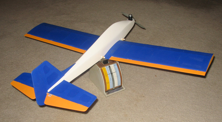

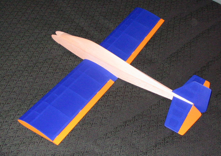

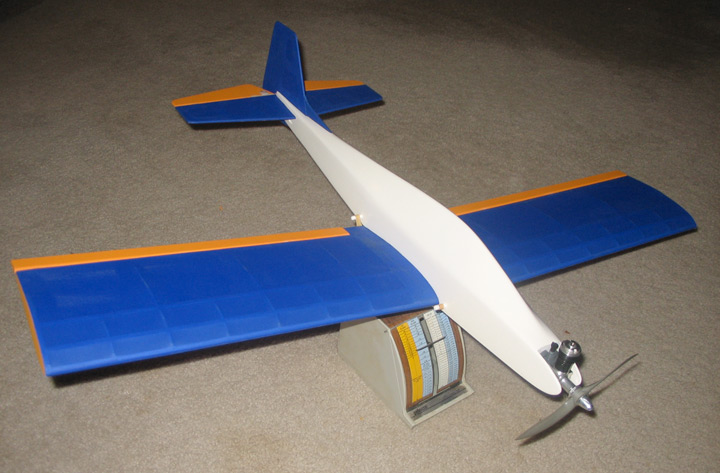

Thanks guys. Since this is an experimental design - I don't even know how it will fly - I didn't want to waste any of my precious Esaki tissue on it. I had some Worldtex left over from another plane and used that. I think I'll spray the fuse with white dope. That will contrast nicely with the blue. Maybe orange and blue stripes down the sides.

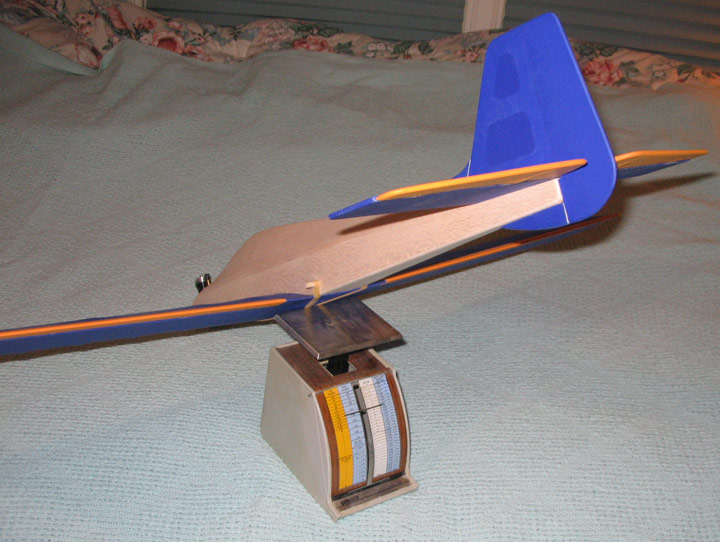

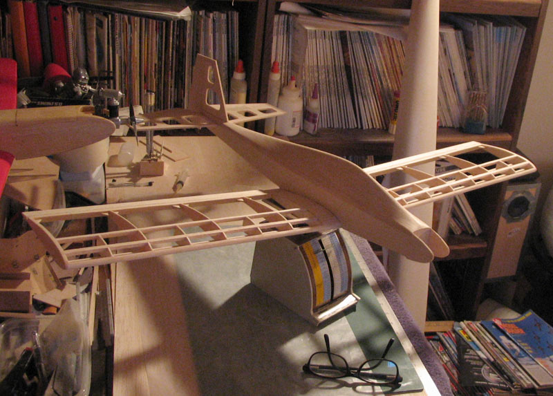

A few more pics. The servos are installed, the surfaces hinged, I just need to spray some white dope on the fuselage and install a tank. With the Surestart and a 370mah nimh up front it balances right on the second spar. I added a skid/subfin and a dorsal extension to the front of the fin. It's going to end up weighing 11ozs or maybe a little less. That heavier than my target weight, but still not too heavy.
I can't wait to fly it and see how it handles.

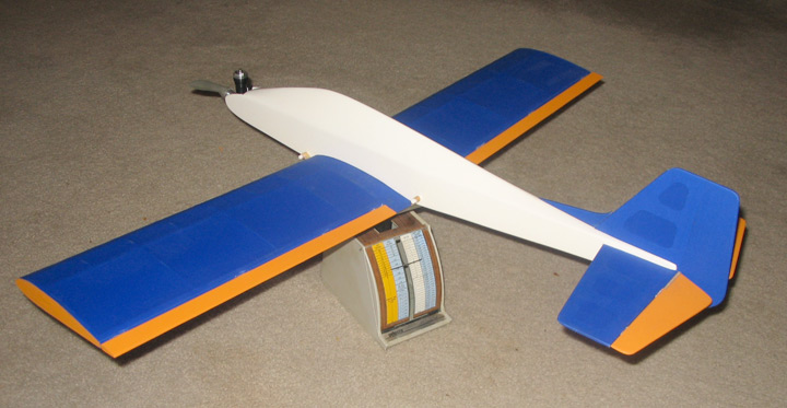

I sprayed the white dope over the weekend. I still need to clearcoat/fuelproof it. Then, I'll let it cure for awhile and it will be ready to fly. I still don't have a name for it.
