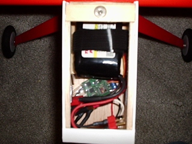

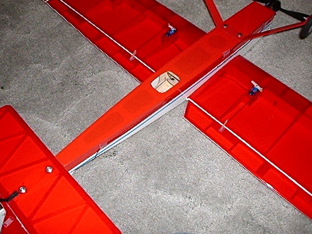

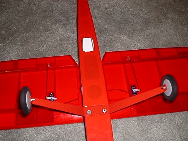

Hey all, I just finished this about 10 minutes ago. What do you think? It has the Park 400 inrunner brushless, Phoenix 25 ESC, Thunder Power 1900mAh li-po, and HS-55 servos. I have a couple of questions; first, what is that large hole in the bottom of the fuse? Did I get a reject or something? [X(]
I was thinking to just patch it up with some mailing tape until I get some transparent red ultracote. Also, I had to add 14 grams of lead to the nose to make it balance. Is that OK or normal? Without the lead, I had to move the battery so far foreward that it was covering the speed control. Also, would the speed control be OK where I have it now? Thanks a million

It looks great. You did a great on that airplane. Have fun flying it. What was your all up weight? did it come in between 22-26 oz?
1. That hole is for the air to escape after moving through the fuselage. It helps cool the battery and speedcontrol.
2. The speedcontrol should be fine. If you had to add 14 grams to your plane you might want to save your money and purchase a 3 cell 2100 battery. The Thunder Power. This battery will take care of the 14 grams. the 2100 weights about 5.5 ounces. Your 3 cell 1900 weights about 4.9 oz.
Bevo
