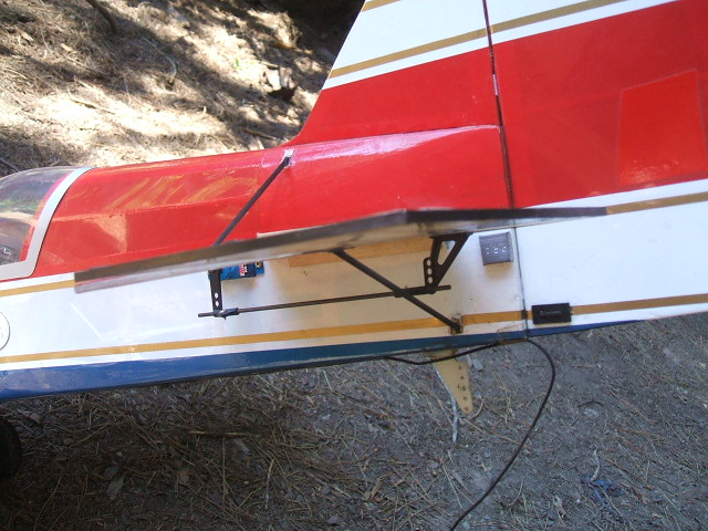

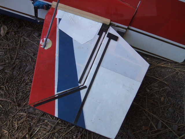

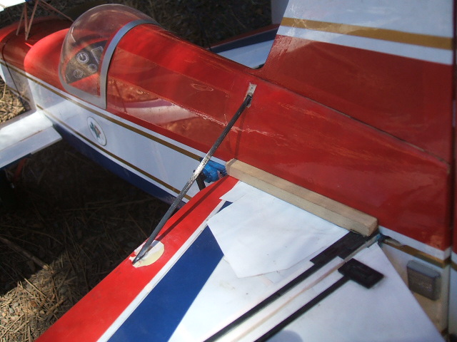

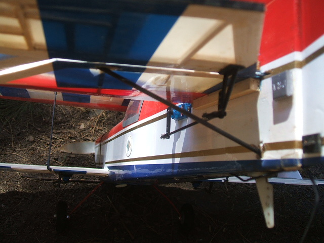

Old 07-12-2007 | 04:07 PM
biplanemurphy's Avatar
Joined: Feb 2007
Posts: 203
From: Lancaster, CA
Default RE: Great Planes Ultimate Bipe electric
Any pics of your tail reinfocment would be nice I have not had any trouble yet but it looks like soon to come.
Here's some pics
I used carbon fiber flat strip(Very thin) on the top and sides all around the Stab/elevators.
Carbon fiber rod for tail braces.
It is now rock solid!!!!
Also had to use some sqare basswood to re-mount the stabs when they sheared off at fuse!!(not very pretty but it is strong!!
Murph..........
P.S. properly reinforced this plane is GREAT!!!! Flies extremely well!!

Old 07-12-2007 | 10:59 PM
Joined: Feb 2007
Posts: 203
From: Lancaster, CA
The stabs (vertical and horizontal) on this plane are very thin and flexible. Try some tail braces (carbon fiber rod0.
i only braced the horizontal, but you could go from Horizontal stab to vertical stab all the way around. That will stiffen it up immensely!!!
Good luck ..............
Murph..........

Old 07-15-2007 | 08:35 PM
Joined: Feb 2007
Posts: 203
From: Lancaster, CA
Photos on post #14.............Just cut carbon fiber rod and sand it to fit.........use thick CA to glue it. Flat carbon fiber here and there on the stabs to stiffen a bit and you will be set!!!
Rock Solid for high speed High-alpha stuff.................
Murph..........
