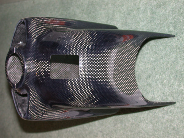

Cowl on.. just! tight fit!
Cheeks of cowl give plenty of room for throttle servo on mine... nowhere near binding...
I'm using a JR 4001 STD servo...
Have I got a mk 2 cowl or summat??
How much should the prop driver be proud of the cowl, just enough so spinner backplate clears it??
Or do any of these APC props go back further than the backplane and need more clearance??
I hope that made sense...
Regards,
Steve

spinners should normally be about 1/16 from the cowl

Thanks Foofydoo!!!
Cowl cut... first time i've really used a dremel properly
Now it's sand off the mould release agent, fill seams, prime,colour match and order fresh 2 pack, and paint!!
Regards,
Steve

See.. loads of room!
Hard Photo to take wiv me old box brownie!
Regards,
Steve

Ive got a 1/4 inch gap on mine! Purely cos DZ is longer than an L. Also my cowl is pointing up to clear my home made nose ring support. Was'nt going to spend £150 on a Hyde ARI mount was i. Works really well actually part from front of cowl about 1/4" above where it should be. You dont notice it tho as i put on a bigger diameter spinner.

Just give it a couple of mm.
No your cowl is the same as all of them.

I gave it 3mm, in case of detonation [:@][:@][:@] looks fine...
