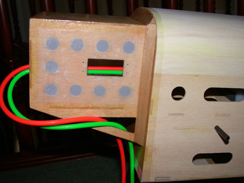

Here's how i covered those pesky holes in the firebocks.....
Solartex and a light coat of clearcoat....

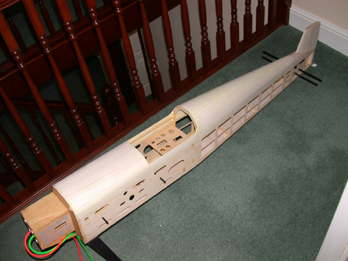

And here is the finally completed fuselage, now ready to cover.....
Regards,
Steve

Default RE: Capiche 140
nice
quite difficult fitting the whole thing into the photo indoors isnt it

Berk you had better hurry the postmans on his way
Luke looks like he took the shot from the top of the stairs to get it all in [8D]

The only reason I used Solartex over the holes is that very light glass cloth doesn't take up resin too well over open spaces, and I ended up with blobs of resin rather than a neatly filled weave!
The bloke who built yours is obviously a practiced master and managed to glass the box and cover the holes in one go!

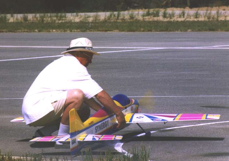

From: Mullingar, IRELAND
If it works leave it.
Angus
ps all mine are two vent tanks (L and DZ's) but in my Synergy (DZ) its got a header to ensure no bubbles get in and its got a foam clunk in the main tank. In the Capiche (DZ) its just got a foam clunk and no header and its been 99% ok.
