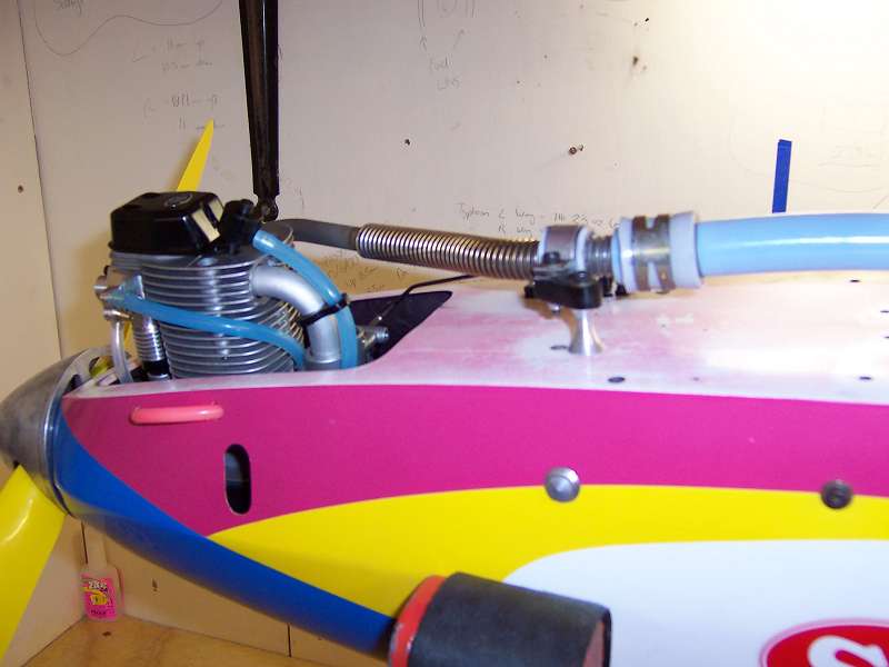

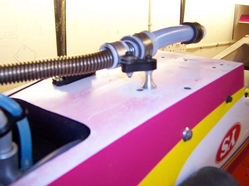

Next challenge is to mount the 791 and 699 pipe... Anyone got photos of the header mounting??? I think this needs to be soft mounted too or it will break??
Pipe is softmounted at rear...

What kind of header is it? If its Hatori or Johnson then the MK header support is very good. Just make sure the header can move forward otherwise it will break after only a few flights. Probuild should have them.

Yep, it's a Hatori 791, part solid, part flexi.. a push-fit onto a 699 pipe!
Can't seem to see what this MK mount looks like

Old 11-19-2004 | 07:43 AM
  #2044
Angus Balfour's Avatar
Joined: Oct 2004
Posts: 904
From: Mullingar, IRELAND
Default RE: Capiche 140
I'll try and get a pic up tonight. You'd need to check it goes over the end of your manifold tho (if its the same diameter as the flexi bit then it'll be fine)

Old 11-19-2004 | 12:10 PM
  #2046
Joined: Oct 2004
Posts: 904
No probs. Here's a few pics of the support. Bit blurry but you get the idea.
Angus
