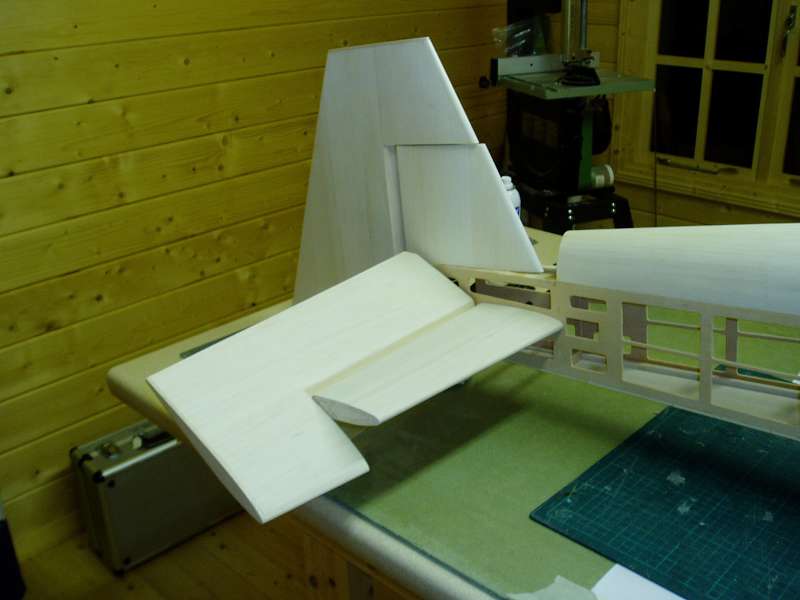

hi again. heres some more pics after building one elevator and tailplane section. i ahve also decided to go with the JR 8511 on the rudder aswell as the elevator now.
*3Der*

Looking good *3der* !!
