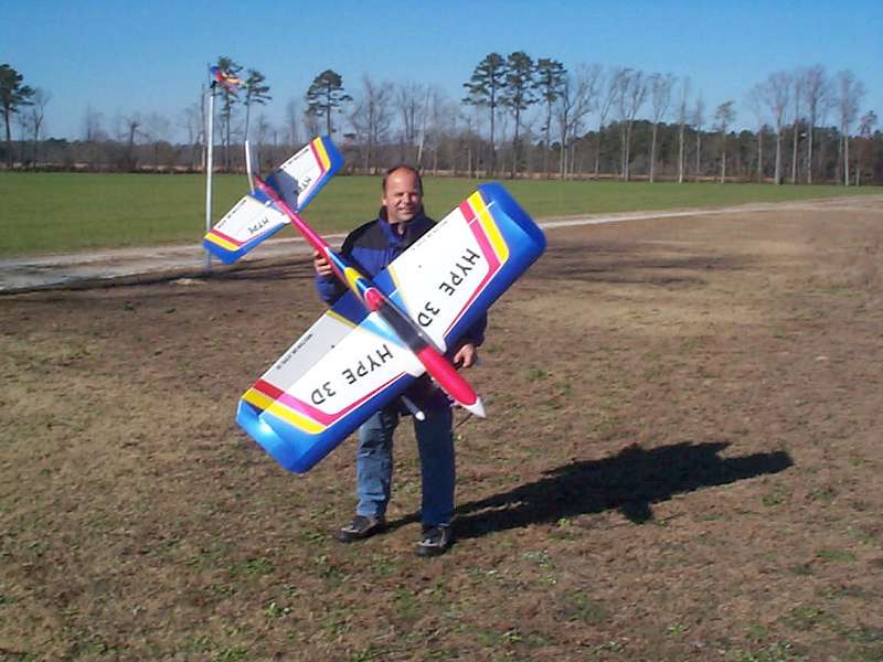

Just finishing up my Hype. Installing rudder linkage. I have plenty of throw on the rudder. Only problem is when elevator has full throw it interfears with the rudder cable on the pull pull. Unless the cable is put very close to the rudder. Does anyone have this problem ? Is there enough throw that close to the rudder ?
Chris
Chris
My Feedback: (27)
Posts: 139
From: Point Pleasant,
NJ
Can you measure from the top of your rudder down to the control horn and let me know. Right now I placed the control horn in level line from where the rudder cable exits the fusealage to meet the control horn on the rudder. It looks if I make it higher it will throw the alignment way out
My Feedback: (20)
Posts: 2,249
From: Clayton,
NC
My plane came with marks( pin holes ) for the pull-pull cable exits on the sides of the fuse.
My horns are four and a quarter inchs from the bottom of the rudder. It helps to cross the rudder pull-pull wires inside the fuse so there is not as much of a bind when exiting the fuse. The back servo is the rudder servo and the forward one is the elevator servo. I was not impressed with the stock pull-pull wire so i used some DuBro 4-40 wire.
HTH
HTH
