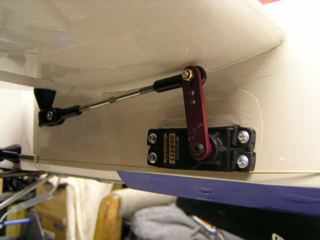

I'm finally getting down to the nitty-gritty of installing servos and setting throws but I cannot get enough throw no matter how I slice it on my elevators. I've got a 5925 with a 1.25" airwild arm placed in the side of the fuse where they have a hole slit for it and a Nelson's Offset swivel link on the elevator about 1.5" from the hingeline. No matter how I place the servo (so the rotation is further or closer from the swivel) or if I set the axis of rotation closer to the elevator or further away, nothing gives me a '3D' throw, is there some secret, some rule I didn't follow? Can anybody point me to a picture of how it should set it, I'll try and post some pictures of what I'm doing now.

hope this picture helps. I ended up moving that elevator servo hole down so that i could fit the arm pointing up like it is. I get at least 50 degrees of throw, and the planes flies great. Hope this helps.

Yes, _thank you_, that helps much. I also lowered my hole but didn't know if it would help, it would appear that I need to move my hinge forward too. Thanks Zak!

3dbatix, it looks like your rudder cable rubs your servo slightly, is that working out ok for you? I ask because I can lower my servo enough to fit a 1.25" arm in there and get good throw but the cable rubs the servo slightly, about the same amount as yours does.
Sam
ORIGINAL: 3dbatixkid

Sizam.to prevent the rudder cable touching the elevator servo,move the cable exit to lowest part of the fuse.For rudder control horn you can make it out of epoxy board or buy it and bolted to the bottom of the rudder.Beside if double bevel you get over 50 degrees.

I ripped out the rudder horn as it was worth it to use the 1.25" arms on the elevator servos, now I get around 50deg each way which was the goal.

My cables do touch just a slight amount, but it has not really been a problem. I have the cables there because i already had the control horn in.
