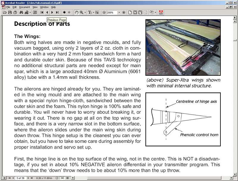

I think you're right there, ARF is becoming too much like the word "free" is now. I think the fact the fuse are moulded takes a lot of work out of these planes. But the hardest bit I always find is the installation of everything.
If you can, could you describe how the ailerons and elev are hinged, because they're kevlared in and I still don't understand how this method works. Pics of that would be nice too.

This image might help you understand the wing construction/hinging. All Comp-ARF models are hinged in the same way.

  #39

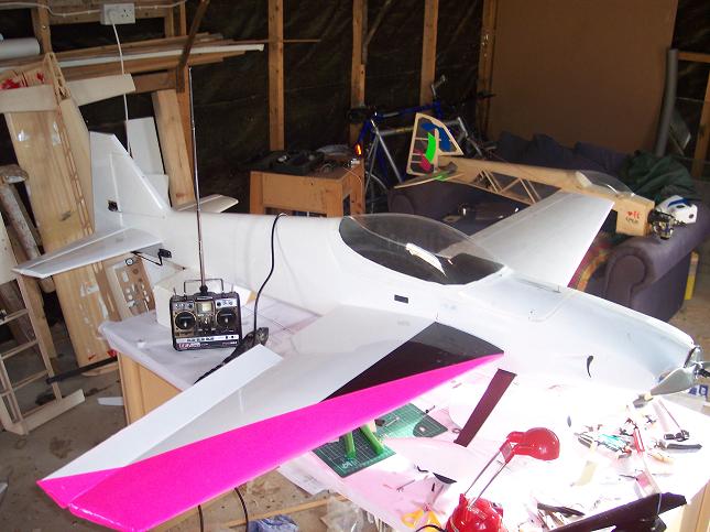

some colour, especially for Ian.
what do you think so far

  #44
Shahid's Avatar
Joined: Dec 2003
Posts: 1,538
From: London, US MINOR OUTLYING ISLANDS
Default RE: electric smaragd freestyle
That looks FAN-shazmobloodyeffing-TASTIC

nice good to see the UC the right way round aswell

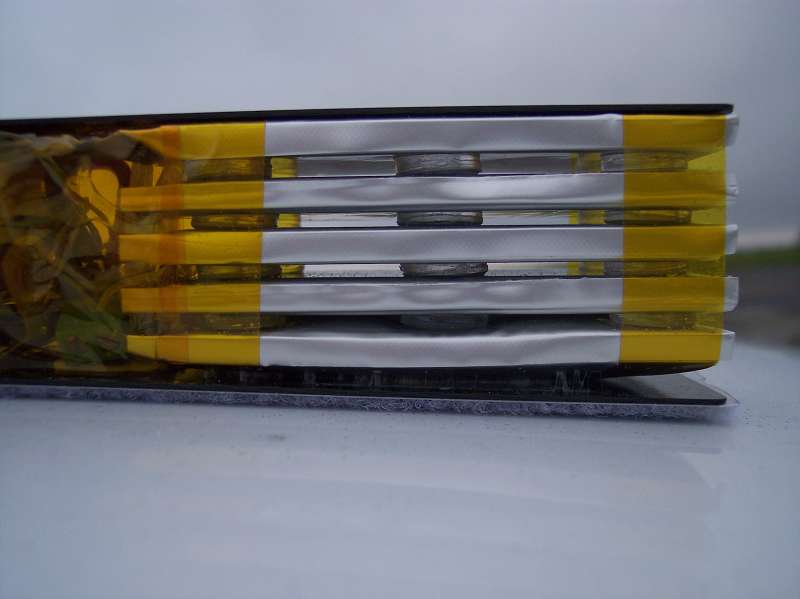

THE REPORT
Weather was fantastic once I got up there, forgot the wing tube ,(not used to plug in wing planes) but got up there at about 10:30.
FOur other chaps were there, complete ignorant n**s noone said hello. ANyway I got my plane out from the back, it only just fitted in. Put the batteries on charge, assembled it, took some photos, went to get the batteries and then.
