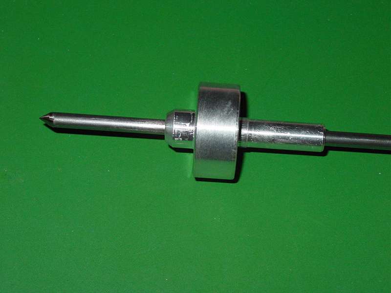

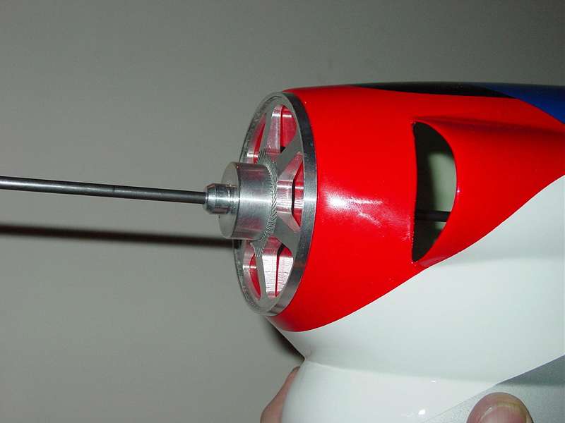

It was raining hard today so I went to the work shop to align my DA-50 on the Vision. I'm using the Slimline muffler so I wanted to mount the engine inverted. I had noted that Chip has the engine canted to the side for the header etc.
I lined the cowl up with the fuselage and then decided to make up a tool to find the center of the thrust line on the fire wall. It made it real easy to mark the firewall and then extrapolate the stand-off holes. Then the rain stopped (VBG)
I think the pictures describe it best.

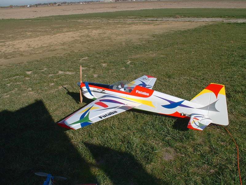

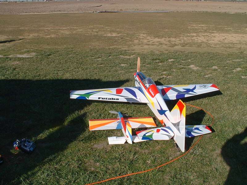

I had a chance to fly mine today, and I love it, I installed the engine with the suplied 2 1/2 inch stand offs and it flies fine, I am using hitec 5645 on everything, except rudder, on the rudder I am using a jr 8611, no cables, I balanced it with a jr 3000 mah battery behind the tube, against the radio tray, I think after the engine gets broken in I'll move the battery back maybe about an inch or more. For power, DA 50 with tunned pipe, awesome!!
