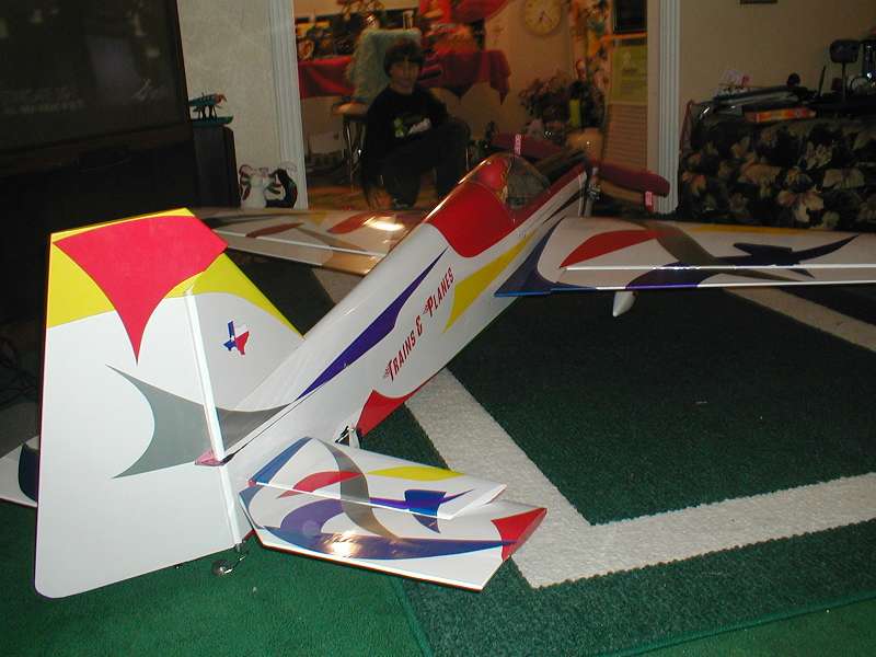

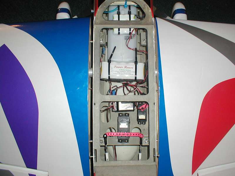

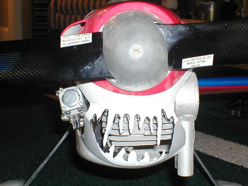

My Vision. BME 50. Need to get an accurate weight, cause I keep getting right at 15 pounds.

A few more. The anti rotation pins are tight tight tight!. Very slick set up.

Got a couple of test hops today.
Flys great. 3 or 4 clicks up up trim were needed. KE is very very good, just a tad pull to the canopy, however nothing I will mix out, no reason. Does fantastic KE to KE snaps. At full rate waterfalls are very tight. Roll rate is very fast at low rate, didn't even flip it to high, forgot too. Hovers at a little less than half throttle, punch the power and climbs away well. Best dam harrier-ing plane I have ever flown, it just drops down (it was about a 15 mph breeze). Did a few blenders way up and it did not eject anything, thats good. Did not do any slow 3D stuff to speak of, so that will be next week.
Things that need attention: Needs more right thrust. Blew several pieces of the covering off in flight. The tail wheel; I noticed a couple of times that I seem to get a tiny hit and on landing of the 2nd flight, I saw the rudder bang to the right and I didn't do it. After additional inspection of the tail wheel set up, there sure is alot of metal to metal in there, so its gonna go.
I like it. A couple more comfort flights and its gonna rock.

YNOT had some great flights today[8D]
I can't wait to see That Elevator on high rates, humm nice pictures Tony if they only knew.....

YNOT, the tail of your Vision looks very interisting[X(]

Dirt Daddy...
???? The texas decal?
