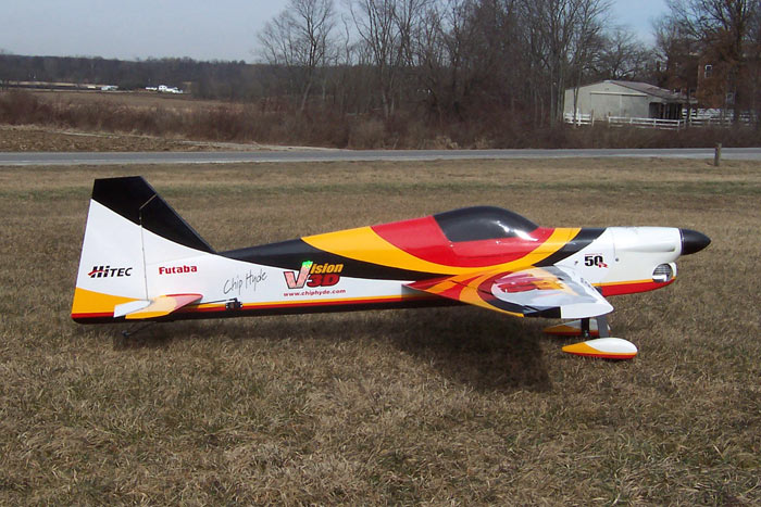

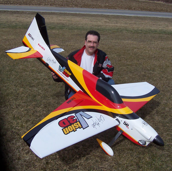

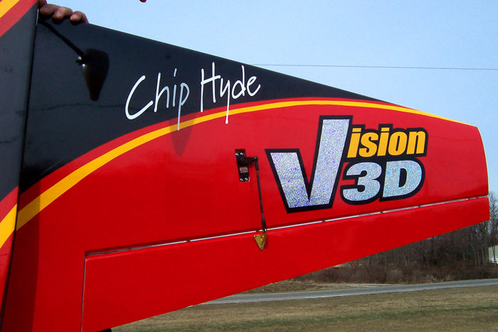

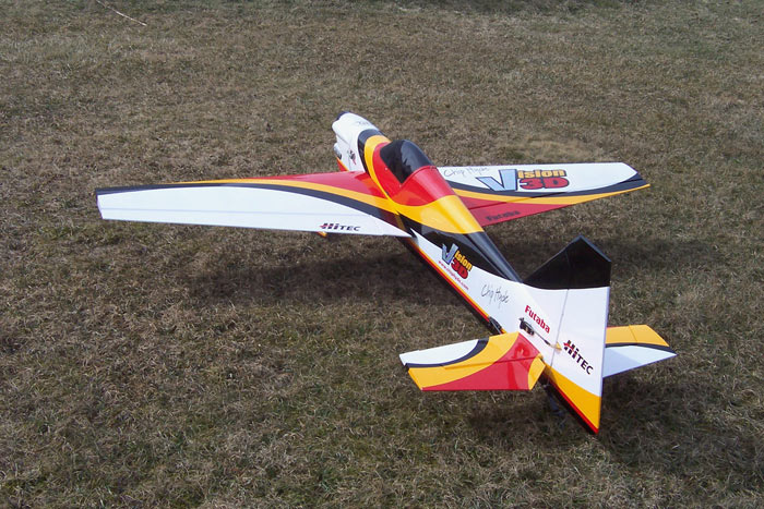

Hey Vision fans... great thread. [8D] I just started a new thread on my Vision build, where I show my custom covering scheme and a few other mods. Here's the link if you're interested...
[link=http://www.rcuniverse.com/forum/m_2749394/anchors_2749699/mpage_1/key_/anchor/tm.htm]CUSTOM VISION 3D[/link]
Custom scheme was designed and cut from Ultracote by me, and I designed the logo/gfx in Illustrator and had Dave "Maudib" Johnson cut them from vinyl.
Anyhow, I still need my prop, RX battery and a little final radio gear installation, then I'm ready to balance and weigh this puppy! It's still 20 degrees and snowing in my area, so it will be a while before she gets a maiden. [
I can't wait!!!!
Here are a few pics, there are more at the link provided above.
