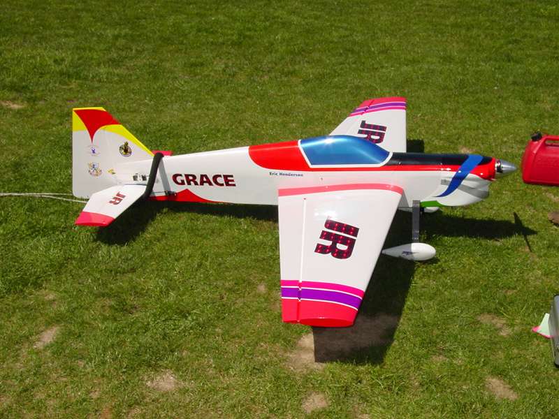

I joined the "Flew my Vison to today club" this week. Been waiting since Xmas 2004... Ditto to Angus's remarks below.
I did find the tail wheel wire to be to soft and the stab tube in the fuse needed some attention. The stab center section needed CA to hold it more firmly to the fuselage and the stab tubes needed thickening with medium CA to stop the stab-halves rattling. The tailwheel assembly was replaced with a spring-coil type.
The 8611 rudder servo was swapped out for a giant Futaba servo but still had trouble stopping without a bounce or two. I think the rudder is just too heavy for one servo and the weight exeeds the braking capabilities of a single servo.
The flying was very easy. I must admit I had to reprogram my pattern-brain to keep some throttle in! The Mezjlik 23 x 8 just "stops" the plane when you come off the gas. I flew P-05 FAI with it and then hit the mega-high-rates for the "silly stuff".
I had it in a couple of hovers where I could have put the radio down, wiped my tearing eyes, picked up the radio and still found it hanging there with only a slight climb. Very easy to fly slow KE's etc. On aileron high-rate I kept getting behind in the super fast roller stuff. I settled for going pure vertical with obscene roll speeds. You can high-alpha slow roll at really slow speeds all day with this plane.
Just keep a good "purr" going on the motor and chop to idle just before wheels touch down and you will land this plane in all winds :-)
Regards,
Eric.

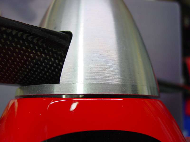

Its not a big deal the right thrust. Even if the spinner doesnt line up with the cowl its how it flies eh.
Ive heard of Chip do that throttle to rudder mix. Ive not tried it myself but ive always trimed planes by adjusting the engine angle for right thrust, not using a computer radio. Im hopefully going to fly it again today if I can sober up enough. The right thrust wont be that much that it makes the spinner line up way off with the cowl so I really wouldn't worry about it. I'll keep you posted.
Angus
Angus
#245
I stayed in Glasgow a few times playing rugby against St Mungos and Kiel.
So just for you here is a picture of my cowl and spinner alignment.
"See yuu Jimmy!"
Eric...the exile...
"See yuu Jimmy!"
Eric...the exile...

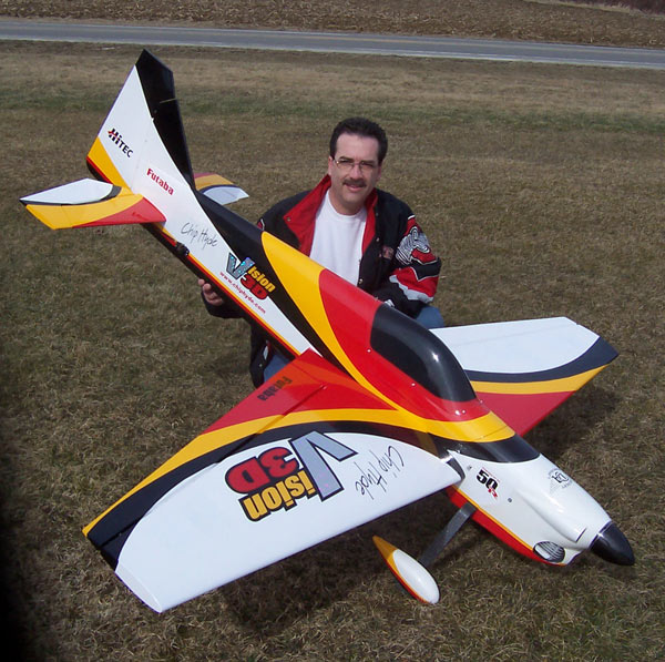

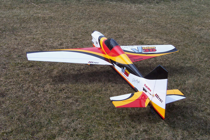

Eric, I like what you did with the covering scheme... I think that the stock graphics coming off is a plus, not a minus
... I didn't like them at all. I went ahead and stripped mine and recovered. Time to run the engine in today and do a range check.
Tom
... I didn't like them at all. I went ahead and stripped mine and recovered. Time to run the engine in today and do a range check.Tom

Nice colour scheme you've got there Tom.
