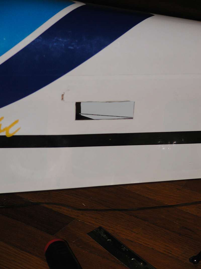

Tman, I have yet to take my CM up in the air, but I am really looking forward to it. The weather in No. Virginia has been very tempting to schedule a day off, until today when the snow began.So it looks like another week or more before I can get out and do the initial flight test.
This is my first real 3D plane so I look forward to the learning. Thanks to BME who selected my name as one of five who won this plane! My other (acro)planes are a 1/4 laser 200 , a 1/3 laser 200 and an 1/4 Ultimate Pitts; all Lanier kits. You know the heavy planes! I was really pleased at how light this Cap Maniac ended up- 7.25 lbs...If I could remember how to get the thumbnail in the post I'd put a pic of my CM in....
If you look in my gallery the first pic shows what I did for the sight cue on the CM wing bottom, the rest are of the Ultimate Pitts.

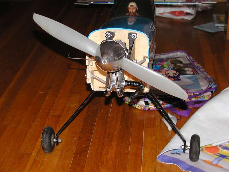

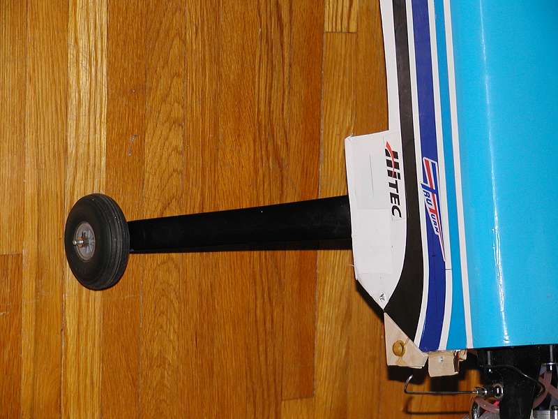

I was wanting to get mine up in the air today but it was not ment to be.
I have upgraded the landing gear to composite gear as the original gear was removed on my madian flight.
I repaired the dammage and installed the new gear a few weeks back and a friend of mine flew it on its second flight. There
were minor issues that we wanted to correct today. When it is in knife edges he had to introduce alot of up elevator just to keep the
knife edge so were were going to install washers and see how she flew. The engine was a littel rich so we had planned on adjusting it.
Got out to the feild around 5:00 pm weather had closed in and the wind picked up, so we decided to go ahead and see if we could get a
flight or two in. Mark took his sig mayhem up for a flight while I prepped the Cap for flight.
Got the wing on and fired up the radio to check the surfaces. Everything looked good until I got to the elevators and saw the the left hand
elevator was in the nose down while the stick was nuteral. This was strange since I had not flown this airplane for a couple of weeks due to
weather. So I decided to move the servo arm to adjust the elevator. Upon closer examination I found that the servo was loose. Took off
the arm and was putting it back on and the servo fell into the airplane. Glad this happened on the ground and not in the air as it would have
been messy.
I epoxyed the bracket back in place and hopefully it will hold.
Here are a couple of picks of the airplane and bracket before I fixed it.
Hopefully I can get this airplane up in the air in the next few days.
John
