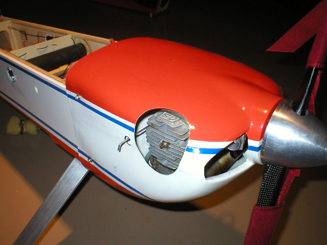

T28, I need some advice on my Edge. I have:
HS225MG's in the tail for elevator
Saito 180 in front
645MG pull-pull in std servo tray for rudder
Other radio components up front as far as possible
I need to add significant weight up front to balance on the Lanier-recommended CG. I forget how much - something like 6 oz.
Do you think I should:
1) Add nose-weight?
2) Remove the 225's and put a pull-pull on the elevator?
3) Extend the nose so I can mount the engine further forward?
I guess there is an advantage to adding weight. I can remove it to move the CG back once I'm ready for that.

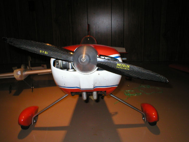

If you are an experienced pilot (you should be with this plane) don't worry about the recommended CG. It is VERY conservative. I am flying mine now with the CG at 5 3/4 back from leading edge. It does not fly tail heavy at all. I plan to move it back another 1/4 before next flying day.
OS 1.60, Slimline Pitts (inverted), Pro Zinger 18x6, Carbon Fiber wing tube. Dry weight = 12lbs, 4 oz.

Really! Now that's interesting. The CG on mine is coming in at around 5-1/2" as is now. In that case, maybe some lead in the nose would be the way to go. Then I can move the CG back while taking weight off.
Just remembered - how do I tell if I have the upgraded landing gear that won't rip out on the first landing?

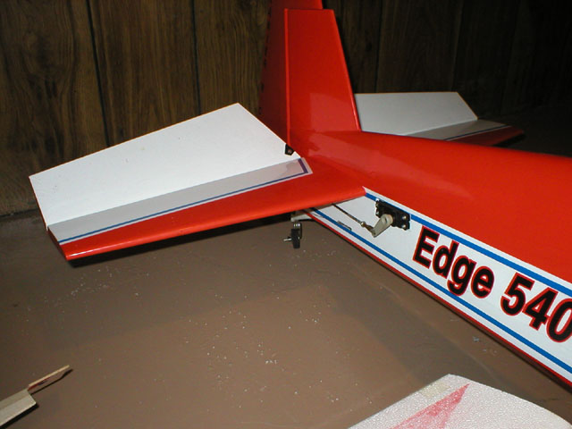

I'm working on one and I can't get enough throw on the elevator without the pushrods hitting the stab (servos in the fuse side by the tail). I have the pushrod all the way out on the servo arm and the control horn and get about 30 degree throw.
My landing gear bolts onto the aluminum L brackets in the fuse which is the upgraded way.

Jaco, to get more, you may have to use longer horns and servo arms.
It also helps a lot to get the holes in the horn to line up with the hinge center-line when the control is centered.
If the hole in the horn is very much aft of the hinge centerline when at neutral, your pushrod will smack the stab before you go far every time. Having this aft offset on the horn has the effect of raising the clevis and rod up into contact with the stab when you pull up elevator.
I'm pointing this out because the pre-drilled holes in mine are pretty far back. This puts the holes in the supplied horns about 1/4" aft of the hinge centerline.

You can drill new holes for the horns or install a pull-pull like I'm probably going to do.
If you put in a pull-pull, it's better to have the horn holes aft a bit instead of fore. Forward horn holes in a pull-pull are bad news because the tension increases with deflection.

I tried to install pull-pull on the elevators. Did not have good results. I ended up using MK Elevator Bell Crank. I get over 65 degrees deflection up and down with zero binding.
For more details look at posts # 12, 13, 14 & 24, 25, 26 in this thread http://www.rcuniverse.com/showthread...hreadid=319573
Another solution might be to mount the servos lower in the fuselage to give a greater angle on the control rod..
