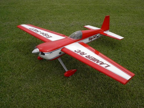

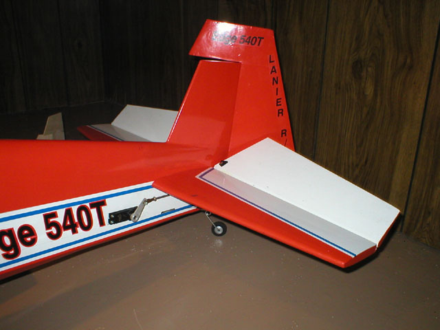

Posts: 723
From: Colfax, IL
Default Lanier Edge540t ??!help
I'll take pictures.....LOL give me a couple minutes
Old 09-29-2002 | 04:10 AM
Posts: 723
From: Colfax, IL
Default ok i hope this helps
A few pics....they say they are worth a thousand words!

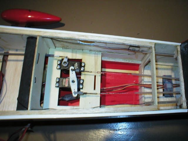

Old 09-29-2002 | 04:11 AM
Posts: 723
From: Colfax, IL
Default more...
pics...

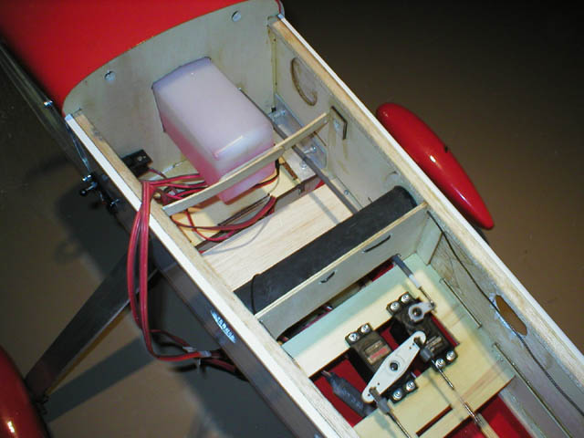

Old 09-29-2002 | 04:15 AM
Posts: 723
From: Colfax, IL
Default more pics
pics....
