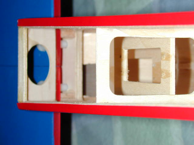

What do you guys think about the workmanship on the firewall?
Beef it up a little?
Think I'll fuel-proof back there and add some glass to edges of the firewall.
Be careful installing the wing hold-down hardware. I stripped mine and switched to 1/4x20 Nylon wingbolts.
They are so big, I'll have to make the belly-pan removable.
(In case I need to remove them for repairs etc).
The ME will fit in my car with the wings installed, so they may stay on all the time.

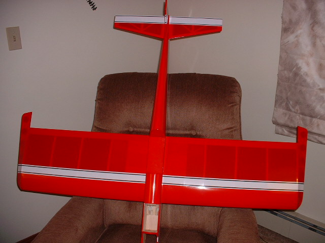

The plane looks smaller without the control surfaces installed.
Here's the before pic.

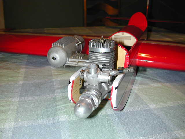

I wonder if there will be a problem installing the larger sized engines in this plane.?. I'm using a TT Pro .46
Take a look at this photo and you will see there is not 1mm of extra space on either side of the engine mounts. They are almost flush up againts the cheek walls.
The mounting holes where pre-drilled and blind nuts installed, but the spacing is off just a tad. I plan to get new hardware and enlarge the lower mount holes a bit.
Notice that the notch in the cheek is cut for a rear mounted needle valve. I'll have to do some cutting! (My Carb isn't installed in this picture).

I'm still messing with the engine mounts!
I had to cut down the left cheek for the Carb, now it looks like the other side is too high for the muffler!

Looks like you might have to cut a bit of the cheek away to provide some clearance under the muffler. Is an extension needed?

"extension needed? " No, but I think the TT 46 Pro is about the largest engine that will fit on this plane.

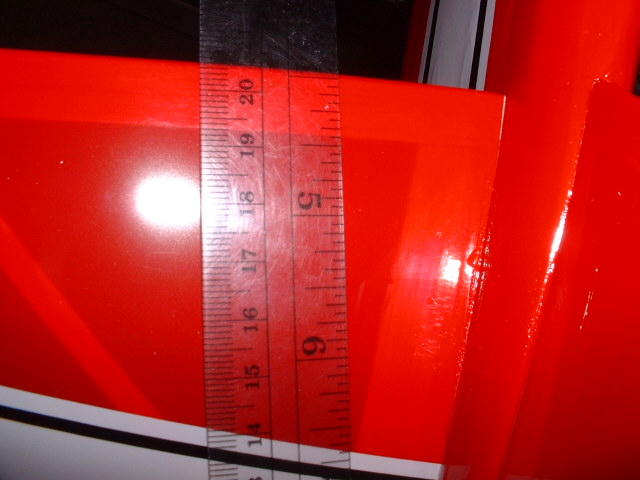

I met a guy at my field today, who had one of these and flew it. When cleaning it after the flight he discovered that the leading edge of both horizontal stabs were broken just outside of the central solid balse base. To avoid this, either reinforce with triangles glued in, which means removal of covering and recover, or run flying wires all the way around the tail surfaces, top AND bottom.

I didn't see him fly, so I don't know if he was doing WOT dives. He had either an OS46FX or a Magnum46 on it, so it's not like it was overpowered. What prop I don't know, but probably a 10x6or7 to 11x6. The break happened in flight, and if you take a look at that area it's really not that hard to imagine. The leading edge of the horizontal stab is very thin, and the reinforcement does not go out very far from the root/fuse.

Given the size of this plane, I don't think the LE is too thin.
Mine measures 0.23" thick x .49" wide.
If mine breaks, maybe I'll replace it with Coroplas
