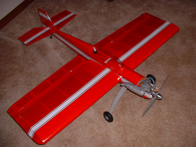

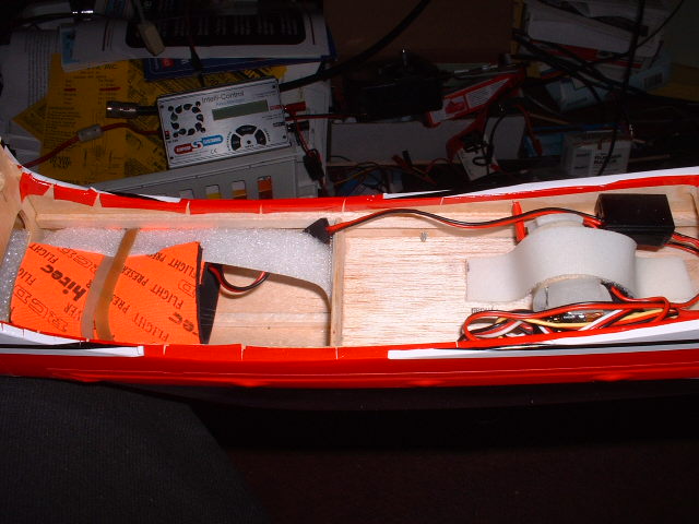

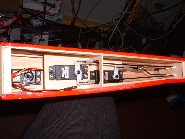

The Goop worked okay on the scraps, but I've been told that using screws for the canopy is better.
So you can glue in new pilots etc.
The aileron horns are installed. The push-rods are too short.
I installed the Servo arms at a slight angle so the threads could get some bite. I found some old FMA Razor push-rods that I may be able to cut down to size.
All the servos are cranking. I'm about ready to work on the CG setup.
Here's a fit check picture. 95% done at this point. Just have to decide how to put on the belly plates.

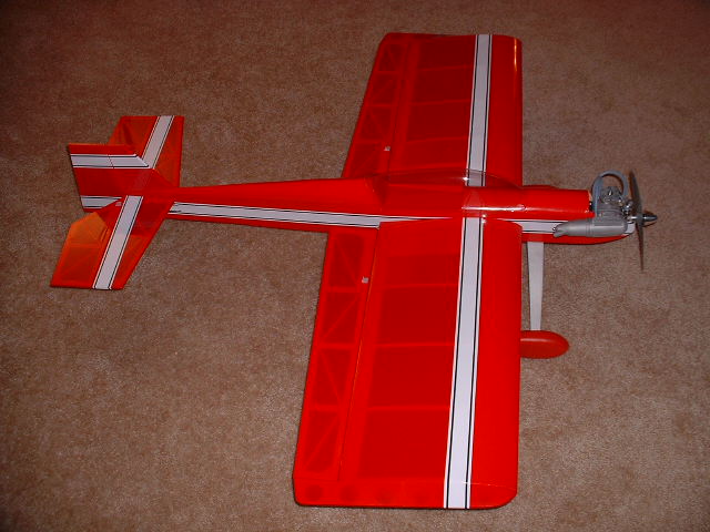

I think my belly pan is a little too long
and has a big gap on one side.
The way they tell you to install it
can't be the best way.
I just glued mine down last night
with a bunch of Goop. I plan to
use tape over it.
If it turns out to be a mess,
I'll replace the pan with Coroplas.
