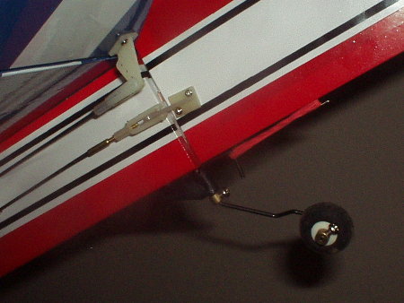

Well yes. Maybe I did sound a bit negative, but that's because I had spent a few hours putting stuff right that had become a real pain.
Anyway, as you say, it does look like it may fly well (which is why I bought it).
Maybe I should have viewed the rudder pushrods as the latest designer rodlets that may be too short to actuate the rudder but certainly save weight. Who wants to go round corners anyway? What are ailerons for?

Do not even bother with the rods for the rudder. Just use a pull pull cable on the rudder and use the long rods and cut them for your ailerons. I have a cable pull pull on my rudder. The holes for the engine mount on my ARF matched up fine. I did not have all the troubles some of you are facing with your ARFs. Everything fit fine. The wing bolts supplied with the kits are very brittle. I replaced them with nylon bolts and new blind nuts. In all putting this thing together seemed like a normal arf. Again this thing flys much better than the Sig S.E it flys similar to the UCD3D. My C.G is way back passed what the recommend C.G is.
This thing hovers very easy does nice waterfalls very nice inverted flat spins harrier rolls harrier rolling circles etc. For a $109 dollars you cant go wrong. I let a very competent pilot fly mine and he said it flys much better than the Magic and he did cartwheels with this plane. This plane is a very good value. I fly mine with a plain TT46 no mousse can and the plane has plenty of power.

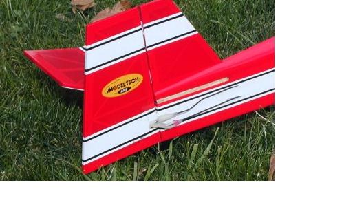

My magic was doing great until today. I finally got my CG perfect, was taking it through some gentle loops when the right rear horizontal stabilizer and elevator broke off at the bottom of the loop. I will post a pic of it in a later post. Needless to say the plane flew wonderful without it; it came around and landed perfectly. It was stable as a pattern ship even with one elevator. Since this was only the 2nd flight with it the manager of the local shop gave ma a new one to replace it (he watched the whole flight) and I am building the new one now. I am adding supports to the tail to keep it from doing that again and would suggest the rest of you think about it. It was a heart pounder to see it come off in the air.
Picture to fallow as soon as I make it small enough.
Bill
Bill

Originally posted by GmanBill
This is what it looked like when it landed.
