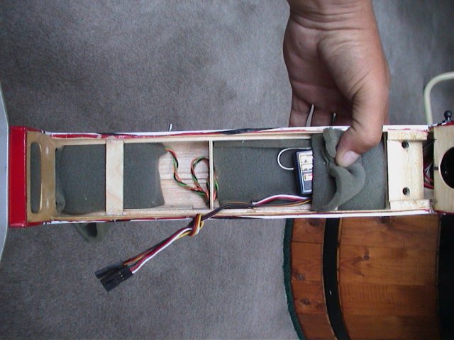

Originally posted by sledman
Willh - Where did you balance yours at? And how are it's "normal" (not 3D) flight habits? I have my servos mounted now, ran the elevator control rods last night, and am trying to decide where to mount my switch & charge jack. If I put the receiver in front of the servos so the servo wires reach without extensions, it doesn't leave much room for foam padding. I'm wondering what other people have done there. I also mounted the battery above the fuel tank after some milling of the underside of the tank hatch cover, maybe I shouldn't mount it that far forward? Remember, I'm new to 3D.........
For what it's worth, I'll attached a few pics to illustrate how I installed my radio gear. I basically used a 4-cell flatpack and this was mounted directly below the cockpit floor (towards the front). Wrapped in foam, it is held in place with a plywood brace. This also allows you to slide the battery fore or aft, to your flying likings. The receiver (a cheap-o Futaba ) is also wrapped in foam and is also held in place by a second ply brace. This is also mounted directly below the cockpit floor but more towards the back of the flooring. The servo wires exit out the receiver towards the tail end. Be carfult that these wires are not pinched when installing/tightening the wing bolts. I also opted to replace wingbolts with nylon 1/4-20 bolts and blindnuts.
Flying characteristics? This thing is a real floater! It's not a fast flyer. Fly it fast and the covering will peel off slowly (trust me, I know). Depending on your engine size/weight, you might want to move that battery more aft. People at the field can not beleive how slow and stable it flies. Hovers are even easier than the GP U-Can-Do. Knife edges are eh... quite a bit of coupling, more than I like to see. Nevertheless, a cheap/great 3D practice plane. Hope the following pics help.

Thanks for the reply! I think I will mount mine the same. What engine did you use? What bolts did you mount your engine mounts with? AND.....it looks like you have two seperate servo extensions for the ailerons? For flaperons maybe?
I usually always replace the engine hardware provided in ARFs. I did in fact use the motor mount, as much as I did not want to (I simply did not have anything else that fit!). As some had previously mentioned, my engine mount holes were pre-drilled but did not match up with the mount holes. I simply added another 1/4" ply plate to the back of the existing firewall and redrilled, adding 8-32 nults/bolts. I mounted an OS 46fx and this does great! I'm sure an OS50sx would do a bit better. I also use a Zinger 12x5 prop and hovers are stable and the engine is responsive when needed. It does pull out but not with great authority (not too good for beginners). And YES, I do use separate aileron extensions (I don't see how you can get away from this without installing a Y-harness inside the wing). As you guessed, this is for harrier and other programming. You don't need flaps for slowing down,... actually, sometimes you need to drive the darn thing to the ground.
