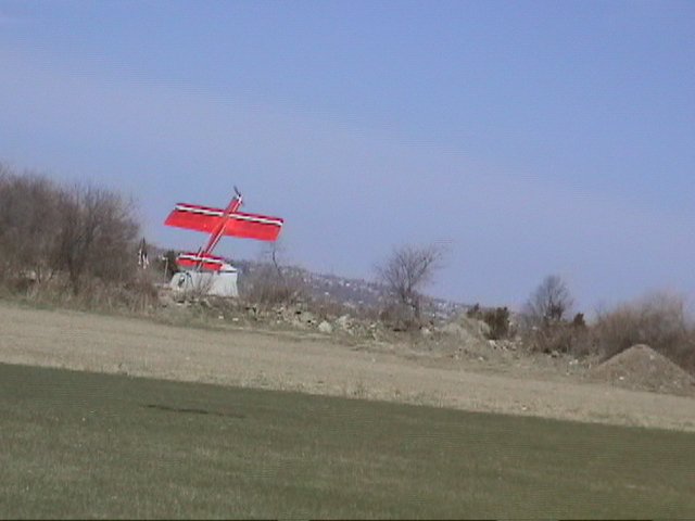

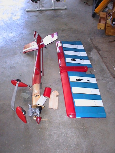

I was having a lot of fun flying my ME on field day, stepped into a little rut and took my eyes off the plane for a second.
When I looked up, it was coming towards me and the pits (full of people), so I cut the power and yanked the stick back.
Of course, it was inverted and that's all she wrote.
The fuse would be too much work to repair (for me anyways), but the wing could be back in shape in a few hours.
The right side LE peg was pushed back an inch.
I took the gear out and put it on a QHOR Spad and found out it's a lot more fun to fly!

Originally posted by rlt55
Moral: Don't fly 3D is your engine is not runnig good! Low, inverted, engine cough, pull full up,.. and it pancaked the field, just missing the high grass (of course). The landing gear literally tore the nose off the plane when it hit. A winter project.

I like the airplane except for the thin weak fuselage. A hard landing tore the front end off. I repaired it and reinforced it with plywood. The next hard landing broke the fuselage. I have made harder landings with other planes with no damage.
