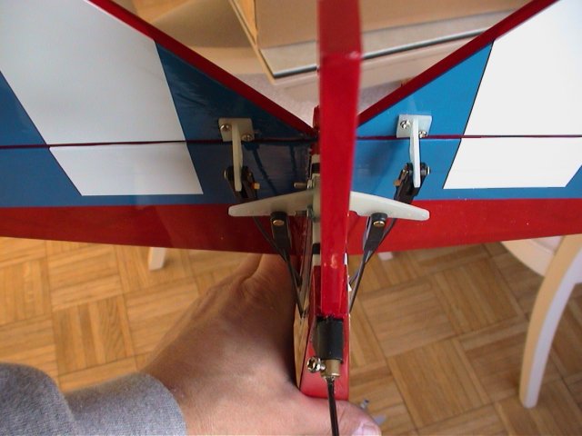

Sure! If done right (right gauge wire, epoxied correctly, etc...), you could easily use one pushrod (w/ minimal weight savings I would think). As for myself, I always like redundancies. If one clevis or horn gives out, you still have the other clevis/horn on the other elevator half. Now, if the servo or main pushrod gives way, you are in deep trouble in either case. With a solid pushrod pull-pull configuration, the MagicExtra in turn gives you similar redundancies (dual pushrods, dual clevises). With a "wired" pull-pull, you would not have this redundancy that would allow you to still fly if a rudder's clevis or pushrod went out on you during a flight. Granted, wired pull-pull is lighter by all means!
One note on attaching elevator halves,... cut the joining wire (pref, 2-56 on smaller models, 4-40 on larger) such that the ends go into the elevator half at least 1 inch (the more, the merrier). Now the key,.. when you attached the control horn, try to position the horn so that the horn's screws surround the embbeded wire in the elevator halves. Basically, you want to position the horns directly over the embedded wire such the force of the controlling servo is placed upon the embedded wire rather than the thin balsa of the elevator. If using two horns (one for each elevator half), position the horns similarly.

Missing hardware.......no screws for all the control horns except the rudder horns. AND...the rudder horns are shown with four bolts/holes, mine have two each. Anyone else?
With the quality of some of the ARF hardware,.. it's probably a good thing they left it out !

Ya, I'll probably go buy new stuff, no more than it costs. ZFrom your picture, it looks like you have two bolts holding your rudder horns together? And do ALL of your other horns bolt through to a backing plate, as opposed to wood screws merely into the balsa?

One more thing.....those are good looking clevises. You wouldn't have the part number for those would you? Did they thread right one to the supplied control rods?

Actually, after looking at the pic, I think these are the stock horns that came with the kit (square bases). Clevises are obviously new Dubro type. The elevator horns only have two screws each, and both include a backing plate. The rudder horns are simply placed back to back, then screwed together (sandwiching rudder) using nuts/bolts (only 2 as shown in pic). Wood screws into balsa? Yikes! This only works on larger models where the surfaces are thick and a bit "harder". You need enough balsa to screw into (which the ME has very little of). The Dave Patrick Extra300L I'm building wants you to mount the included Sullivan horns using wood screws (of course, they mention to drill holes, them apply CA to stiffen them,.. them you screw the horns on). Since I do not like this method, I opted to use Robart H/W that "bolts" through the surfaces. A little heavier but a little safer in my book.
Yup! Threads right on 2-56 threaded rod (Dubro also sell 4-40 versions too which I use readily). They are Dubro Safety Lock Kwik Link 2-56 (Part# DUB815). Check out:
