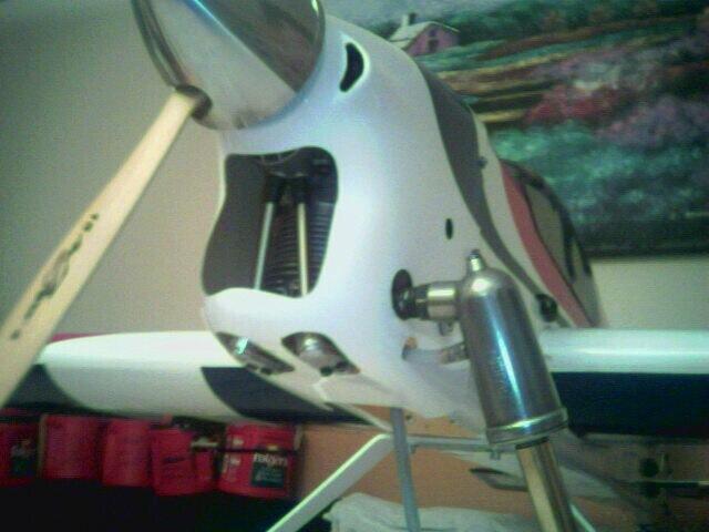

Have a Saito 100 in U Can Do, it flies great but when I do hovering for more
than 30 to 45 seconds I lose engine power to the point that I have to stop
hovering or I won't have enough power to pull out anymore. I think the
engine is getting too warm, I have richened the high speed needle and will
open the cowl more although it is fairly open, just wondering if this is a
normal problem?
I am using exhaust pressure and a 15 X 4 prop. and 15% nitro fuel, the plane
will climb out of sight if the throttle is open I only lose power in hover after a short while
but I would like to be able to hover for a longer period of time.
Has anyone else run into this problem?

I have a UCD60 with that engine. I really like it. It doesn't overheat and it will hover nicely. I use 30% fuel, that will make the engine run cooler. Also, I'll bet you don't have enough airflow through your cowl. That is the problem with most. Attached is a picture of how I do mine. Open up the cowl and your problems will be over, I'll bet.

You could try running it without a cowl to see if the problem disappears. It would at least tell you it was heat-related. Can't see your cowl, but the exit opening must be at leat 2x the size of the input. Most people overdo the intake opening. I knew a guy that just put his engine upright and put it thru the cowl-no heat problems there!

i agree with barry, i have a 60 and 46 size and you have to open up the bottom of the cowl(i would take at LEAST half of the bottom out) and more wont hurt and open up the front as muck as possible. and i also agree w/Barry on the coolpower 30, i just cant afford it, thats half the reason i put my 100 in the 46 and it runs great on 15% now ive removed even more of the bottom since this pic getting ready for summer, it was 105 yesterday and i flew with no heating probs.

I have the Saito in a Fliton Extra 330 (AWESOME!!!) but before that the engine was in a Funtana40. I had constant issues with it in the Funtana. When I switched everything over to the Fliton I went the route of a Perry pump and a straight pipe. It was the best decision I ever made as the engine runs without a hicup from full tank to empty. Basicly any possibility of the engine leaning out as the tank runs out is eliminated.
I also agree with the cowl issue. I think the rule of thumb is the exit should be twice the size of the opening. And I don't think the opening of a UCD is big enough to start with.
Another thing I also suggest is changing props. I have never had great success with any of these ultra low pitch wide props and I have tried several on several different motor applications. I find that when you throttle out of a hover you just don't have enough punch. I am running a APC 15x6 and my Fliton weighs 6lbs 6oz and I am hovering less than half throttle and when I punch it it is ballistic! I really think the higher pitch will make a world of difference and if your plane weighs about the same the engine can definately handle the extra load.
