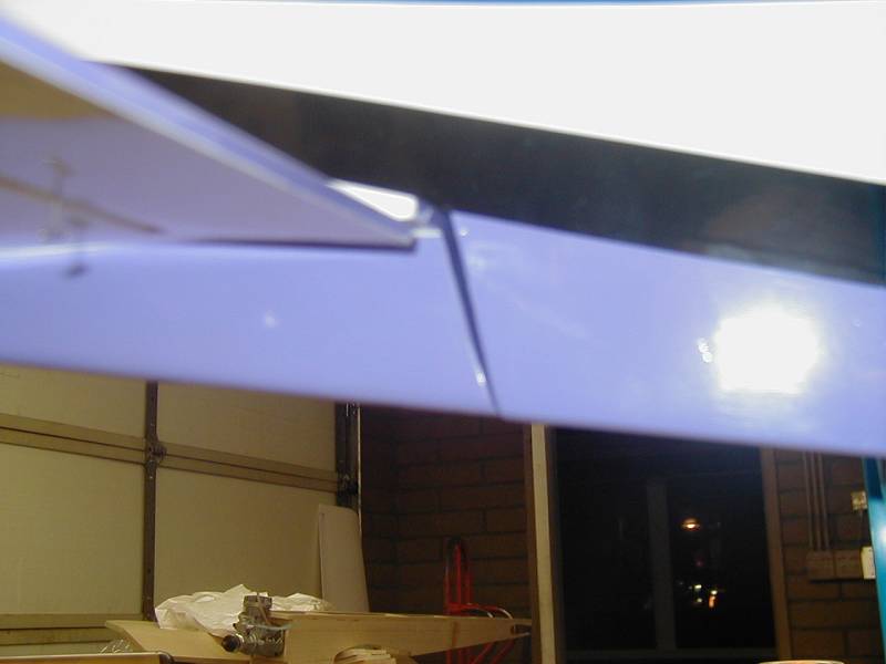

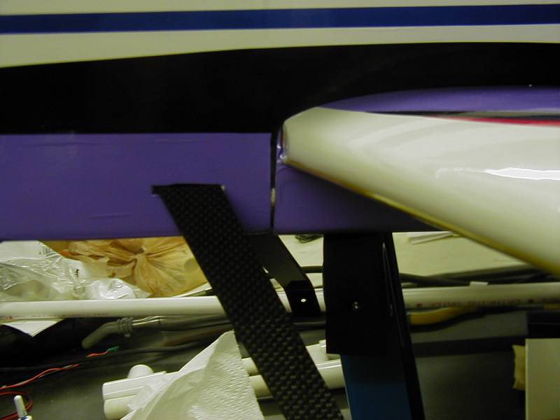

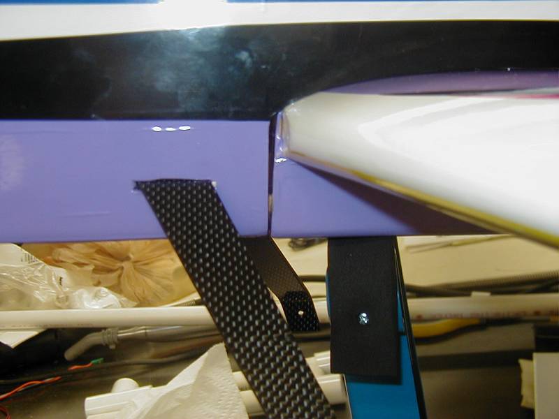

Well, I'm still here and pissed as #$!!.
I got my Quest from Nitro and it really looked great! I couldn't believe it. Should have known it was too good to be true.
I started assembling and when it came time to mount the wing I got the shock of my life! I've never before seen such a terrible fit! I maintained my cool though and contacted them. I also sent pictures, and they offered to refund my $99.99. Great you say, not really. They would not refund the original $31 for shipping, and they would not pay for the $31 to ship it back! So,,,I'm out $62 and don't even have a plane BUYER BEWARE!
(Incidentally, this IS with the alignment dowl and hold down screws installed).

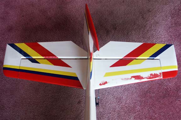

I have the Quest 90 and I have problems with the trim coming off and leaving a gritty residue. Apparently the trim is glued on and you can't fix it by ironing it down. I haven't had any trouble with the underlying white covering so maybe I'll just let all the trim blow away until the plane turns completely white.
Joined: Mar 2005
Posts: 254
From: Tucson,
AZ
The 50 some kind of stick on clear covering, I've heard of it, but never seen it before. It did start to peal as I worked on this turd.
I also had a world models Spot On 120, probably the best pattern plane for the $ I've ever seen. But the covering sucks, and they know it, but have done nothing. I let it all just strip off until it was all white and did my own trim. It's a shame they build a great plane like that and then use such cheap covering. I know it's cost, but it can't be that much of a savings to them. I'd buy another if not for the covering issues on World, and I'll NEVER trust ANYTHING from Nitro!
