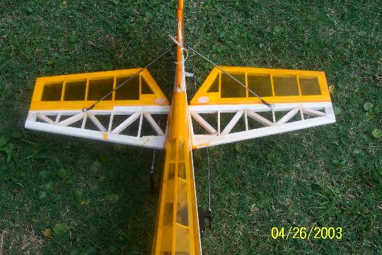

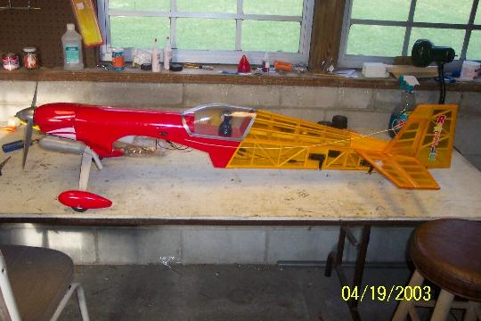

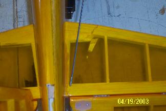

Old 04-19-2003 | 07:36 PM
  #106
My Feedback: (11)
Posts: 203
From: Yulee, FL
Default Razzle 3D
Flew my razzle again today. Just doing some basic rolls and snaps. Had my right h.stab snap on me and the vert.stap snap off as well. Amazingly I got it back to the ground with no damage. In fact it was a great landing, just a little ways from the runway. I will post picks tonight. A lot of people have told me some good ways to reinforce it at the field. I am going to drill a hole in the vert stab, slide a 5-56 rod in and throw a lot of 30 min epoxy on her. Going to put some ply triangle blocks on the hor.stab and iron some carbon strips on the leading and trailing edges. Hope this works, will post pics when I am done.

Old 04-20-2003 | 10:54 PM
  #111
My Feedback: (11)
Posts: 203
From: Yulee, FL
Default Razzle 3D
damage...

Old 04-21-2003 | 01:35 AM
  #114
My Feedback: (14)
Posts: 2,460
From: MT Vernon, WA
Default Razzle 3D
Send those pictures to Sean in product support at Horizon hobby and he will get you a new fuse, and tail group.
Both of the stabs that I broke were in the exact same place as yours.
Bummer, great flyer though...

Old 04-23-2003 | 10:55 PM
  #120
Posts: 194
From: Lake City Fl
Default agent orange
Hi fellow Razzle Pilots
I just finished reading the posts on the razzle. I have had mine since Jan and have flown it 5 times, each flight had structural problems. At no time did I over throttle it. The wood is so soft that you can flatten with your fingers. Slow flight aerobatics are fun. Neat plane. But I am afraid it is made from balsa affected by Agent orange. A little Viet Namese revenge? Could Be!!!
Old 04-26-2003 | 06:54 PM
  #121
My Feedback: (11)
Posts: 203
From: Yulee, FL
Default Razzle 3D
Reinforced my tail area. I put in 1/4x1/4 bass cross bracing.4-40 flying wires. There is much more strength in the horizontal stab now. Doesnt flex anymore. I am going to monokote the stab red.

Old 04-26-2003 | 08:13 PM
  #123
My Feedback: (14)
Posts: 2,460
From: MT Vernon, WA
Default Razzle 3D
Nice job, that ought to do it.
