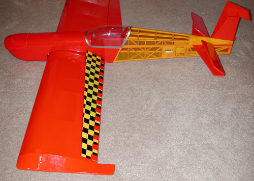

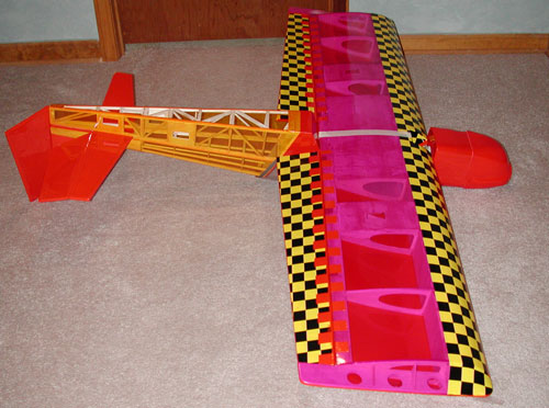

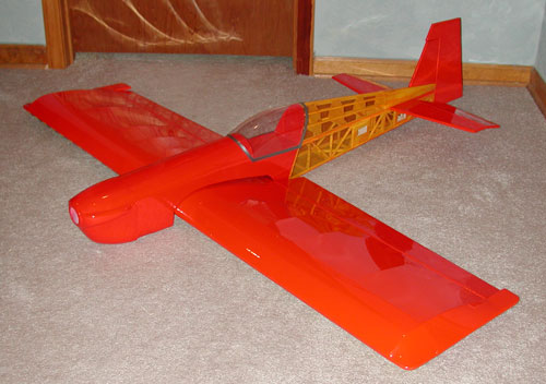

The Razzle is my first arf. I have followed this thread for a while, and have read the posts about poor construction and grade of wood. I thought that people were just being picky, but it looks like the hit the nail on the head. I have never seen wood as bad as what is in the empennage of this plane. The lack of glue shocked me, joints broken or breaking with the slightest touch. The shear web grain is running span wise, it may as well not even be in there. Replacing it would be easier if they left it out. I removed the covering from every part to allow me access to re-glue everything. I reinforced all of the tail feathers with carbon fiber. Replaced the shear webbing in the wing. The wing appears to be built pretty good except for the web thing. Finally I hinged all of the control surface with monokote hinges. I find it strange that a company would go to the lengths to produce very nice mitered wood joints and then not use enough glue to hold it together. Hopefully it fly’s nice. Here are some pic of the mods I made. Are all ARFs this way? Just my .02

Nice pics and very nice covering to differentiate up from down...
I have to disagree with your assessment of the quality of the wing, however. Many wings do not need the shear webs going the "proper" way you describe, the H-9 Edge is just one for example.
Todays wings have been designed so that allot of structural integrity comes from the covering. I would rather have the mfg consider this and build me as light of a wing as possible than go overboard and heavily glue/reinforce each joint. I would rather make a simple repair on a busted clean joint after a cartwheel or similar accident than to cutout and remove structure that has been "beefed".
Furthermore, we the modeling consumers have been screaming build it lighter and the ever so popular lighter flys better so loud and long that the Mfg's are finally giving us what we want.
I have learned that it is better to build a plane that flys great/lighter rather than holds up well to crashes, (trainers excepted).
I have flown my Razzle so hard and tumbled it so violently that I was able to expose the one real defect in manufacturing, and that's the horiz stab. The balsa on the TE and LE is just too light for that application. Agreed the tail feathers do not have "alot" of glue and that suites me OK, as I'm sure the majority of strength is coming from the covering.
If given the choice by flyers who demand performance over "crash survivability" I'd bet a dollar to a donut that to a man, we would vote build it lighter, not stronger. Sure both are preferable, but we're not in a perfect world either. I can't tell you how exited I am that we are finally getting the planes that we have been pleading for the last couple of years..true 3D capable, fat wing, cool fuse, fiberglass parts, CapExtraEdge tail-feathers, slow flying, non tip-stalling, hover monster, NON profile type plane...
Disclaimer Not that profiles are bad...I have owned at least 5 or 6 of them, (still do) I just wanted something different.
You made the decision to recover and beef up your plane, and you did a fine job. I hope that there is no trade off in performance.
I do really like the difference in top/bottom, and on my left over wing I intend to do something radically different...perhaps a waving flag....
I look foreword to your flight test report.
No offense meant or implied by disagreeing with you.
Good luck

Joined: Mar 2003
Posts: 14
From: Gardner, KS
Hi Mike,
The problem I found with the wing was the direction of the grain of the shear webbing, not its quality or size. The job of the shear webbing is to keep the two spars from deflecting in toward each other while under load. The farther the two spars are apart the stronger the wing will be. I did not beef mine up rather I removed the old webbing and replaced it with the same size web with the grain running perpendicular to the spars. Covering will not help here. The manufacturer is probably doing this to cut costs. I cant agree more with you about keeping the airframes light, it is my opinion that airplanes should made to fly not to survive a crash. However the airframe should not be failing due to aerodynamic loading no matter how hard you are flying the plane, this is a safety issue. The way I see it all of the extra weight I added to the airframe, mostly just much needed CA and a small amount of carbon fiber, does not equal the weight of the the goofy looking pilot I removed from the plane, therefore I am lighter than stock.
I cant wait to get it out and fly it!
