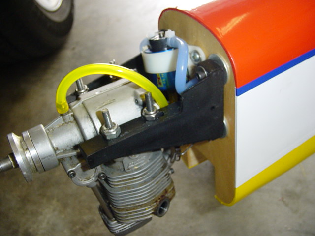

My Feedback: (31)
richng

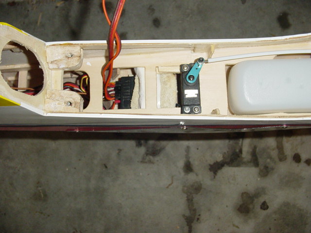

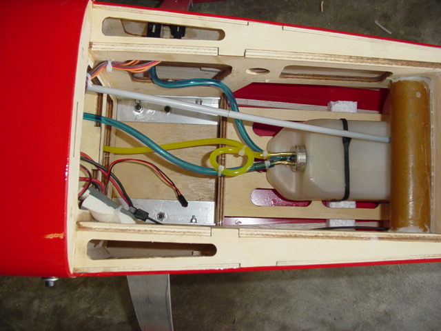

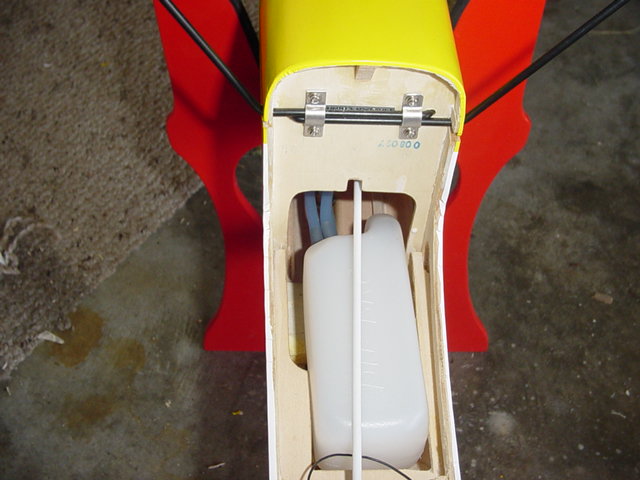

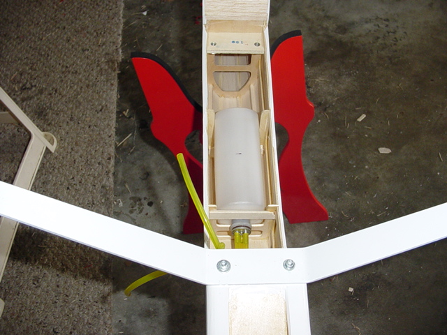

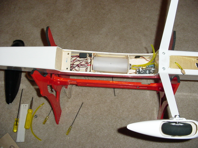

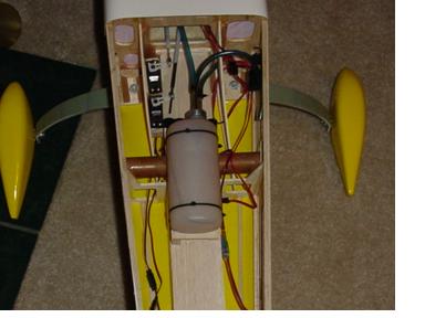

you are correct that i mean the tank is in the center range of the CG. YS or glow motors that are able to pull glow fuel from a distance. A vp-20 or Vp-30 is a pump used on glow motor 2 or 4 Strokes so that you can acheive the pump action with the glow fuel. This enable me to run all of my planes tank on the CG and not worring about starvation issues. here are a few pics of a pump and such.
Here is a link to read up on the vp pumps for now pumped glow motors:
http://www.perrypumps.com/prod02.htm
this pump is not requried for a gas engine or YS glow engine
The addition of fuel has a big effect on the cg on most model planes. A typical profile 40 size 3d plane weighs 50 ozs, has the center of the tank about 10" fwd of the cg and carries 8 ozs of fuel. For this example, when the tank is full the cg is about 1.5" fwd of the position when the tank is empty. There is nothing you can do about it short of moving the tank closer to the cg. I am surprized the planes fly as well as they do both full and empty. We set the cg so that the plane is not uncontrollable empty.

Hi krayzc-RCU,
Thanks for your info, pictures and link. It certainly helps me to understand alot better what it really takes to virtually stop the CG from unintentional changes on the fly. The only thing is, it'll require times to modify the fuse in order to move the tank - quite a fair bit of work. Thanks again.
Hi Jack Hyde,
If I understand correctly, if the model is balanced with empty tank initially on the ground, then towards landing period with almost an empty tank, the model should still be flying very nicely. When the tank is full during take off and subsequent flying around nose heavy, the model will be stable. It is only when things like hovering are done, that the CG is likely to become sensitive.
