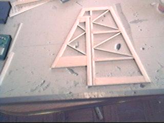

just finished the rudder today.

Default 300s for 3d work
Don't forget to put some sites in that structure for some flying wires. These flat-stabs do need them, I lost a real nice GP Extra due to stab flutter, it was real nice and well built, but that one thing did it in. The one I have right now is a clone, except for c/f built into the span of rear-stab, and flying wires. I wrench that plane around too, no prob, except for a broken flying wire one time.
Also, someone did say the .40size is nearly as big as the .60...I can attest to that fact. At 15ft apart you can't tell the size diff at all. In the air I'd say it impossible, although once you see the subtle differences they are easily ID'd, but for the most part, there is no drastic difference at all. I'd have to think I'd put a YS120 in the .60 size. At least a YS.91

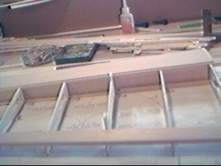

got some pics of the wing. I wish i had a scale. these are really light.
Old 11-27-2002 | 01:59 PM
  #33
Posts: 1,070
From: sterling hts, MI
if you look real close you can see the 1/4 x 1/8 spruce spar and double spar at the root.

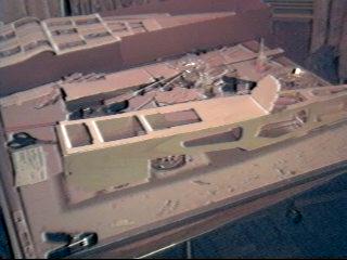

Heres the stock fuse befor i butcher it.
Old 12-01-2002 | 05:54 AM
  #35
Posts: 1,070

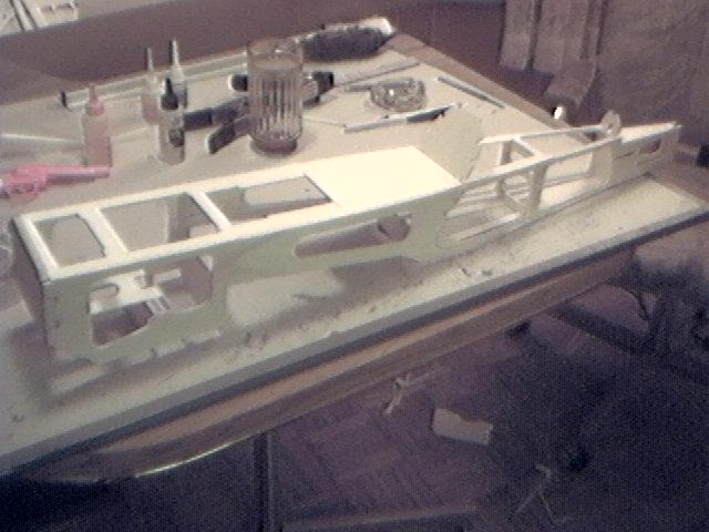

mods to fuse
Old 12-01-2002 | 05:56 AM
  #36
Posts: 1,070
ooops wrong pic. heres the right one
