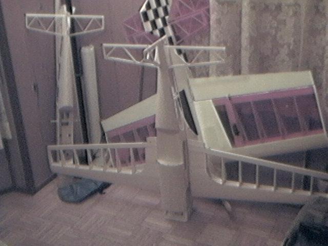

Well just got the decks done. What a pain. It wouldnt be too bad if i did it like the book but you know me. hehe. Cant leave nothing stock. Heres some pics.

Looking good. If you think the decks were tough here you should build the MW Extra and attempt the forward deck. Man that is a pain. Even with windex sprayed all over the sheeting it is nearly impossible to get the ply to curve around a 5/16 radius and look good.

well the kit use's stringers and balsa sheeting. well somhow i manged to sheet it with 1/16 instead of 3/32 and didnt use the stringers. If i used the stringers it would have been a no brainer. Its just a little harder to get the seams right thats all.
Ply for the deck?? that must be a big plane.

27%. 1/32 ply is nice because it doesn't dent like Balsa does. Also rigid enough to not need stringers on the rear deck and still be very strong. Important when running a 52cc gasser.

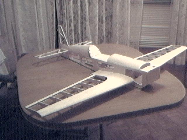

heres a little better shot of the tail on it.

Sorry about the pics being fuzzy it just a web cam.

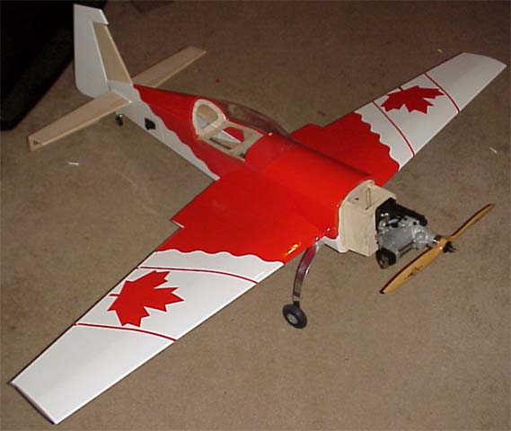

This is my latest project. It is the GP Extra 300 (60 size). I am powering it with and OS 120. My goal is not a 3D machine but a nice IMAC type aircraft. I am hoping that by going with the OS 1.20 I will get truly unlimited performance. I built it mostly stock other that increased sizes of the Elevator halves and Rudder. This is a picture before I Covered the tail. If I have time tommorow I will take a new picture of the plane with the tail covered and the cowl mounted.
Good Luck with your plane, looks great.
Phil (Mesa, AZ)
By the way, I have the GP Cap 232 and if you are looking for a great flying plane that builds very light you should look into that model. Mine is 5.5 WET with an OS 70 up front and stock servo locations with NO Lead.
Oh yea, before you ask about the Maple leaves here is the reason they are on the plane. http://www.fightercombat.com/airshow/Photos.htm I saw them at an airshow and liked there planes and flying style. Plane presents well in the air.

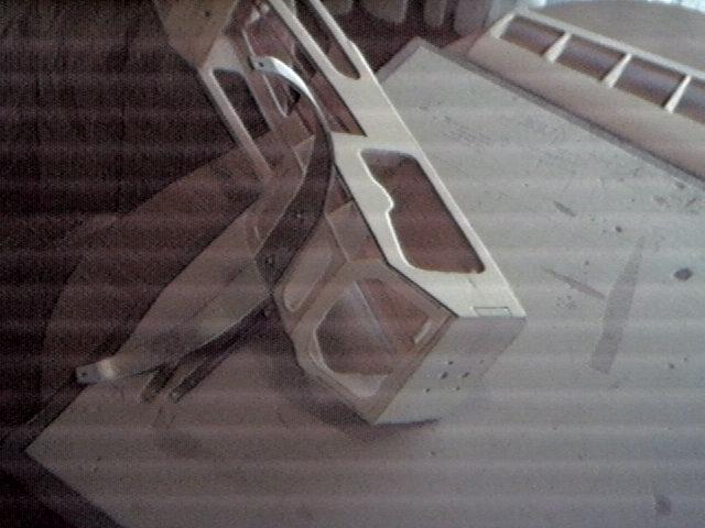

sundevilpilot....I forgot some cut outs. I think im done cuting the fuse....finally. Not much left to cut. hehehe. Heres some pics of the cut outs.

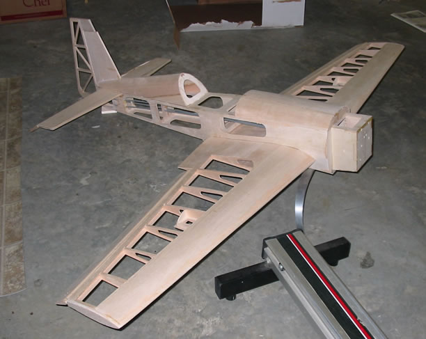

Did a little more work today. This thing is really gonna be light. I compare the fuse of the 300 to the fuse of my sig se. The se is 5lbs ready to go. The fuse on the 300 felt a lot heavyer then the se. It should, its made of ply and its twice as big. Well after i cut the nose and the cockpit out it feels real close. Well heres the bottom. This was the project for today.
