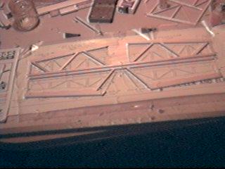

Well i got my kit today. Dug through it and checked it out. Like i said before i want a 540 so i looked at the wing to see what it would take to get a strait leading edge. Well.............I think i need to make new ribs. I started too and i got 2 done and i noticed that the two i just made wieghed atleast half of what the one kit rib wieghed. I can take soooo much wieght out of this thing its silly. and thats just the wing!!!!!
I looked at the fuse and it may need a little more thought to convert than the wing. I am replancing the ply sides and bottom with balsa. I cant believe they used ply for the under belly. The plane is built to crash not fly. Every thing is soooo over built.
It will be a little weaker but I dont think i can break it in the air and thats all im worred about. Let me know if you guys want to see some pics of construction. Im sure i can post some here when i get some work done on it.

I checked it out and it seens fine. but im allso looking at it like a 540 with the wing on the top of the box. I got a piece of 1/8 balsa and cut out a fuse side. the stock ply side is only a little heaver. NO BAD. The only problem im having is the cowl. no matter what i do it wont look like a 540. I check on cutting the canopy shorter and it looks close.
I will do a little more thinking in the 540 but its starting to look like its going to be a real lite 300

Heres the stab and elevator.

I got a better picture of the elevator. 90 deg of throw possible but will start at 40 for 3D. Also moved hinge line up 1/2 inch and added 1 inch to elevator.
