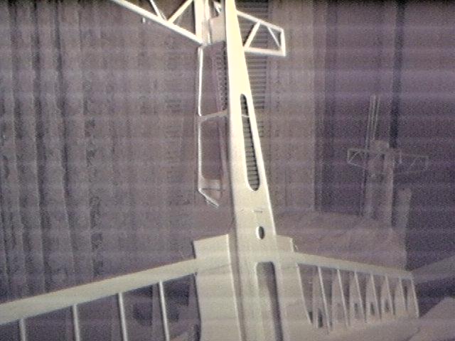

And one more.

Seems like you are really an rc addict !!
I imagine the dust in your workshop LOL.

You said earlier in your posts that this airframe is way overbuilt. That is true but you are making holes everywhere !! Don't you think it could be time to stop lightening a bit ??? Just a question.

LOL......Ya im done cutting. I did what i wanted to do. Its light but not to weak. I hope!

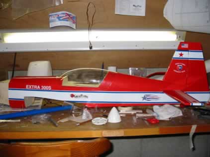

Well i got a dig cam for x-mas. hehehehe.
Ok last pics your gonna get untill its coverd.
The first one is of a stock built 300s.

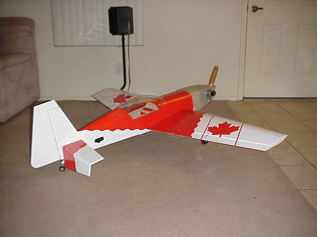

And now for my 300sx.

I just got mine today... from you know who , and there was a product update in it. I'm not sure how long this has been in effect, but it said that GP has replaced their spars from balsa? to hardwood. I won't be working on it for a while though.
da king: First off, nice pics... Second, when I compare your 300sx to the stock pic it looks like you just extended the rudder and elevator, when I compared Did you shorten/lengthen/move the stab and fin, or did you just extend it? I hope your 300sx turns out well!

Old 12-26-2002 | 01:40 PM
  #111
Posts: 1,070
From: sterling hts, MI
Default 300s for 3d work
somone 11.....I move the trailing edge of the fin and stab a 1/2 inch to shorten them. I doubled the rudder and add a inch to the elevator. When i mounted it i put the stab in the stock place and just butted the fin againt the back of the fuse. Thats why the fin looks like it sits behind the stab.
I didnt see anything about the spruce spars but yes my kit had them. I changed mine to 1/4 x 1/8 spruce and doubled it up in the first 3 ribs. Plus i made my own ribs. Yes sounds like a lot of work but two or three of the ribs i cut wieght as much as one of the kit ribs. Saved a ton of wieght in the wing.
Or you could use some real lite balsa for the spars and glue some carbon to it. Light and strong.
I thought about replacing the ply fuse with balsa but it was to hard to find 48" 1/8 balsa.
OK...Hope this helps.

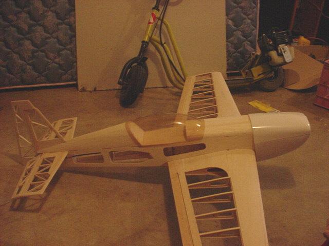

Updated Pic. Covering on fuse nearly complete, wing to follow.

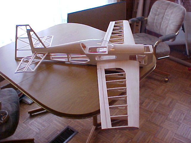

here ya go

Particleman:
Thanks for the picture. The reason I asked was because I have seen the straight landing gears and bent also. Is it more comfortable to land with the bent landing gear (ie, less bounce )
About the landing gear, I use the stock landing gear (ie bent) and found it very adequate. Almost no tendency to bounce, and when you slam the plane the landing gear takes the hit, the airframe remains undamaged, at worse you need to straighten the landing gear, no big deal.
Now that I have moved the CG aft though, I find it tends to bounce more than usual. I will try to flip the landing gear (ie front/rear side) so that the wheels get a bit further aft. That should more or less follow the CG change... we'll see...
Old 01-05-2003 | 05:55 PM
  #122
Posts: 1,070
i think the reson it bounc's now is becuse the plane still wants to fly. try slowing it down a little more be for touch down.
Oh you might not want to flip the gear. It will probily nose over on take off and landing. I put the gear backwards on my cap and i couldnt land without the nose digging in the ground now matter how slow i landed.
Hope this helps
