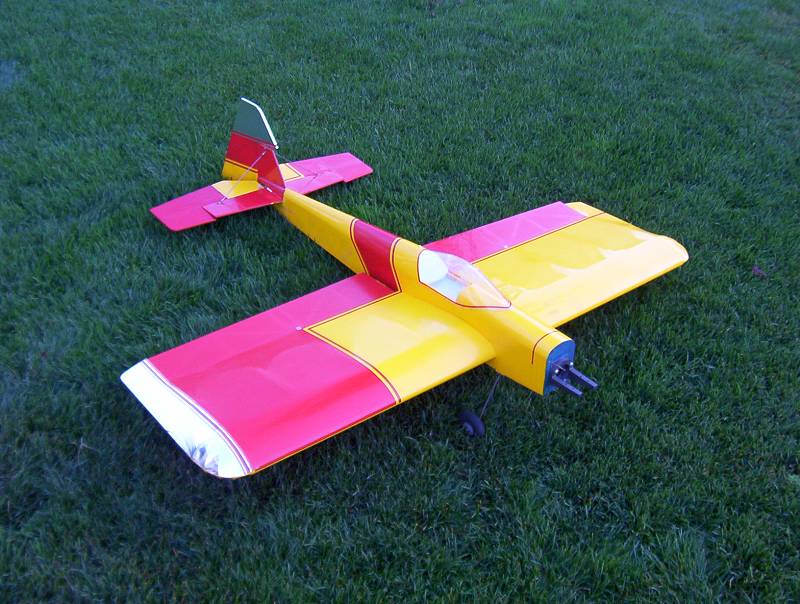

ORIGINAL: pizza
that is still no good - it has to weigh under 5lb all up ready to go minus fuel. did you see that 90 size funtana crash video? it was a nice looking plane but he got board because it weighs 10lb and would only do blenders and fly fast so he crashed it in nicely. if it weighed under 5lb he would quit his job and fly it everyday. don't let this happen to you! if we stop buying cheep 10lb 3d planes then companies will start mass producing light kits from balsa - no lazercut ply. it is proven - my diablotin will fly unlimited imac sequence, fai pattern, every 3d manuver - I even flew it in a pillon race - we need to demand more rather than to settle for less.
This is more rather than less. I picked it up at a local swap meet cheap. Not sure what it is, but it is 6 pounds with the same equipment that would make the F90 9 pounds. Yes, it floats like a feather with about 9XXin of wing area and does fly lower class IMAC nice and 3D's very slow and easy. I like to fly the 10 pound F90 more though.
I think you are crazy if you think you can build from scratch a F90 that is stronger and 40% lighter than the one that H9 puts out in an ARF.

I am pretty sure that is a Laser3d. I have built 2 of them, I got one of mine down to just a shade over 4lbs with the saito .72 and it would fly like it was a feather. Does good 3D but its lacking in the more advanced 3D category.

ORIGINAL: southern_touch9
STG

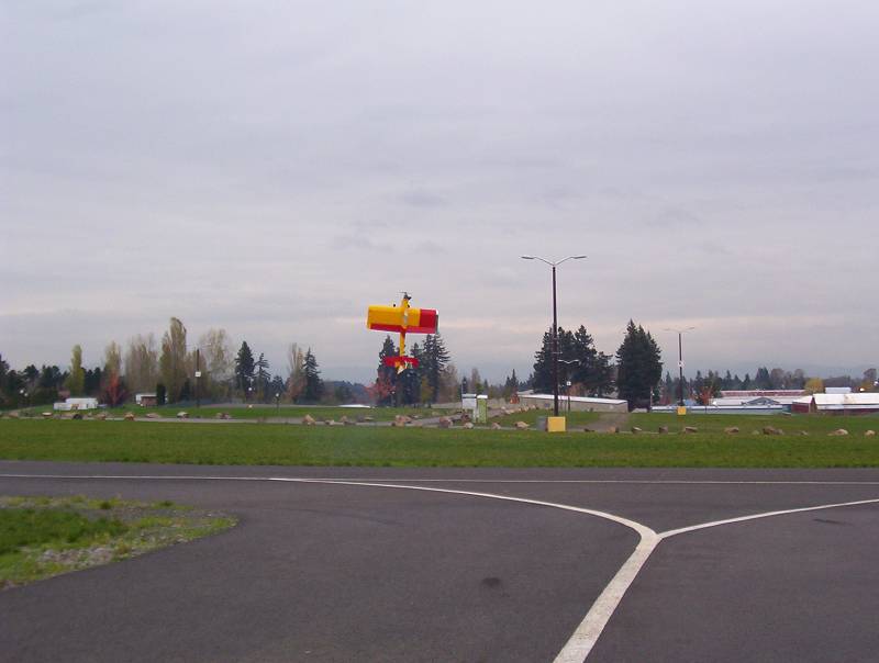

Thanks for the info. I have a ST75 on mine(picked it up cheap on part of a trade). It has pull pull on rudder & elevator. At 6 pounds it does float with over 9XX squares. It is weak on its side--Yes, lacking in the advanced 3D category. Real fun beater plane and 3D learner. This one has seen a lot of low inverted passes and 3D on the deck in bad flying conditions.
Here is a picture of it blasting out.

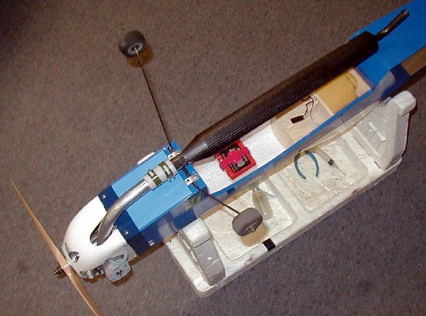

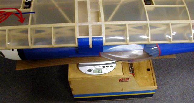

Default RE: its time for 90 size all balsa 3d kits
Fantana 90
wing span 69.5"
length 68.5"
wing area 1107 sq in
weight 8-10 lb
wing loading 16.7 - 20.8 oz/sq ft
Diablotin
wing span 66.25"
length 67.50"
wing area 1096 sq in
weight 3.98 lb
wing loading 8 oz/sq ft

I think the F90 3D's great @ 10.5 pounds with enough power. That Diablotin must float like a feather. ---What are you doing with that heavy battery pack in there? If you are going with ni packs the 2/3 AA or 2/3A will save you some weight.

I use standard size heavy servos, batt, receiver so it will fly nicely in heavy wind. If I used light radio gear it would weigh 3lb instead of 4.

Hey pizza:
Where did you get that pipe? Who sells the Diablotin ?

ORIGINAL: pizza
You are not serous about saving a pound on the radio gear are you?
I can't imagine a plane that size weighing only 4 pounds flying that well in the heavy wind (gusty swirly stuff). Looks like your plane is bigger than my Laser3D at 6 pounds.

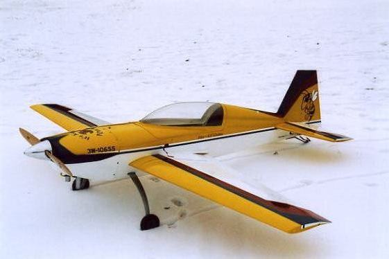

Now this is my idea of a 3D plane
NdFrSpeed

I don't profit in any way from Diablotin or pipe - just flys's better than anything else I have tried to date. I bought 2 from ICARE in Canada and 3 from esprite models - they come in diff color combos for about $275 + ship. the escomposites.com cf pipe is a must have - it weighs much less than stock muffler adds about 20% power, stretches the power band around hover speed, redistributes weight back off front of airplane, has a nice quiet thuddy exhaust note for long hours of hovering next to your ear, and is almost indestructable - will last a lifetime.

Wow ndfrspeed, I like it on cereal, this is what I am looking for but it needs to be 1.55m square and weigh less than 4lb all up with os46. please forward that picture to einstein at www.jr-models.cz this is the only guy that can do it. is that snow or sand you are flyin on? do you know my buddy charlie paska?
