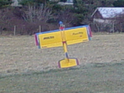

HOLA FRIENDS: WHAT IS THE MORE GOOD % OF FLAP-ELEVATOR MIX FOR TIGHTER LOOPS. MY AIRPLANE IS THE MAGIC.
Old 01-08-2003 | 02:38 PM
flyboone's Avatar
Posts: 551
From: Nashville, TN
Default Hovering The Magic 3D
Just keep working on it, don't give up and you'll get it.

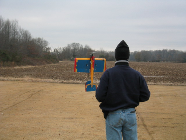

From: Arlington, TN
Default Magic??
Can anyone get there magic to do a waterfall? I can do just about (some what) all the 3-D maneuvers except the waterfall! I hate to have to add more weight to the tail, I already have about 2 oz on the tail. It's has been a great airplane.. RB
