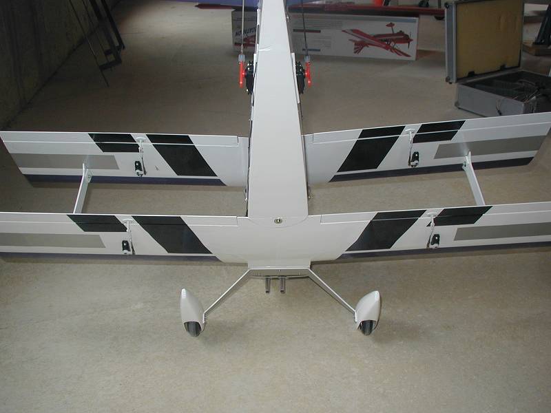

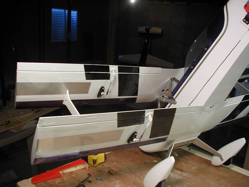

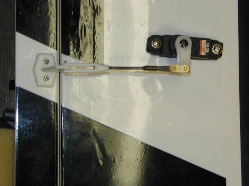

I'm using Hitec 225 with plastic gears on each elevator in a World Models 40 Ultimate Bipe. Working fine.
Also using HS-81 on each aileron of the same plane. The reaosn why they are working is because they are overkill for each surface.
67oz on each elevator in this plane. 45oz on each aileron in this plane. Total overkill.
It's not a 3D plane, but I bang it around without a shred of mercy. Servos are holding up fine, but thats becaue they aren't marginal for the plane. They are overkill.
Any plane with marginal servos is going to suffer from wear and slop quickly. Put a Hitec HS-81 on the ailerons of your slowest flying 40 size trainer--they won't last 3 flights. Too much aileron and too much mass involved. But put 1 on each aileron--like my little bipe--and they work fine.
