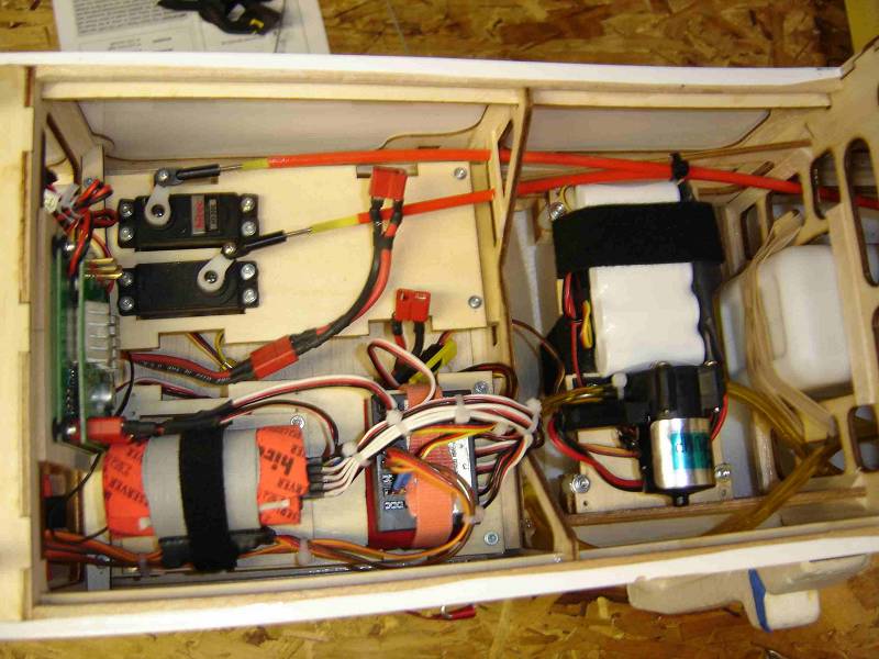

Swerdude,
Just finished balancing mine. On my Cap I am running an Evolution 45GT for power, two (2) ea. 2600 LiIo for radio and servo power regulated with a Smart-Fly Super-Reg feeding a Hitec Fusion receiver and a ElectroDynamics Research EDR-11 Pow'r Bus Pro. My ignition battery (2600 mAh LiIo regulated by a Smart-Fly ignition regulator) is mounted in the engine box, the receiver batteries are mounted behind the fourth former. The receiver and the EDR-111 are mounted in the port tray, and the choke and throttle are located in the starboard tray. Additionally I have a TME smoker pump unit with a 2000 mAh NiMh battery and one 11 oz. fluid tank at the C.G.. I am using only one Hitec HS-5645 MG servo for the rudder, and it's mounted in the rear.
With the addition of .75 oz. to the rudder servo case the plane C.G. balanced perfectly at 5.75 in. from the leading edge at the root.
#624
All up weight is of 15 Lb. 14 oz.. I am waiting for a 2600mAh LiIo to power the smoke pump. That will save me 5 oz. from the dry AUW.
Since the smoke system is modular I can remove it at any time and that will save me around one pound.
